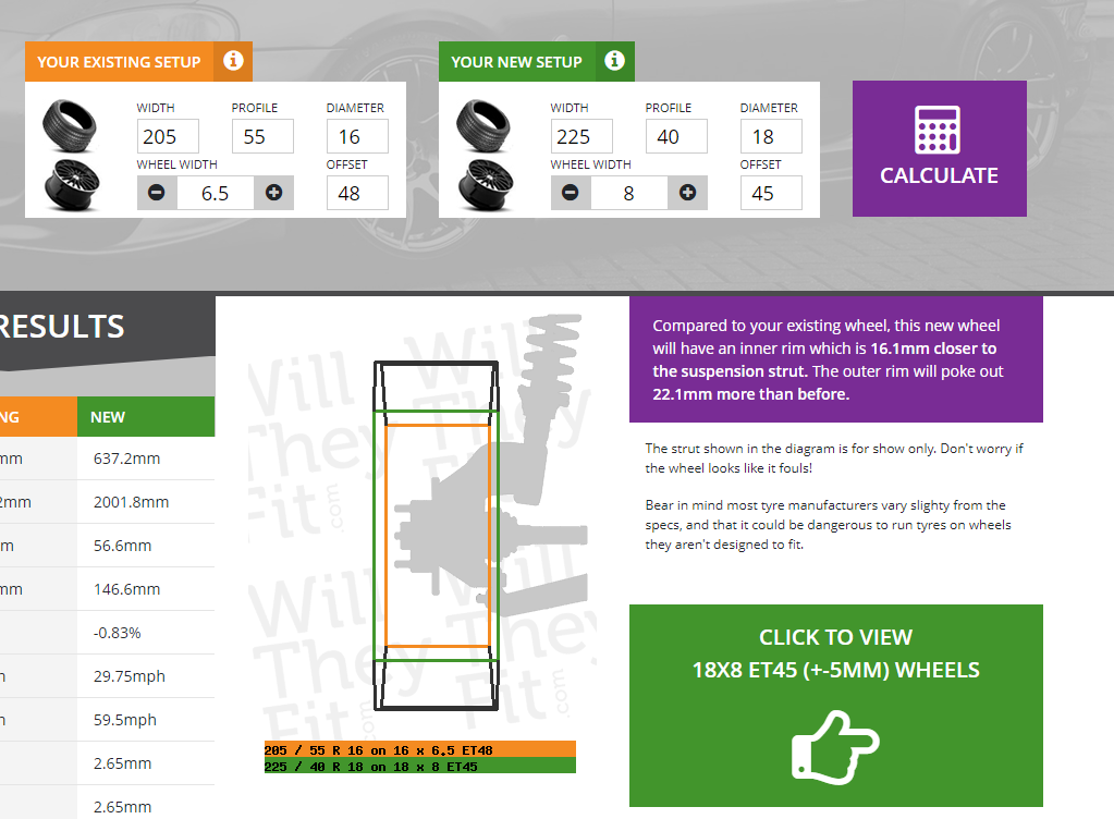

« Reply #82 on: April 30, 2020, 08:47:44 pm »
I haven't found anything remotely like this in this forum. There may be, I'm just not seeing it. So, I'll post it and perhaps the OP can copy and paste in the first post so to be easier to find. I know it is relative to original ride height given it relates to drop, but it is somewhat close regardless.

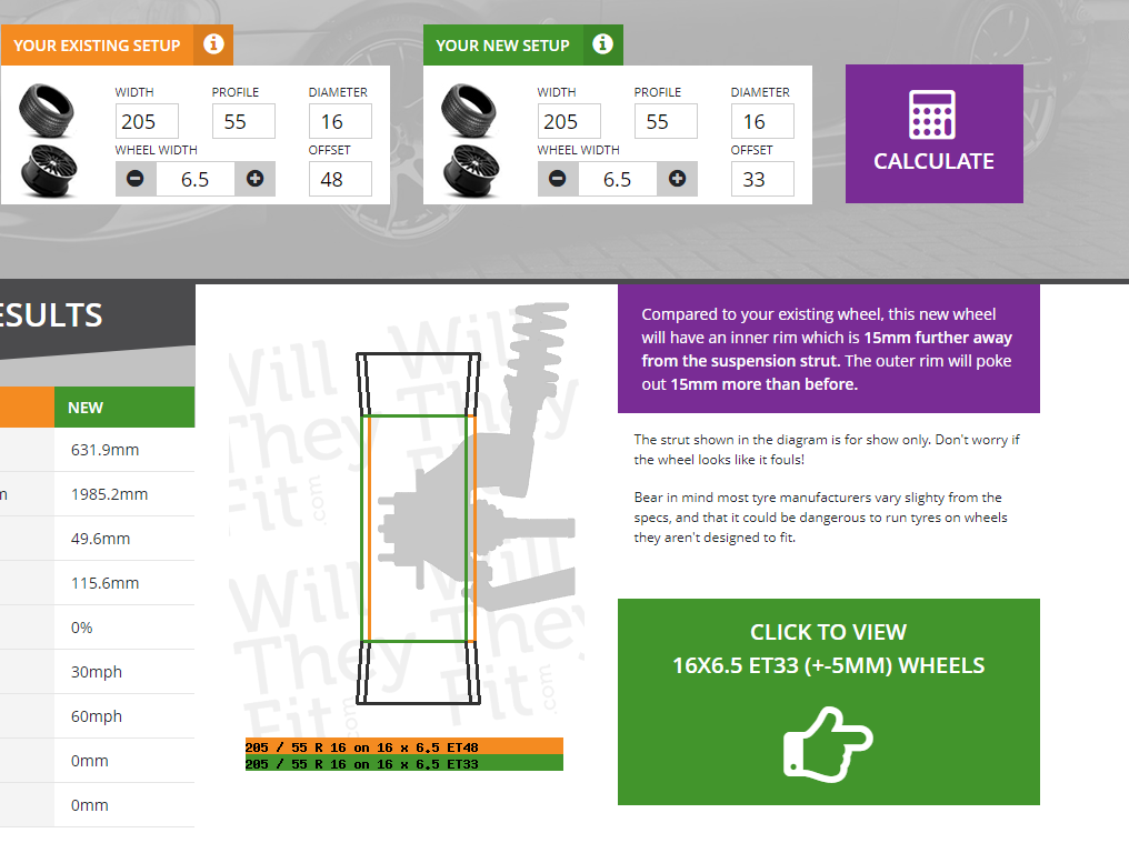

« Reply #84 on: February 08, 2022, 09:58:20 pm »
Hi guys is it too much to put 16" 6.5j et33 on regular  mk 5 (not GTI) or it will look good? I m speculating about that offset. What is the maximum offset for 6.5 16"? Regular is, if im right, about 48.
Tyre is 205/55.
Thanks.
Tyre is 205/55.
Thanks.
Sent from my M2101K6G using Tapatalk
I have 225/40/18 et 45 right now and it sits perfectly in-line with the fender (no rubbing). 6.5 with et 33 should fit without issues and also look better. I have 205/55/16 et 48 on my old one and that sits so far in that it actually looks bad.
