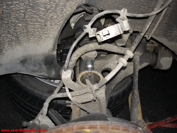

shine a light :scared: thats looks quite tricky!

Done this a few times myself.  Rears are reasonably easy, fronts a little more complicated.
You really want to get that spreader tool as well.  :happy2:

I find the easiest way is to remove the calipers, remove the lower arm, remove the track rod end from the hub, undo the hubnut and withdraw the drive shaft from the hub, leaving the driveshaft in the gearbox.
Remove the entire strut and swap the parts over away from the car.
Stu...

I just googled for a picture and found one from here -
http://www.seat-ibiza-mk4.co.uk/ibiza_front_shock_absorber_change.htm

That would explain why the guys were using a hammer to take off the front shocks connected to the bit prized open by the spreader tool.
I was thinking right then - there must be a better way of doing this... whilst cringing... I did manage to get them use a piece of wood to soften the blows to my car...
