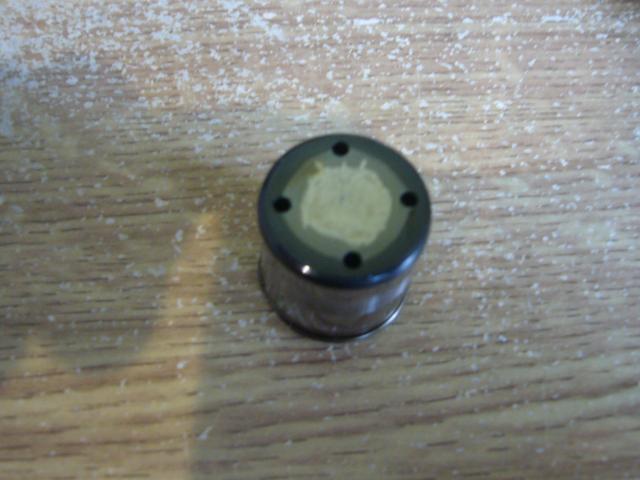

A excellent guide, first job ticked off. Very little wear  with just the top coating removed.  mileage 72k first 50 on long life.

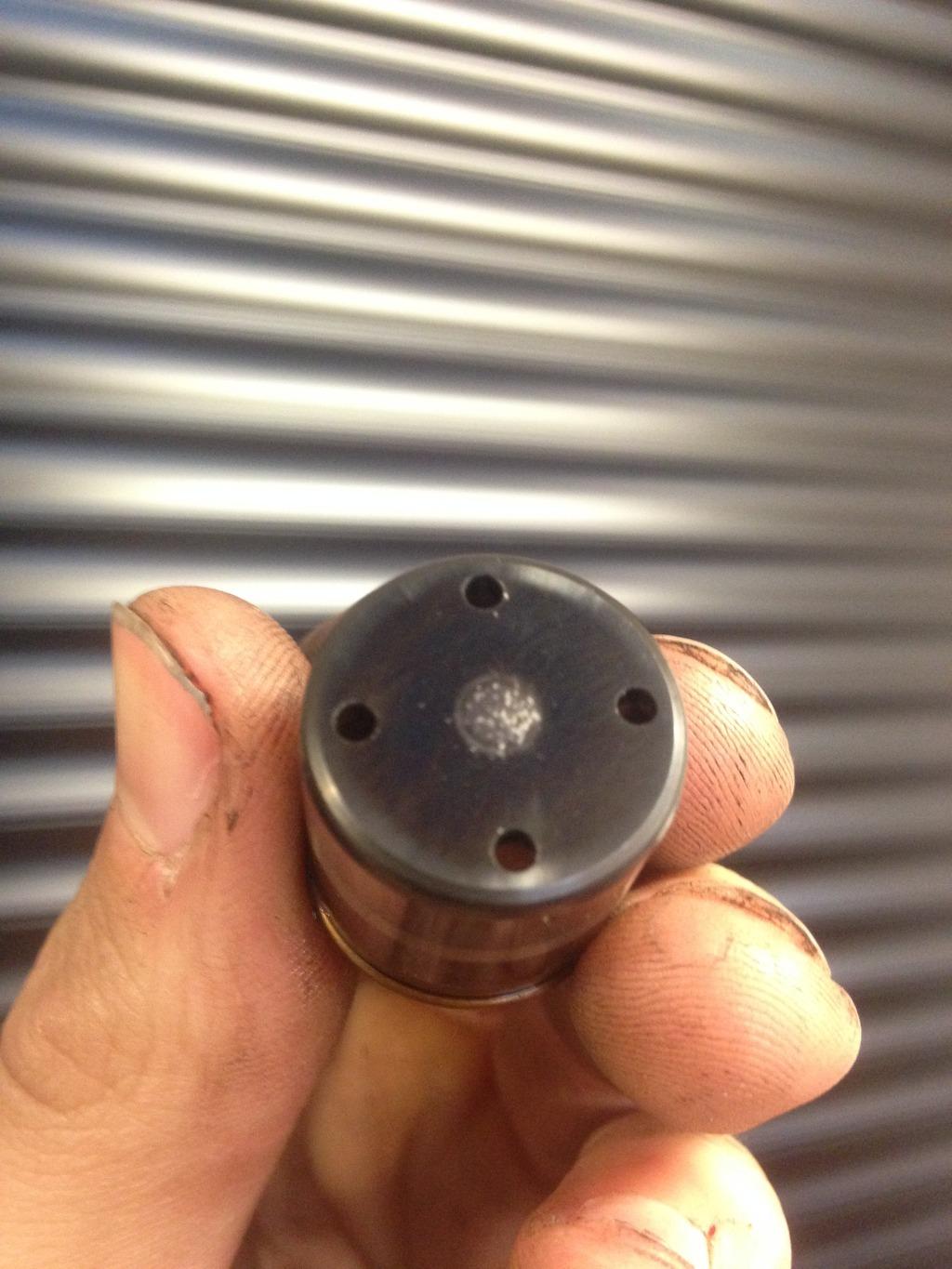

I replaced the cam follower using this 'how to'. Thanks for the help, very clear. Nice easy job, only took 15 minutes.
My cam follower had very little wear but changed anyway. Car is an '07 ED30 with 77k on the clock. I am pretty sure it hasn't been changed prior to this. Quite reassured by the condition as I expected a lot more wear. Car has oil changed ever 5000 miles but has done a fair few track days and driven quite hard when warm.
I'll put some pics up when I get a chance.
