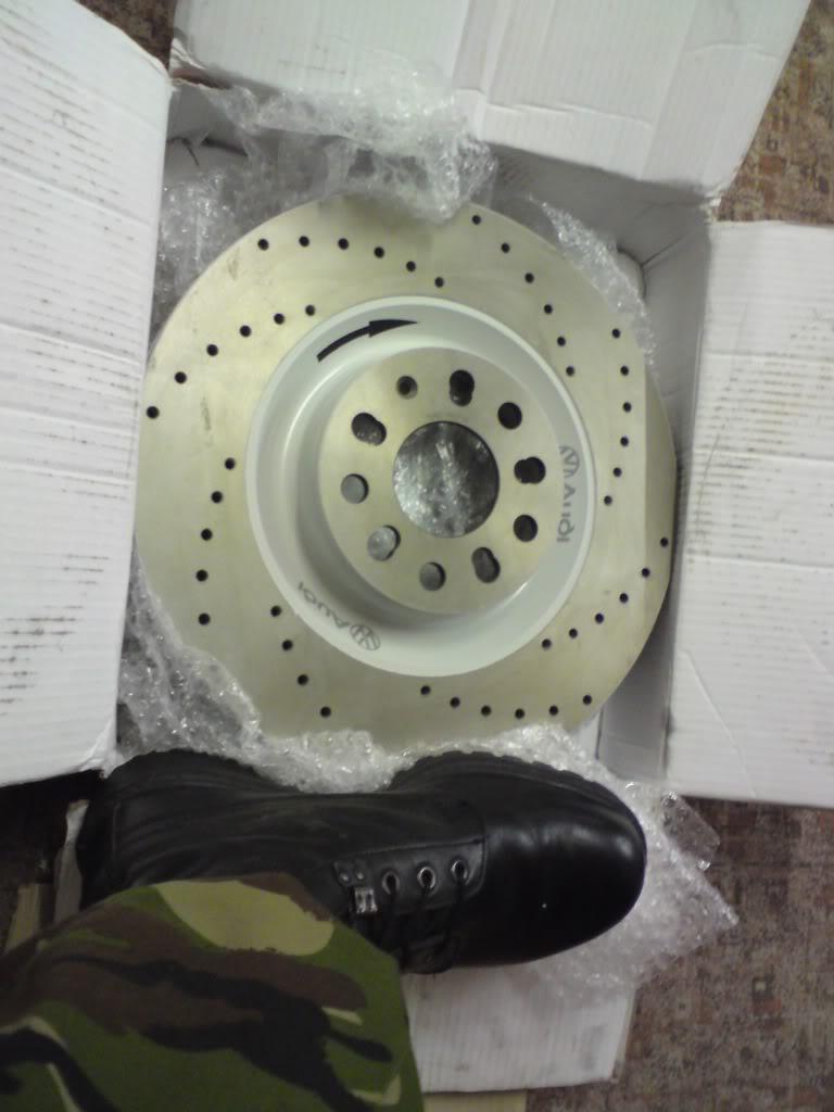

Woo hoo  :party:
Cheers to DaveB for helpful & rapid service!
Pads and braided lines soon then S3 rear set up :D  When the fronts have worn again will be looking for a big brake kit

Drilllled ehh? not worried about cracking? are they 345x 30 to fit stnd calipers?
SpeedStats iPhone app  - AVAILABLE NOW!
View my Cupra k1 project thread here! 360is
Re: Lets talk brakes: Grooved & drilled vs Grooved
« Reply #80 on: November 12, 2009, 09:28:15 pm »
Nope and yup  :happy2:
