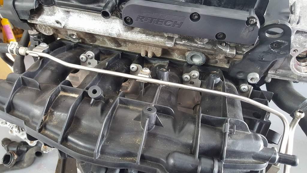

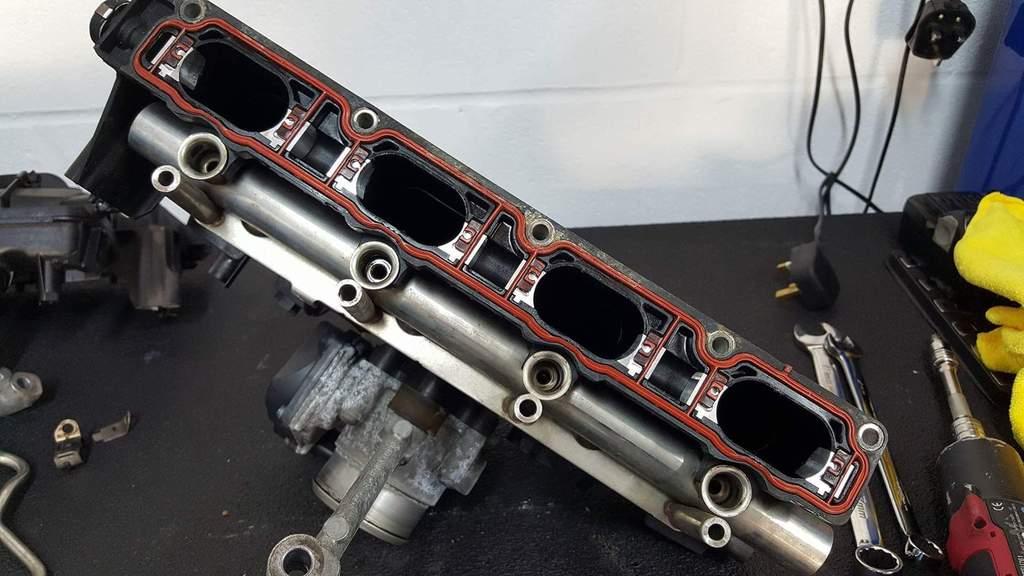

Some things are going on
As you can see it was pretty damn filthy in there, also it was quite gunky instead of the hard dried carbon you usually find.

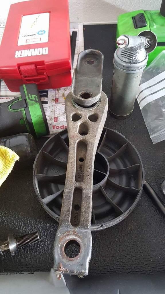

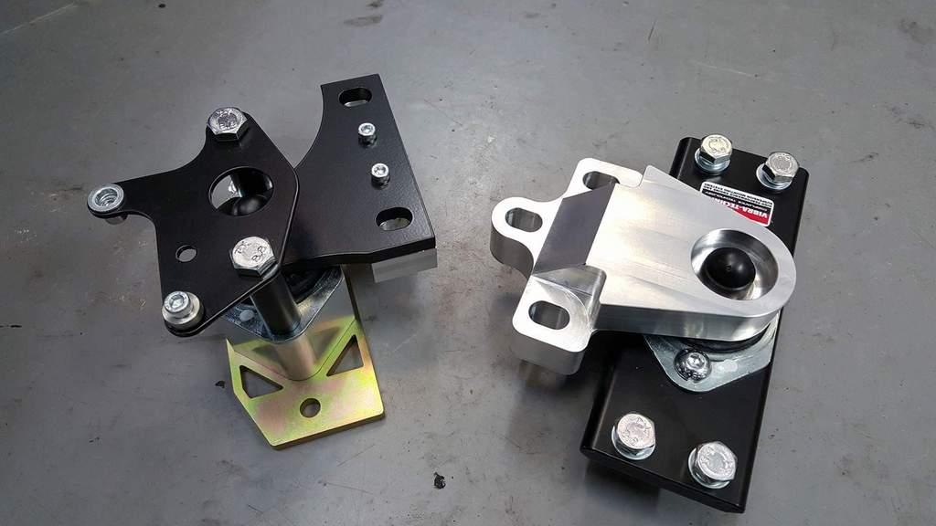

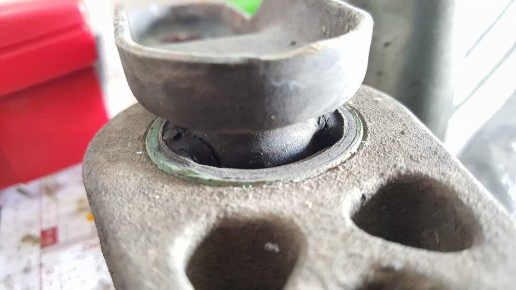

Also turns out I was wrong in thinking I had the vibratechnics dogbone mount, in fact I have the subframe mount and my dogbone mount is pretty badly split.
So that will be replaced and I will have the full set of 4 vibratechnics mounts.

Wow! what a difference on those inlets. How did you get them clean??
Cheers,
Chris
Alex at AKS did it.
I believe he starts by scraping/ brushing what he can (possibly with some sort of cleaning solution) but the main thing is he uses a walnut blaster to get them mint.

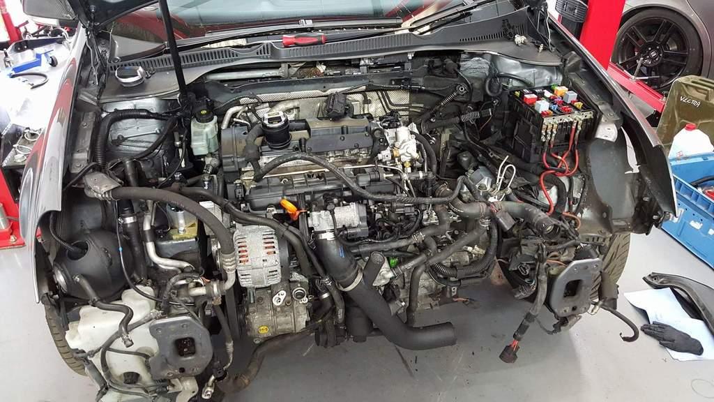

« Reply #673 on: May 30, 2016, 07:54:26 pm »
So before the car went to Alex my gearbox was sticking around reverse/ 1st/ 2nd gear and never really worked right since it was fitted 5k ago. Well we found out why, here's a video of the play in the box
Also the clutch wasn't fitted 100% correctly  :doh:
Although it still seems in good nic but obviously isn't great.
This is pretty great though

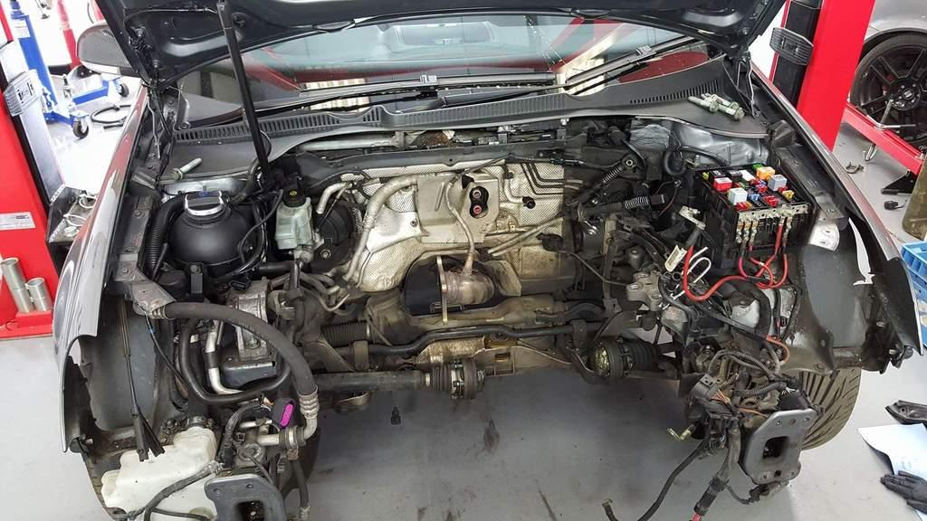

Bulk of the new engine fitted  :jumpmove:  :jumpmove:
Vibratechnics mounts  :drool:, I will now have all 4 of them.
Still plenty of stuff to do but she's getting there.  :smiley:  :smiley:
