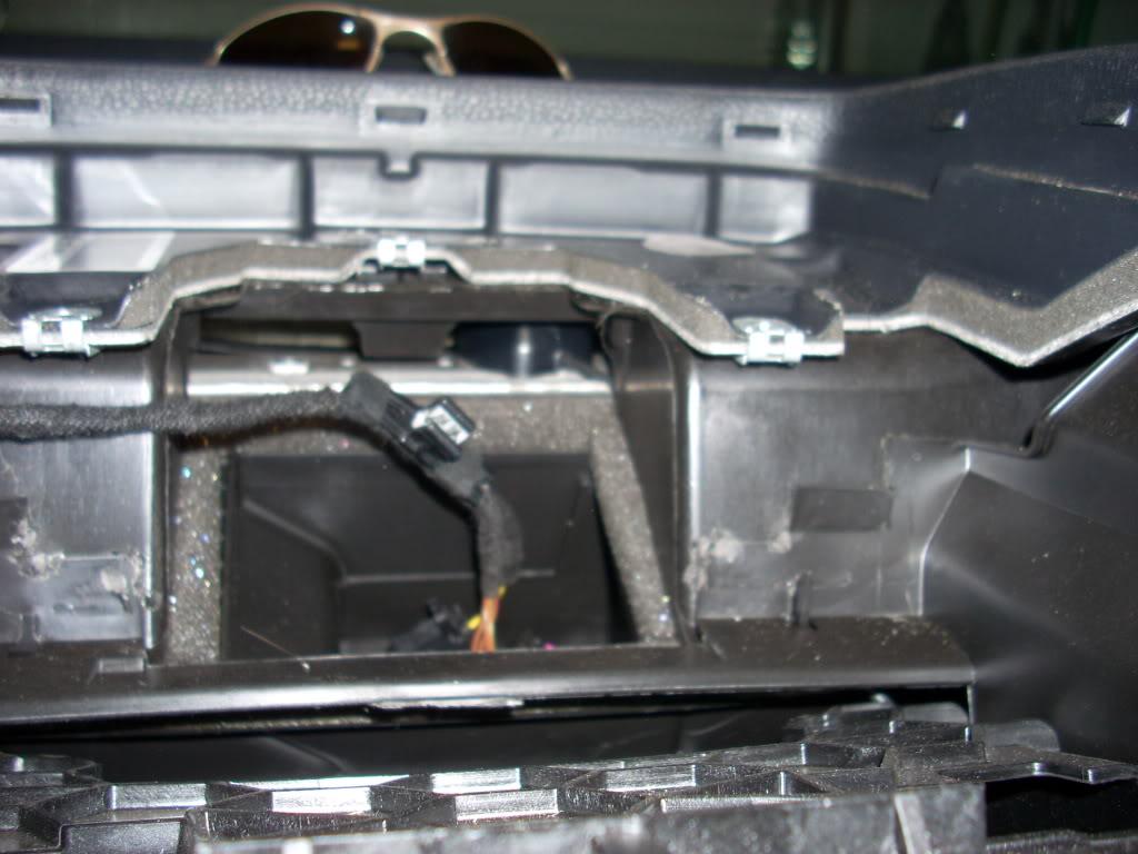

I have mine installed here (found this pic online and saw quite a few guides suggesting this is the best place for it)
can see it tucked at the back on the ledge.

hey guys
thanks for the replies
That's where mine was too

Your antenna position seems good and 6-8 satellites are normally enough for a 3D position lock.

Version P is what I needed to know. Your unit is fairly well up to date, so no real need to update the firmware. Also, the GPS antenna is in a suitable place (I usually fit them there with no issues). A different GPS antenna might be the answer, or reloading the firmware.
