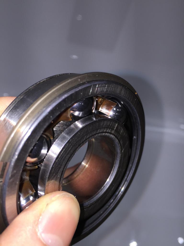

Here are some pictures of the bearing that came out of gear box and it is fair to say it is sh*gged! It is the bearing from 'clutch 1'.
This is a part of the bearing that isn't damaged,  as you can see the inner race is nice and smooth as it should be.

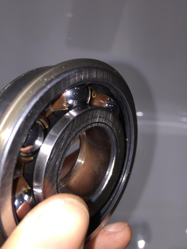

Now here is the damaged part, as you can see the inner race is heavily pitted and worn away. I have marked with red lines how long the pitting is on the race as not all of it is visible.

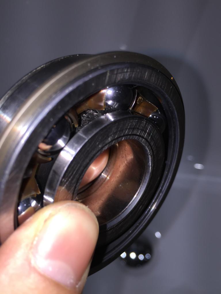

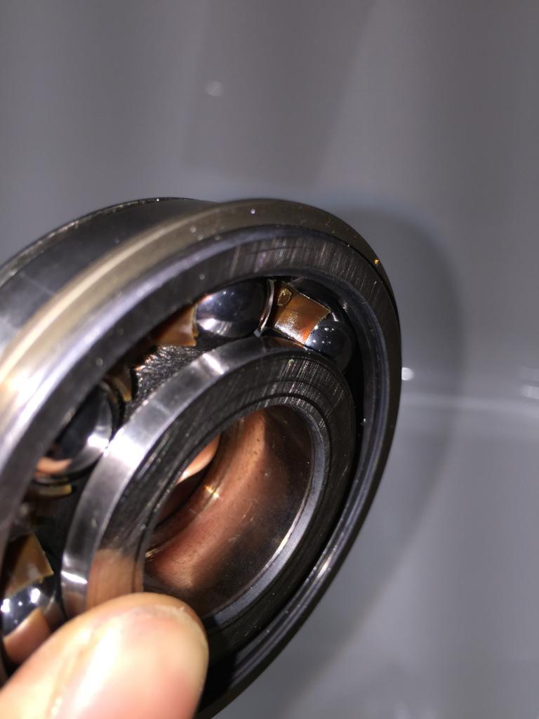

Here are some more pictures of the damage showing each part of it that the balls would otherwise be obstructing.
The bearing is obviously a defect. The gearbox has only done 58,000 miles which in the scheme of things for a bearing of this size is not a lot at all. Its as if there is a defect on the hardened surface on the inner race in the area shown, normally on a heavily worn bearing the pitting would be visible all the way round the races and an the ball bearings also.
