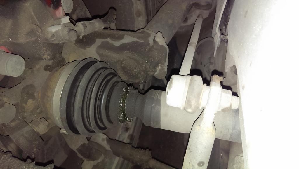

Get your phone in around the wheel and take some photos with the flash to see the damage. You won't even need to jack it up. Post the photos for the bants...

« Reply #5 on: April 07, 2015, 11:29:00 pm »
Hmm doesn't look good....

« Reply #6 on: April 08, 2015, 09:21:49 am »
Looks like a slow weep, the grease will congeal around the opening and thicken up with road grit and dust.
Should be ok until you can afford it. Some very strong duct tape such as gorilla tape around the opening might slow ingress down just enough.
