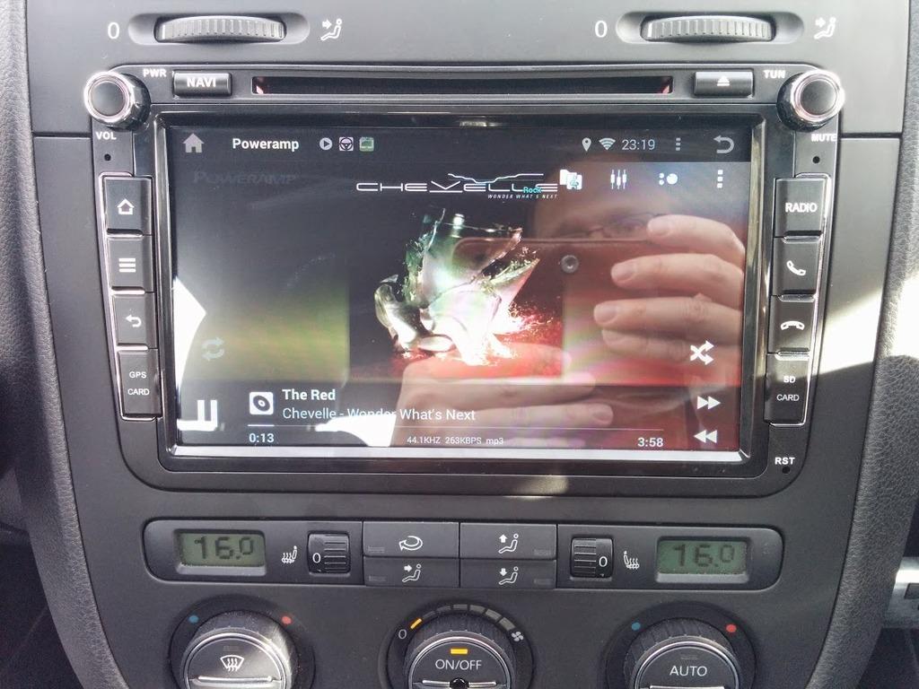

Nice and bright, very responsive with multi-touch (i.e. pinch to zoom etc). My only gripe is with reflections. Catch it at the right angle, and it's like someone is shining a giant watch in your face ;) I'm going to pick up a matte screen protector from ebay.

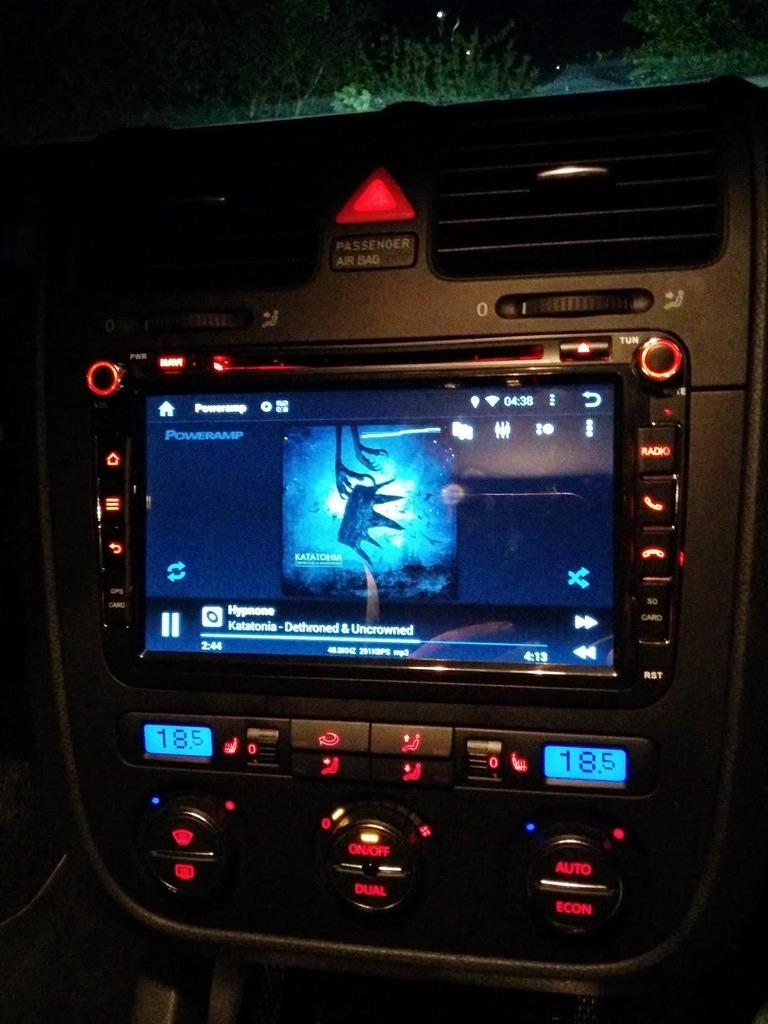

A couple of pics. Give me a shout if there's something particular you want to see.

Reflections and sun wash-out - I get this as well. Reflections come from the near-side rear window when I'm driving but then the sun was very bright yesterday. Suspect this will be the case for any large-screen double-din unit.
