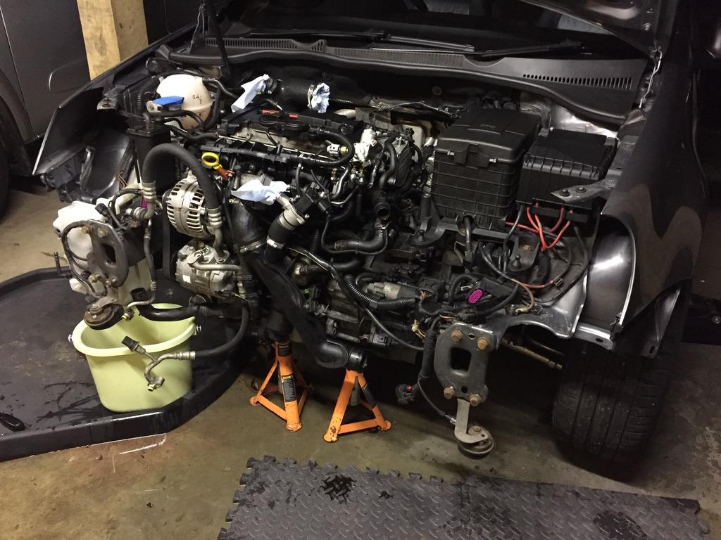

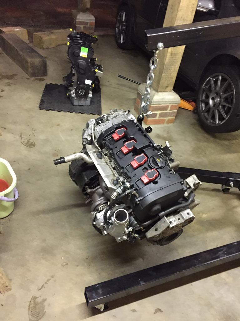

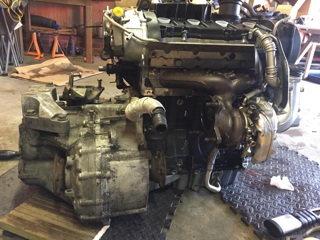

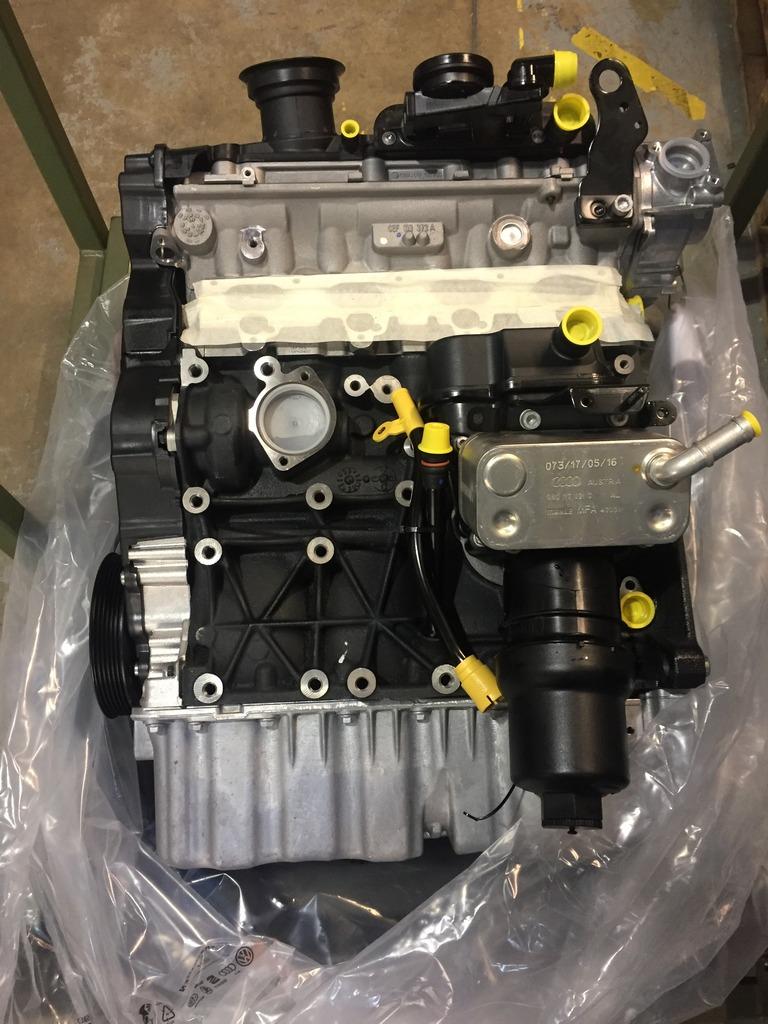

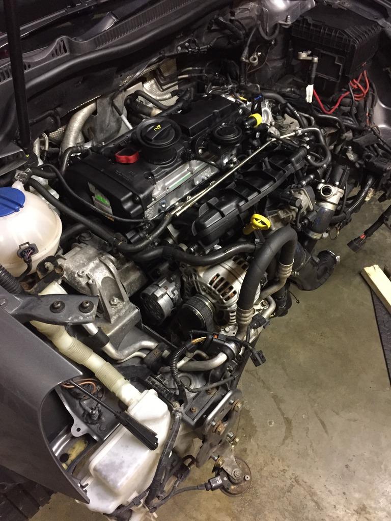

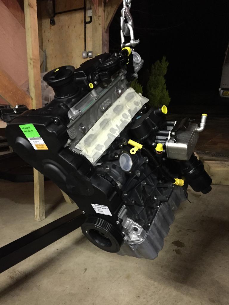

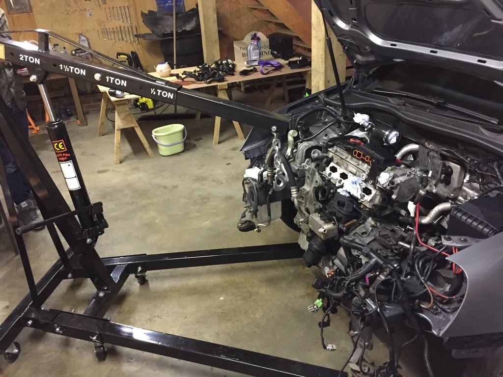

A few things have changed recently on the golf new CDL engine and vagbremtechnic 362mm discs and project mu pads
Old engine
Old engine out
New engine
New engine all built up ready to be fitted
New engine fitted
It's all up and working and running well just need to run it in now for 1200 miles  :sad:

« Reply #55 on: January 31, 2017, 07:15:06 am »
My old axx engine had an uncertain past, it was removed at some point and rebuilt and not properly built and since I had a k04 conversion done it was highlighting lots of different things
So to play it safe it was changed and now I can go tte420 now  :evilgrin:

Thanks @fab5freddy I've used millers 10w40 running in oil for 30 miles then dropped another lot of running in oil and ran that for 180 miles then changed it for fully synthetic, now to drive it the Crucial miles for wearing in is the first 50 or so, I could see the swarf in the oil when I changed it,
@Pudding I'll buy your tte420 if you don't want it  :wink: I can pm the price of the engine..
 I brought it from TPS also the ecu will adapt to the lower compression ratios  and it runs very well except the runner flap delete currently hasn't been mapped out yet..
cheers @ducman77 brought the engine from tps I didn't want to buy a second hand unit because you don't know what's happened to them  :thinking:
