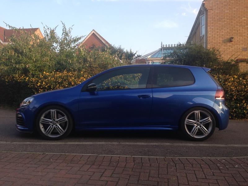

Bit of fun today, fitted some Eibach springs
Was alot easier than I thought it was going to be, no seized bolts, the front struts came out without any problems.
Then once I'd realised there isnt much movement when you disconnect the rear strut and you only need to remove the lower arm bolt to get the spring out all was good.
started with an arch to wheel center of F-345mm R-360mm and ended up with 330mm front and rear
 Mk6 R :)

looks a lot better now its lowered

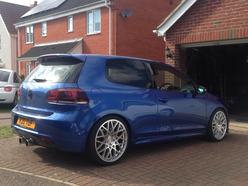

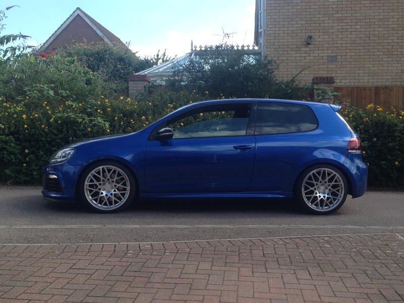

And added some new wheels into the mix.

Very very nice I like them  :happy2:

That's a really nice drop for springs. Looks like a bit more poke with the new rims too?
Are you sticking with standard dampers?

What's rims are they?
Thanks.
Sticking with standard shocks for now, I've read they are the same eibach springs that VWR use and say can stay on stock shocks. If/when they fail I'll look to upgrade
They Rotiform blq reps, 500 of ebay but look to be half decent quality

Looks spot on. Low enough to 'look low' if you know what I mean, but I'd imagine not impractical.
I like the little splitter too.
Wonder if you can get one for an ed30 front..

I'm on H&R Springs and that looks lower than mine.
I'm 335mm centre to arch. (Just checked)
This looks way lower than that to be fair.

When I fitted then 2 weeks ago they measured 330 arch to centre, may have dropped a bit since
