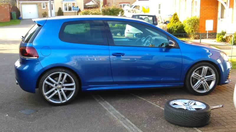

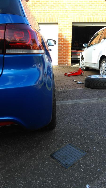

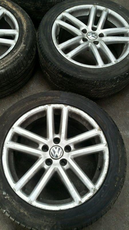

Finally got round to buying a pair of adapters to trial fit the 19s, could only get adapters with a 5x120 & 72mm center bore so had to turn them down to 65mm for the toureg wheels.
Fitted a 235/35/19 tyre to one wheel and fitted it today
According to the internet a 9" rim doesnt fit a mk6 without body mods, these would be ok if I dont lower it and were to keep the tyre size fitted which gives a stretch.
Hey ho, they'll be for sale soon

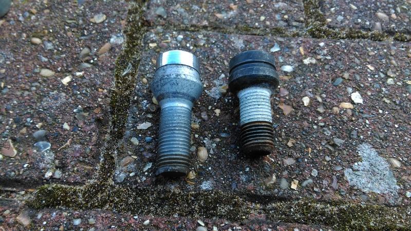

Still, I did find that the lockers fitted were wrong and had a straight chamfer and not the domed head,
Luckely I had a set from an old car in the garage so I changed them

« Reply #8 on: February 29, 2016, 09:19:58 am »
TBH you could run that wheel quite happily if you add a touch of camber (which would happen if you lowered it anyway).
That wouldn't rub.
Although on the front if may be a bit tighter..

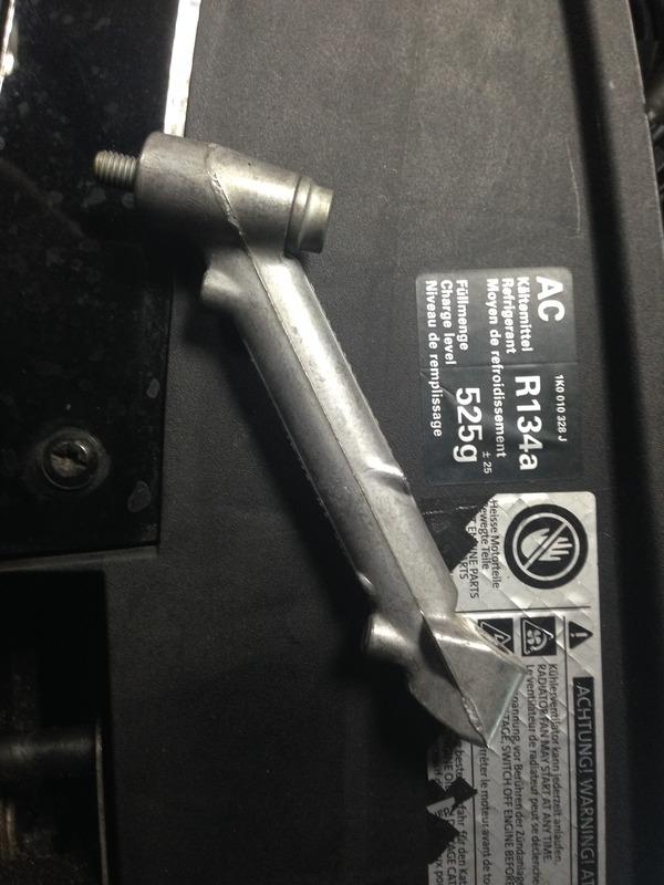

Although, I did think about selling it as a non runner whilst trying to undo this
Bloody manifold support bracket  :evil:

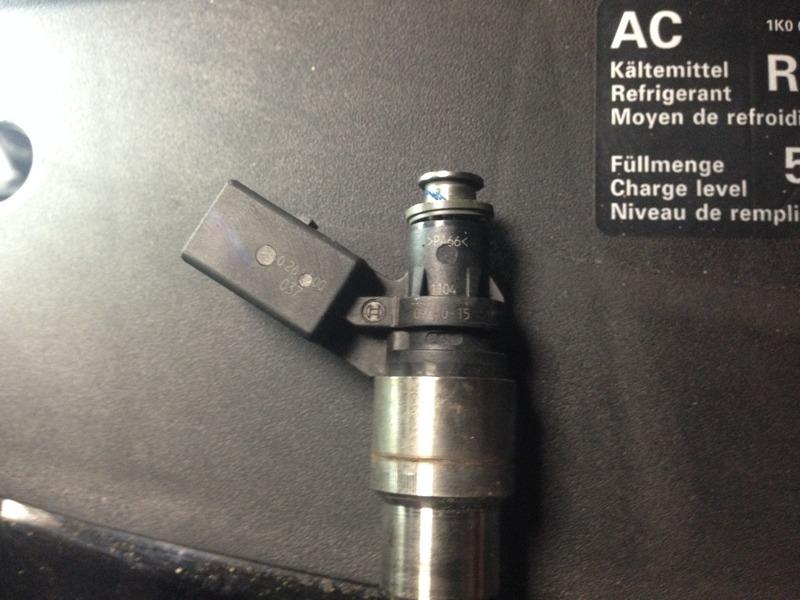

So, it looks like emerald (a local tuner) do injector cleaning and checking so I'll give em a call tomorrow
Does anyone know how the date codes read on the injectors?
Mine show as 09 10 15 which could be ddmmyy and therefore were changed last year or they read yymmdd which would put them inline with the build date of the car
