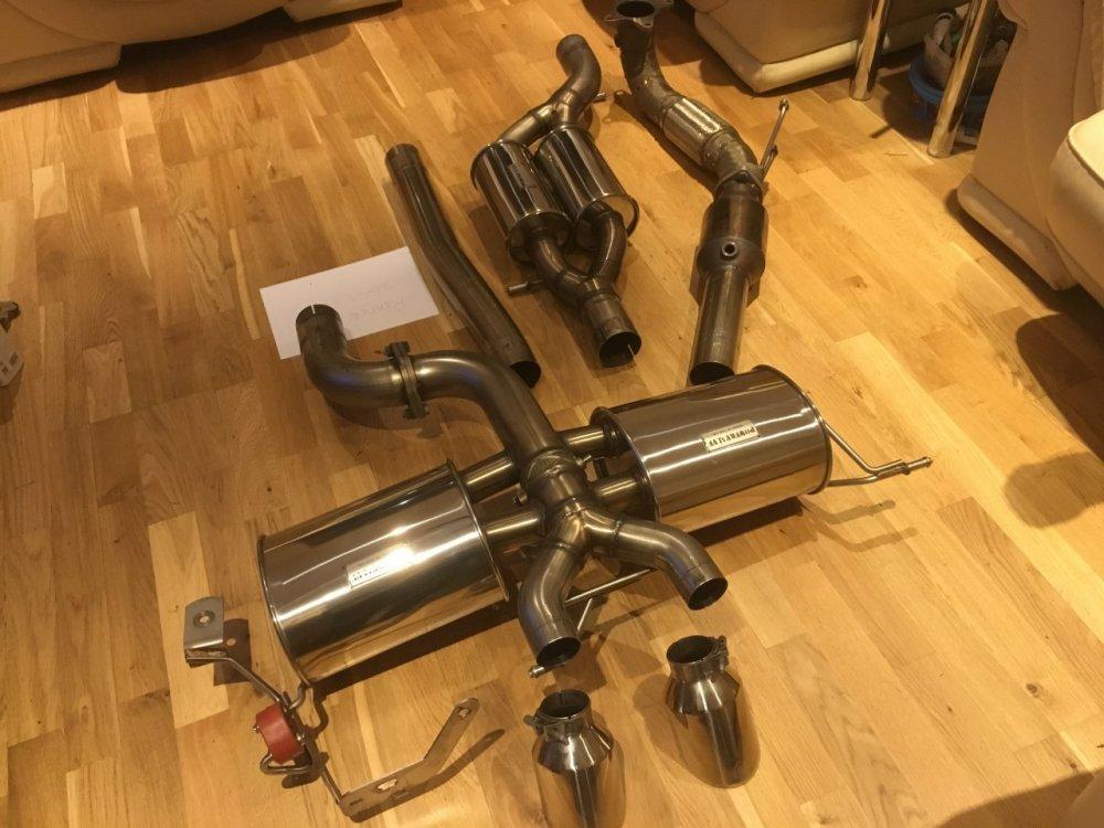

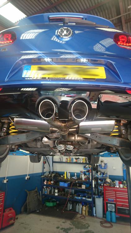

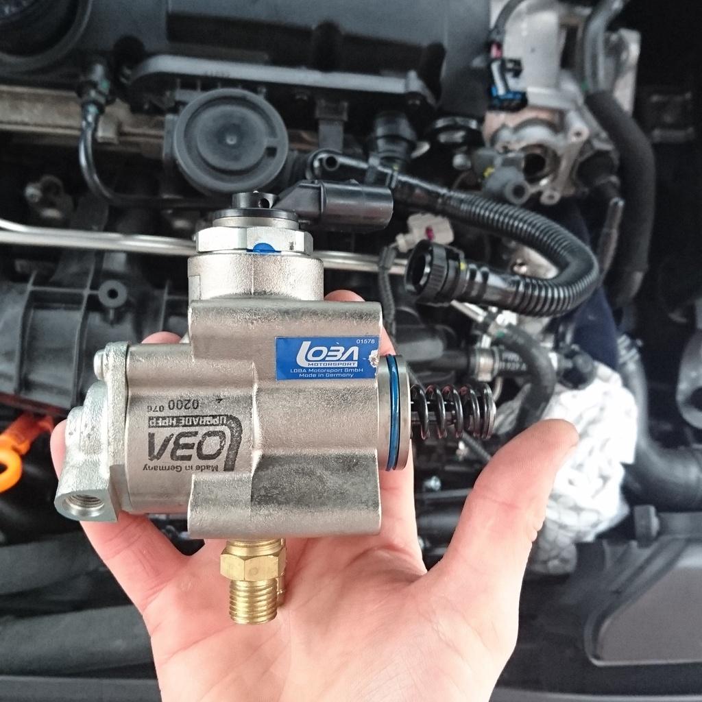

Manage to get my hands on a full bcs system with 200 cel sports cat, GFB diverter valve and a Loba hpfp from the classifieds on VWROC at a great price so was made up with this.
Installed the Dv and fuel pump myself. Car seems to pull better through the Rev range and feels stronger but not sure if thats just in my head as still running the same map so no sure of the pump would actually make a difference?
NIge at BCS fitted the exhaust.

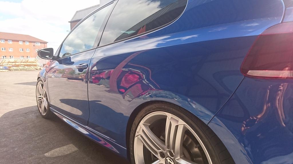

Couple of pics after I gave the car a clean and decontamintion follwed by a machine polish, wiped down with ipa and then finished off with a layer of dodo juice supernatural hybrid nano.
Products used below
Vallet pro advanced snow foam
Vallet pro posiden shampoo
Autoglym tar remover
Iron X
Das 6 pro
Orange and white hexlogic pads
Meguires 105 on some areas
Meguries 205
Dodo juice supernatural hybrid nano.
Only the 3rd time ive used the DA but seem to be getting the hang of it.

You'll often feel some improvement from the Loba pump right off the bat. You'll probably find the standard pump was only just keeping up with fuel requests at low-mid revs and the Loba is now taking things in its stride.
From what I gather, standard pumps can be a bit of a mixed bag, so while 99% are fine with the stock map, some struggle slightly at Stage 1, and quite a few really struggle - giving fuel cuts - at Stage 2. I actually got a Loba after going Stage 2. Even though a Stage 2 map theoretically doesn't request more fuel than the standard pump can hack, I got those dreaded fuel cuts. The Loba fixed that, and definitely gave me more torque coming onto boost than with the standard pump.
Obviously a 2+ map would be way above the abilities of a standard pump, so you'll really feel the extra torque in the mid range once you get to that point.
The car itself looks gorgeous by the way. Exactly how I'd like my own 6R to be. One day maybe! :)
Thanks for the info. Not just me imagining it then. Ha.
