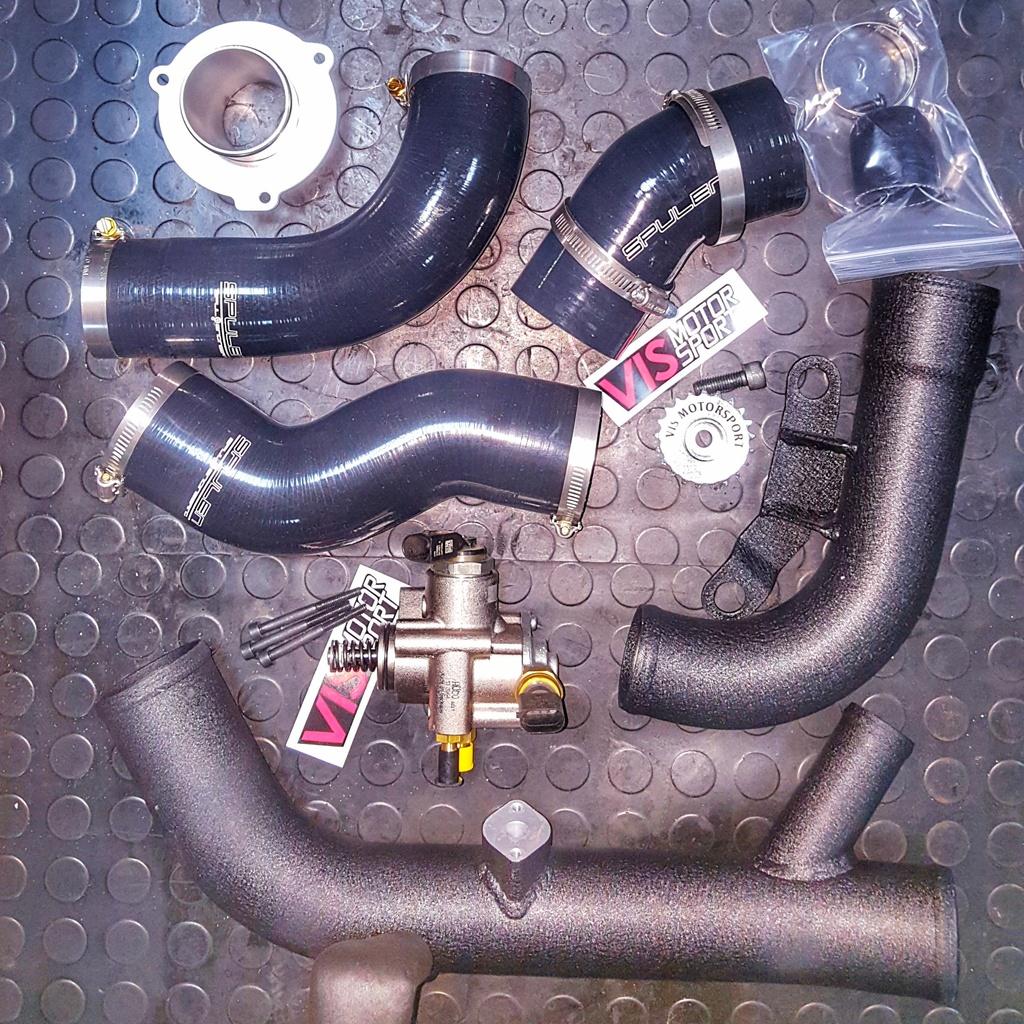

And bought a HPFP and the balance shaft delete kit from VISmotorsport and some Stilen piping for the engine to breathe from USPmotorsport
didn't had much time to work on it but still waiting for parts and then I will get to it  :wink:
