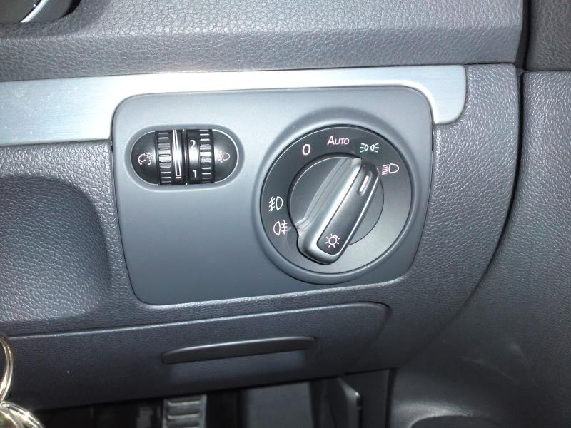

As part of retro-fitting my Xenons, I'd like to remove the current Headlight control panel (I've got the chrome auto switch like the R32  :smiley:) and fit one without the halogen headlight adjuster toggle. Is it possible to do a straight swap?
This is mine currently:
If so on that note, does anyone have the part number for the OEM Factory fit with Xenon panel please?
Hopefully both are the same size etc and the wiring doesn't need to be changed  :smiley:

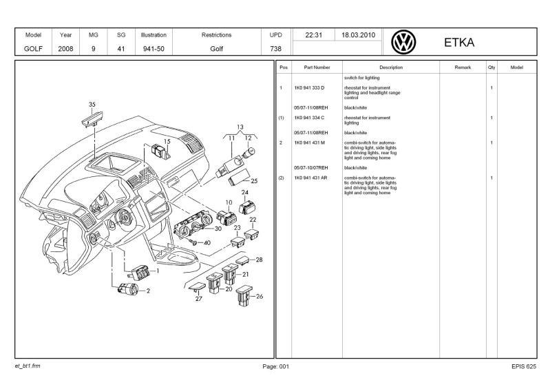

I think (1) is the one you want.  Use the Part number 1K0 941 334 C REH.

There you go Pete, cheers Dave saves me having a look...This is the one I bought from VW for mine.

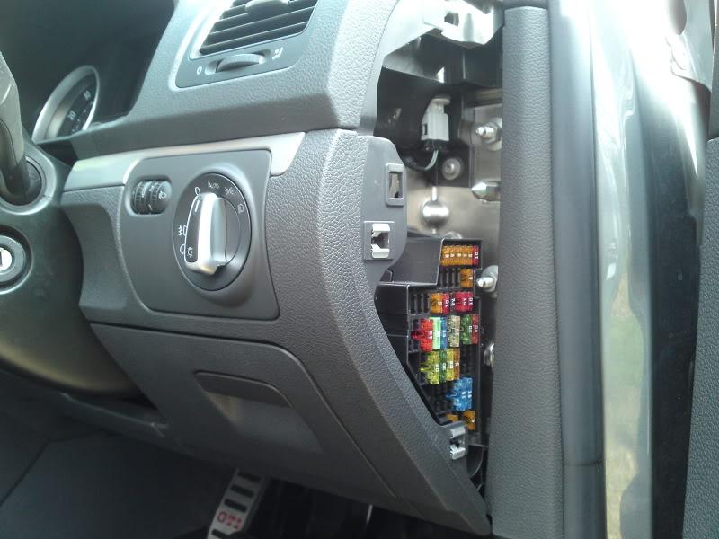

Hmm sort of, but I just don't think I've taken enough panels off as I can't physically get my hand in to get to the far side to release the clip  :signLOL:
I'm this far;

« Reply #13 on: April 10, 2010, 11:09:44 am »
Pete that panel where your knee would be and where the full light switch is, the whole of that needs to come off there
1 torx screw behind the light switch, turn to the off position - push in and hold - turn clock wise and it will pop out,  you'll see the screw.
Now take the little cubby hole tray out - drop down and squeeze the sides and pull out with a little bit of force, you'll need to get on your knee's to see the screw under the panel - there is also 2 other screws you'll see straight away.
Drop the steering down take the upper cowling off with the bit of faux leather on it and take the right hand screw out.
The panel should just drop away from the dash then...you'll have access to the adjuster and you'll also see what I mean regards the clips.
