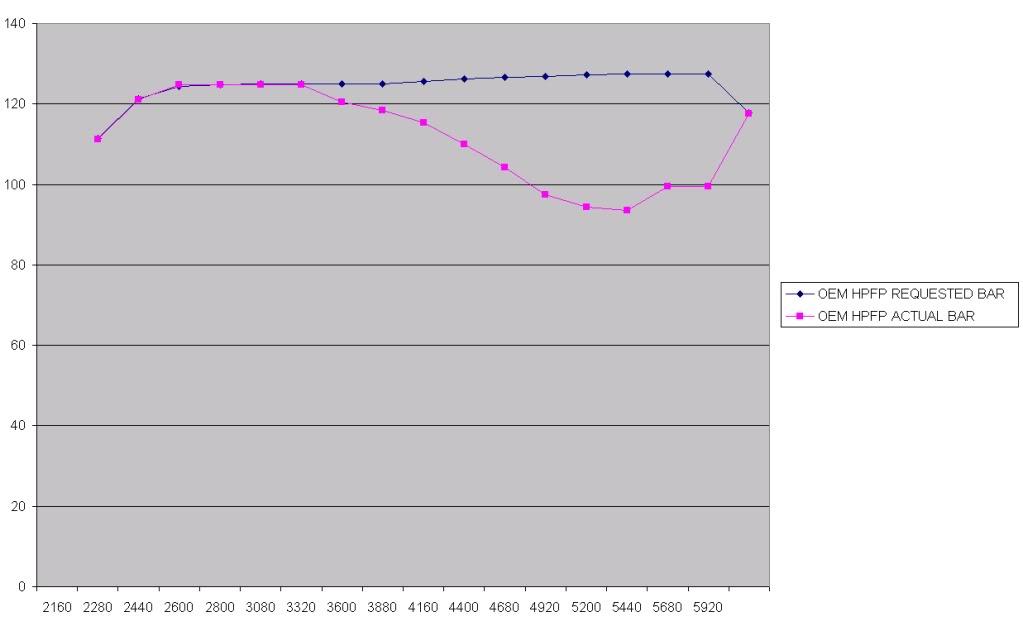

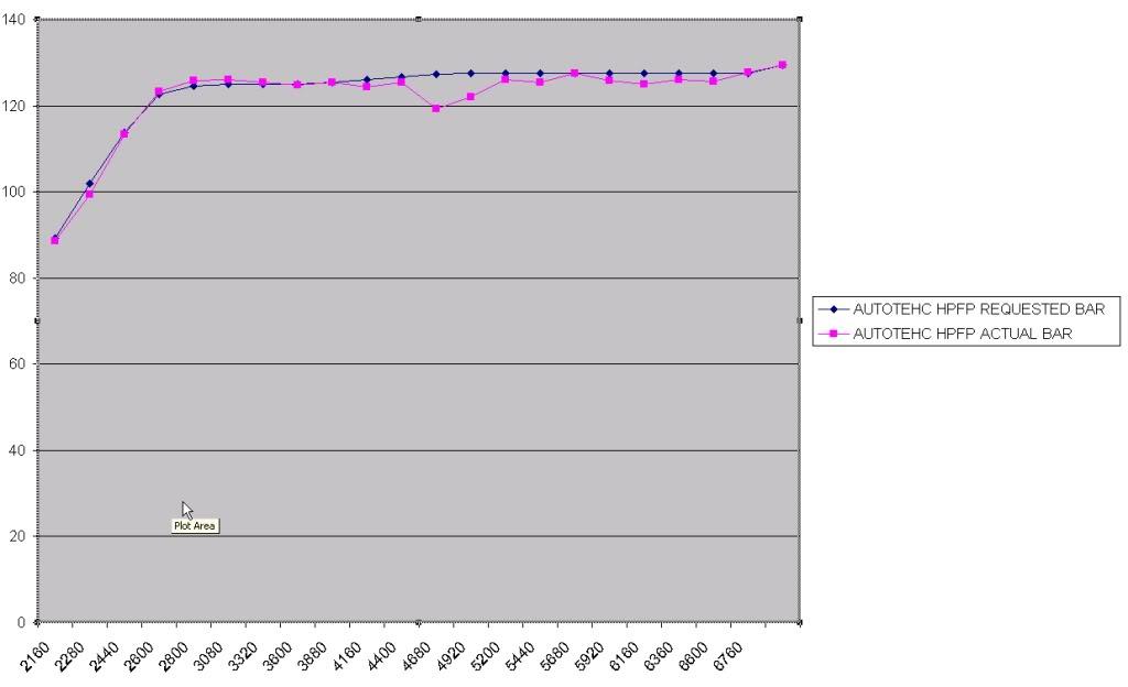

As most of you probably know I do a lot of logging my car with VCDS.  As part of the logging I noticed that even while the car is at stage 1 an uprated HPFP would be of great benefit. A picture says a thousand words so here you will see what I mean:
Here is a rail pressure plot of what happened with B7 on the OEM HPFP:
Here is a rail pressure plot of B7 with the Autotech HPFP:
As you can see the OEM HPFP is simply not able to maintain the requested rail pressure at B7 while the Autotech HPFP keeps up with no problems at all.  This is why I have always run my stage 1 map at B6 up until now.  When running higher boost it puts more pressure on the HPFP to provide fuel.  This is because higher boost = higher airflow and to maintain AFR if you are flowing more air you will also need more fuel.
Before getting the upgraded pump fitted I wanted to make sure there would be no issues running the pump with stage 1.  After having spoken to JKM and REVO I learned this should be no problem at all.  Here is some great info I learned from JKM:
Quote
The fuel system has full feed back from the high and low pressure sensors and is self adapting to allow for wear in the fuel pump over the vehicles life. When you fit a higher volume fuel pump on the TFSI engines the ECU will just use a smaller compression volume window to get to the correct fuel rail pressure.

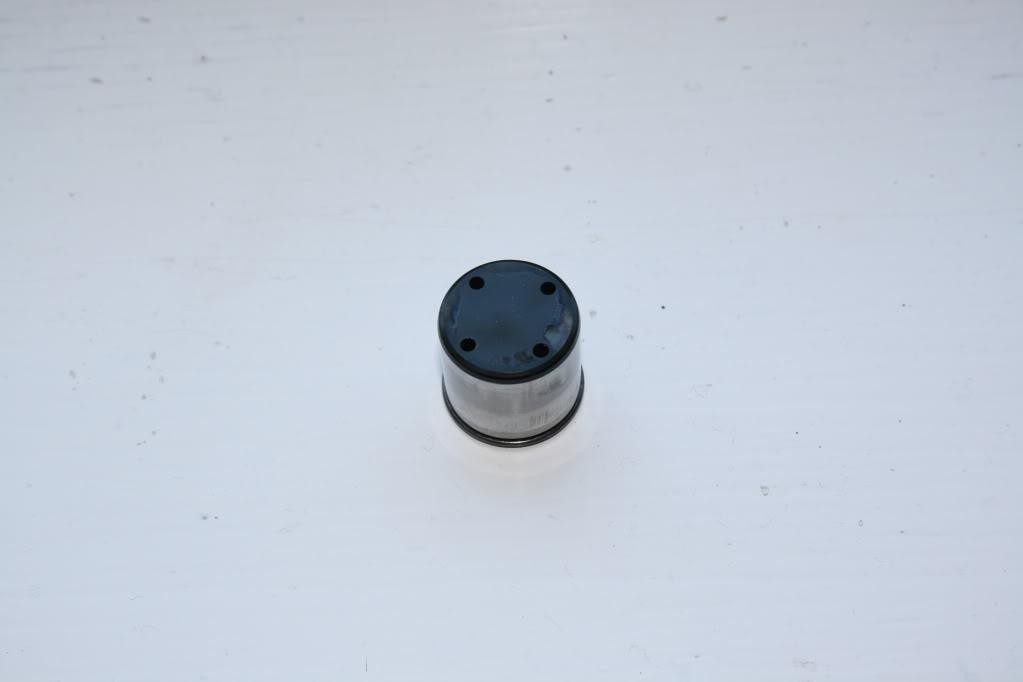

 - Cam Follower Wear
Fitting an uprated HPFP means the HPFP will be putting more pressure on your Cam Follower and will hence increase the rate of wear.  This means you are likely to need to check and change your Cam follower more often than you would with the OEM HPFP.  I intend to check my cam follower every oil change.  It is no more than a 30 minute job to check.  A replacement follower can be had for £26 so it is not much hassle.  The TT Shop told me they have seen many followers looking fine with 20k+ miles on them with an uprated HPFP.

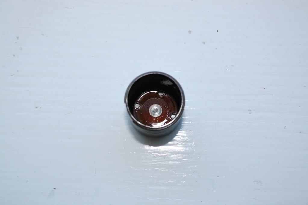

My OEM follower had done 31.5K miles 12k miles of which were remapped with stage 1.  This is what it looked like:
The DLC coating on the outside of the follower looks good.  On the inside you can see that the DLC has worn away from where the piston of the pump has been in contact with the follower.  The follower probably would have been fine for xxxxs more miles but I decided to change it anyway while I had the Autotech installed.
