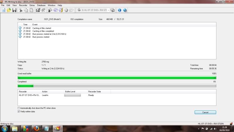

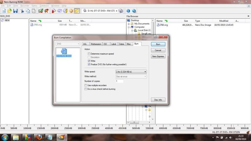

i'm sure you can burn the dvd at 2.4x. You want the lowest possible burn. Do you enable verification too to make sure the data's been written correctly?
rdfcpete
^ Verify was indeed ticked. I'll try at 2.4x. It must be more fundamental than that though I'm thinking? It sounds as though its read the data but then can't load it?

To burn the disc right click on the image and select open with Nero.
When it opens then just Burn the image to disc (do not create a data disc otherwise that wont work).
Burn it as slow as possible and verify it afterwards.
