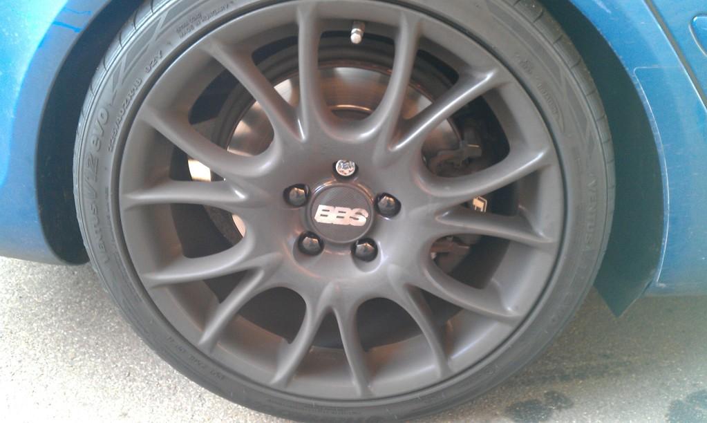

Great project. What size and ET are the BBS CK's? What tires are you running?
Offline vRSAlex
  • -Receive: 253
  • Posts: 2761
Re: BDMAlex's Octavia vRS Estate
« Reply #166 on: November 14, 2011, 09:44:57 pm »
They are 8x18, et44 with 225/40/18's  :happy2:

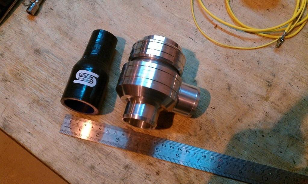

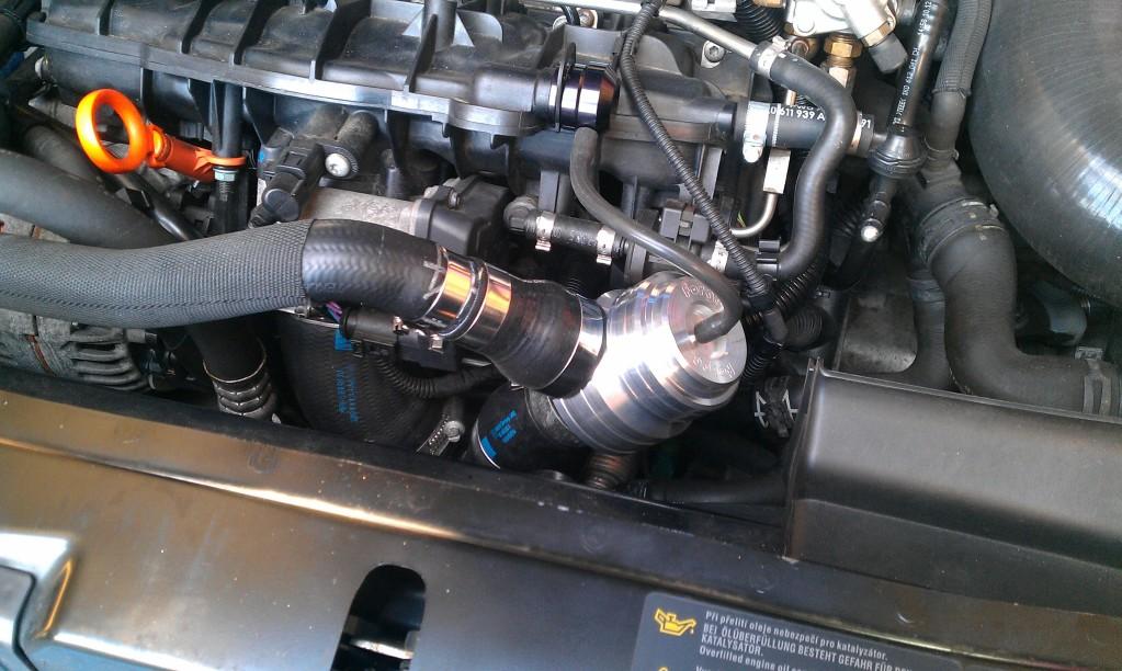

New valve.  The Forge Supersize.  Fitted these in the past and they have worked very well and respond even faster than the D valve.  Even holding boost better.
Got it fitted last night and a massive improvement noticed straight away.

All you need is the valve, a 38-25mm reducer hose, a 25mm hose joiner, 45mm hose clip and a 25mm hose clip.  The reducer hose needs cutting down.
Then needs a vac line from the inlet which you already have for the other forge valve.  The N75 valve still needs to be plugged in electronically, but no hoses.  This stops any error codes.
I will pop to the car and get some pics of it fitted.

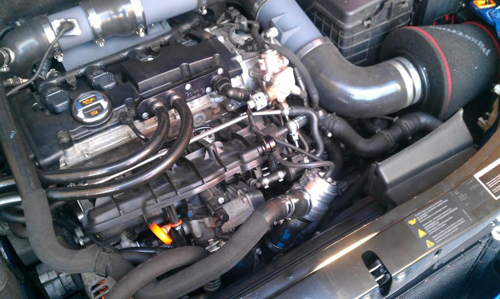

Some pics of the valve all fitted

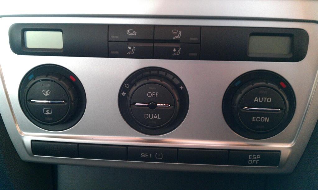

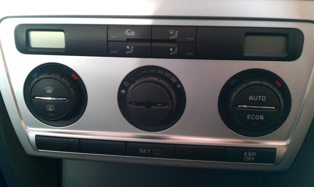

The vRS doesnt have the 'OFF' or 'DUAL' buttons on the climate control so I grabbed a Golf unit and swapped the buttons over
Before:
After:
