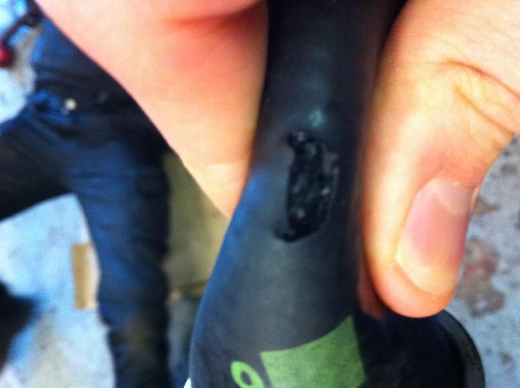

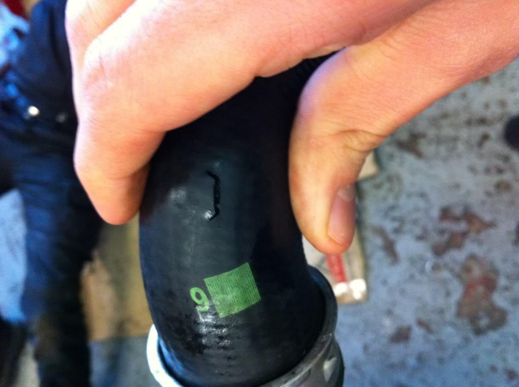

This was the egr delete pipe i was looking at
http://www.darksidedevelopments.co.uk/products/2-0-16v-tdi-pd140-pd170-egr-delete-race-pipe.html
and possibly this aswell if required
http://www.darksidedevelopments.co.uk/products/2-0-16v-tdi-pd140-bkd-egr-cooler-delete-pipe.html
This was the source of the whistling turbo
They replaced the pipe and i got half way up the road and it started running very lumpy and wouldnt rev much  :scared: :scared: :scared:
Turns out he hadnt tightened the "jubilee clip" up enough so all sorted now  :pomppomp: :pomppomp:
