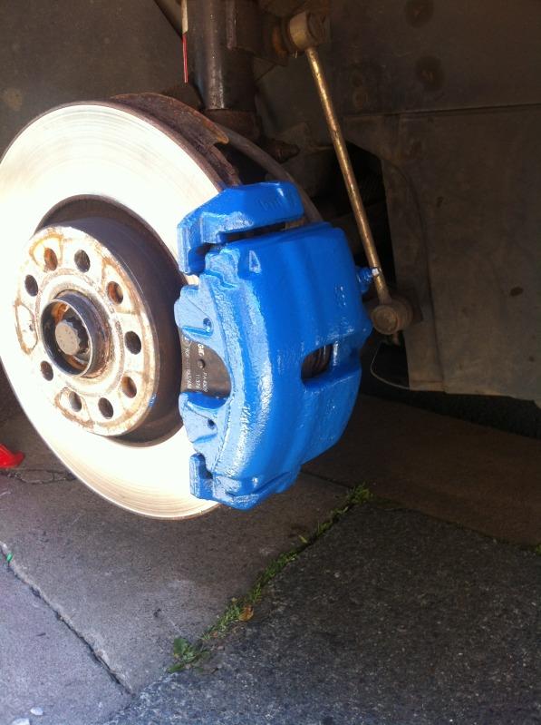

Painted my calipers blue  :jumpmove:
Nice job!  :happy2:
Did you brush paint or spray?
Which paint was that you used and how (prep etc) if you don't mind my asking.  :drinking:
Nice job!  :happy2:

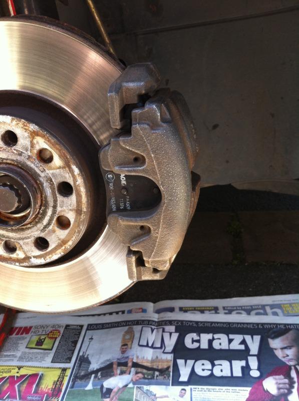

Thanks mate, Its brush paint - used Hammerite smooth direct to rush paint  :happy2:
First off i wire brushed the calipers until all the rust and loose crap was off them, then i sanded until there was no corroded areas and the surfaces were flat:
followed by 2 coats of paint  :happy2:

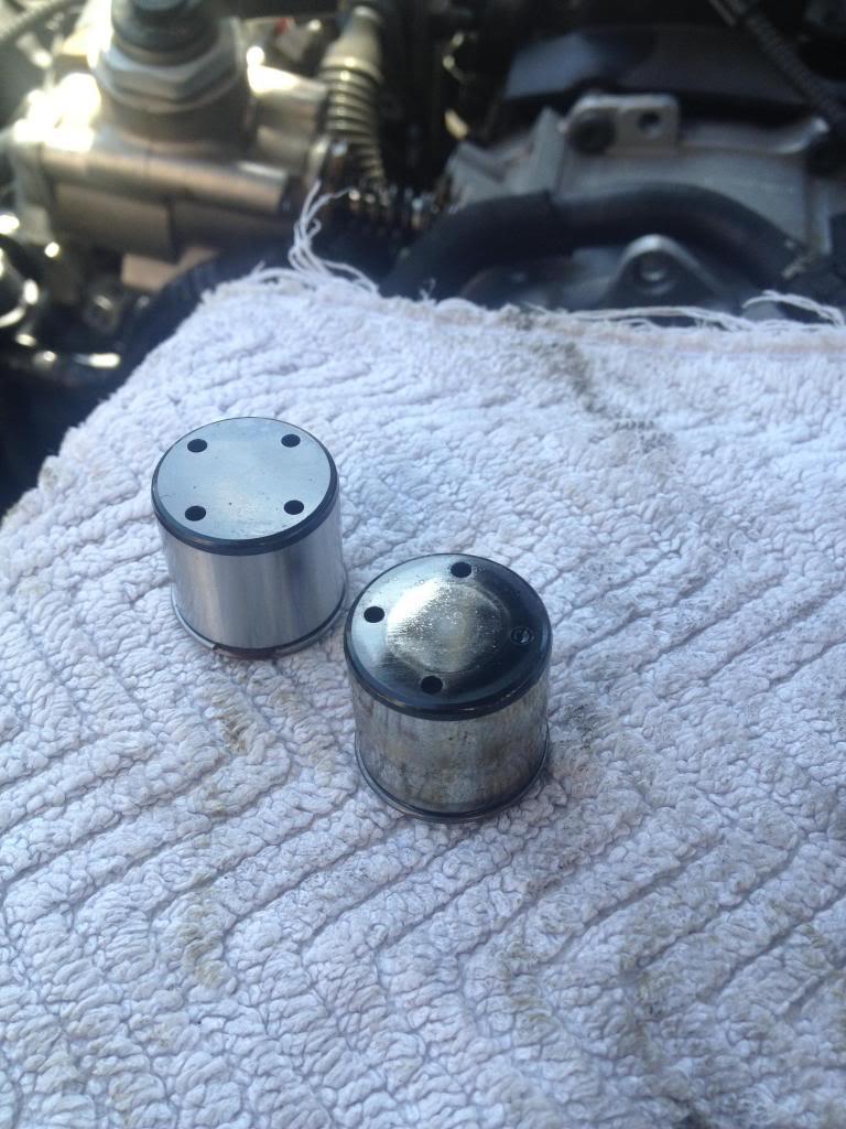

Following the successful install of my door lights yesterday, and as my wife and daughter are away, I busied myself doing another of the jobs I've been putting off for ages namely replacing the Fuel Pump cam follower. Annoyingly, whilst the cam follower part was easy with no problems I managed to break the electrical connector to the thrust sensor which attaches to the left hand side of the pump and the only way to keep the connector firmly attached to the sensor is using cable ties. I guess these connectors can get brittle and I pushed the tab a little too hard trying to slide it off. Main dealer for me Tuesday morning!
The cam follower didn't look too worn but I'm glad its changed; my Edition 30 has 69K miles now so shouldn't need changing again for some time.
Anyone have experience of rewiring these connectors?  I'm sure I'll be able to work it out?!? :confused:
Old cam follower on the right....

You can buy most connectors and repair wires from vw/tps quite cheaply
did you paint them in place or off the car???
hand painted or sprayed??
great tidy looking job
