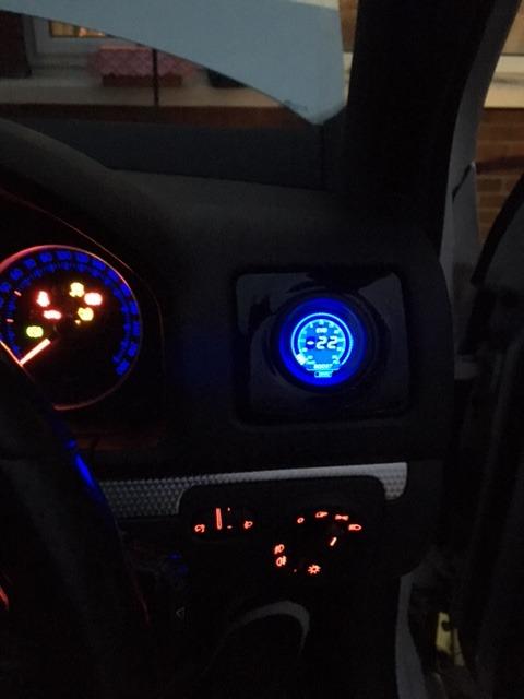

Thanks mate, it was a little bit awkward to fit but nothing major, they're a nice gauge as you can select which colour you want during install by powering up the corresponding wire. The pod i got from a different eBay seller and it fits like a glove, no screws or adhesive needed.
I went blue to match the dials but I find it a bit bright at night so I might change it to red and see what that's like.
The actual boost reading unit is under the bonnet and all you have to do is run the wire which carries the boost information back to the gauge, no need to run the vacuum tube back through the bulkhead/dash. The gauge itself I tapped into the headlight switch for power and under the dash for earth. Relatively straight forward. The only thing that was a bit off was the T-piece was too small to fit into the VW pipe coming off the inlet manifold but a quick trip to Halfrauds sorted that out.
Gauge :
http://www.ebay.co.uk/itm/222299928438?_trksid=p2060353.m2749.l2649&ssPageName=STRK%3AMEBIDX%3AIT
Pod :
http://www.ebay.co.uk/itm/222226051921?_trksid=p2060353.m2749.l2649&ssPageName=STRK%3AMEBIDX%3AIT

nice one thanks for letting me know about the t piece and luckily I have a spare brass one although I don't think I'll need it due to having a pcv adapter and a spare connectors jhook sent me so all that will need is the wiring to be done.  :happy2:
Also I want the blue but if you're saying it's too bright you can connect the dimmer wire to the headlights to dim it I think. Read the description in eBay as I'm sure it's possible  :wink:

I'm sure I read that too, I was thinking about that but I'm happy with the dash at full so if i was to connect to the dimmer, I'd end up dimming my dash to a point where I wouldn't like it but would be happy with the gauge! Can't win, so maybe a layer of tinting film might be the answer as I quite like the blue!
Have you ordered one?

tint will do the job for sure  :happy2:
What I meant was when you switch the headlights on it auto dims the gauge by taking the power down but not sure if that works the same way.
I was going to buy one but someone says he has one for me although not sure ima take that as I prefer the digital swoop and numbers personally so will most likely get one of these soon.

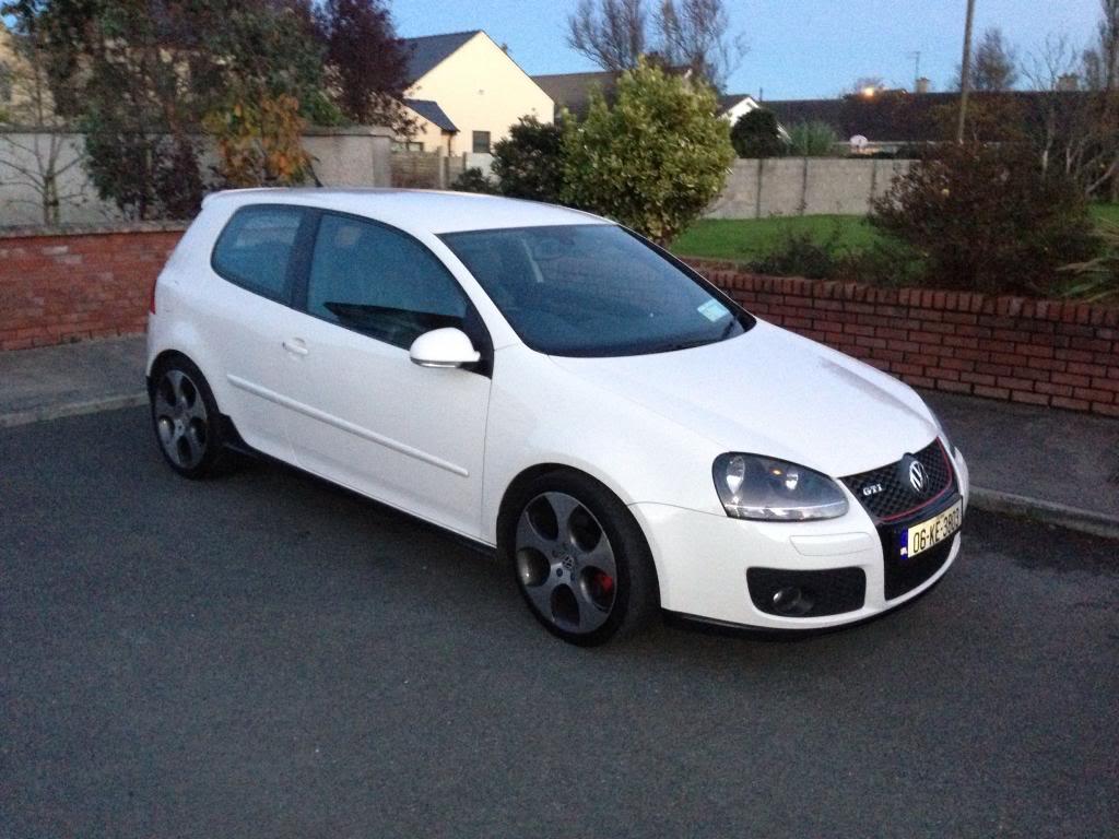

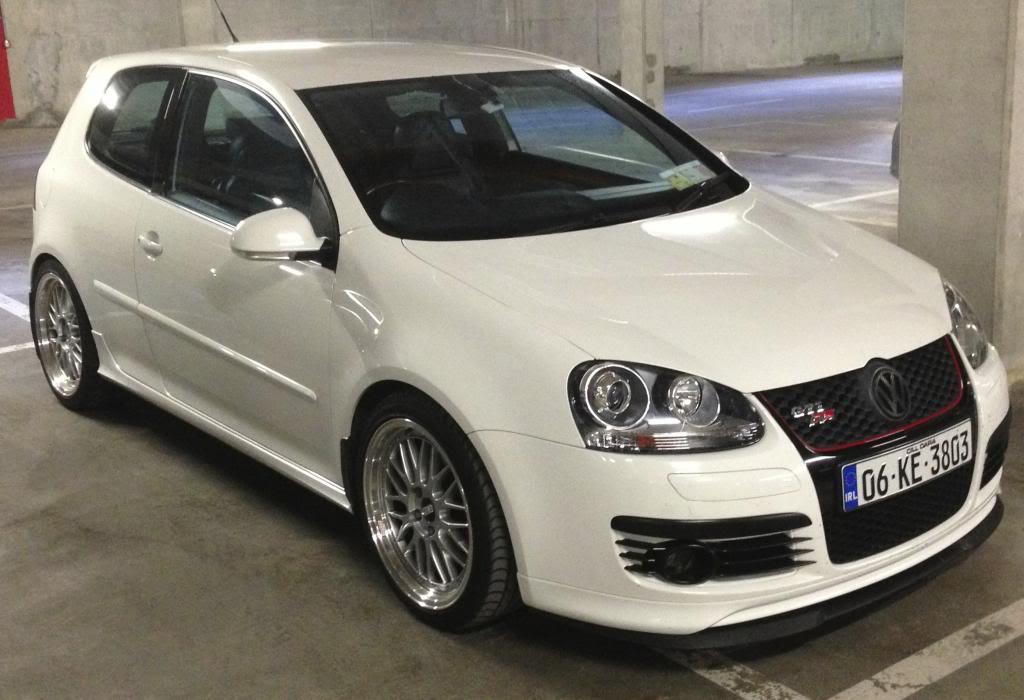

Busy, busy weekend working on a few things which  have been bugging me.
I recently bought this car back from my sister who's had it for the last 4 years, let's just say, she'd service it but that's as far as "minding" a car goes with her!
I bought it standard about 5 years back and had it for a year, during which I made several changes.
Hella projectors, Anniversary rears, R32 rear bumper and back box, colour coded side skirts, Anniversary front splitter, Cupra lower splitter, R-line foglight covers (colour coded between the blades), custom fitted mudflaps and 18" BBS LM replicas. Before and after pictures below for comparison.  :happy2:
So this weekends work consisted of some much overdue maintenance and some tweaks;
Service : Oil, Air, Cabin and fuel filters. Plugs. Rear OE shocks and springs, Main thermostat (nightmare) Cam follower - I  have the banjo bolt so a bit of extra headache but all was good so happy days..
Vag-Com & retrofit : Boot pop kit, beep for lock/unlock, install/activate cruise, skyline rear lights, window closure on remote, boost gauge in the air vent.
Does anyone know if auto dip mirror for reverse is possible without memory seats, saw it in the options, ticked it but no go? (DSG car if it makes any difference).
looking lovely that is. You got a build thread?
