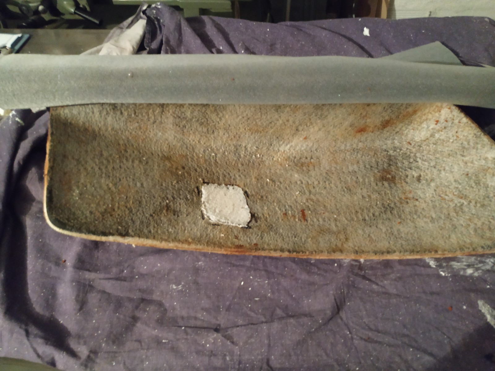

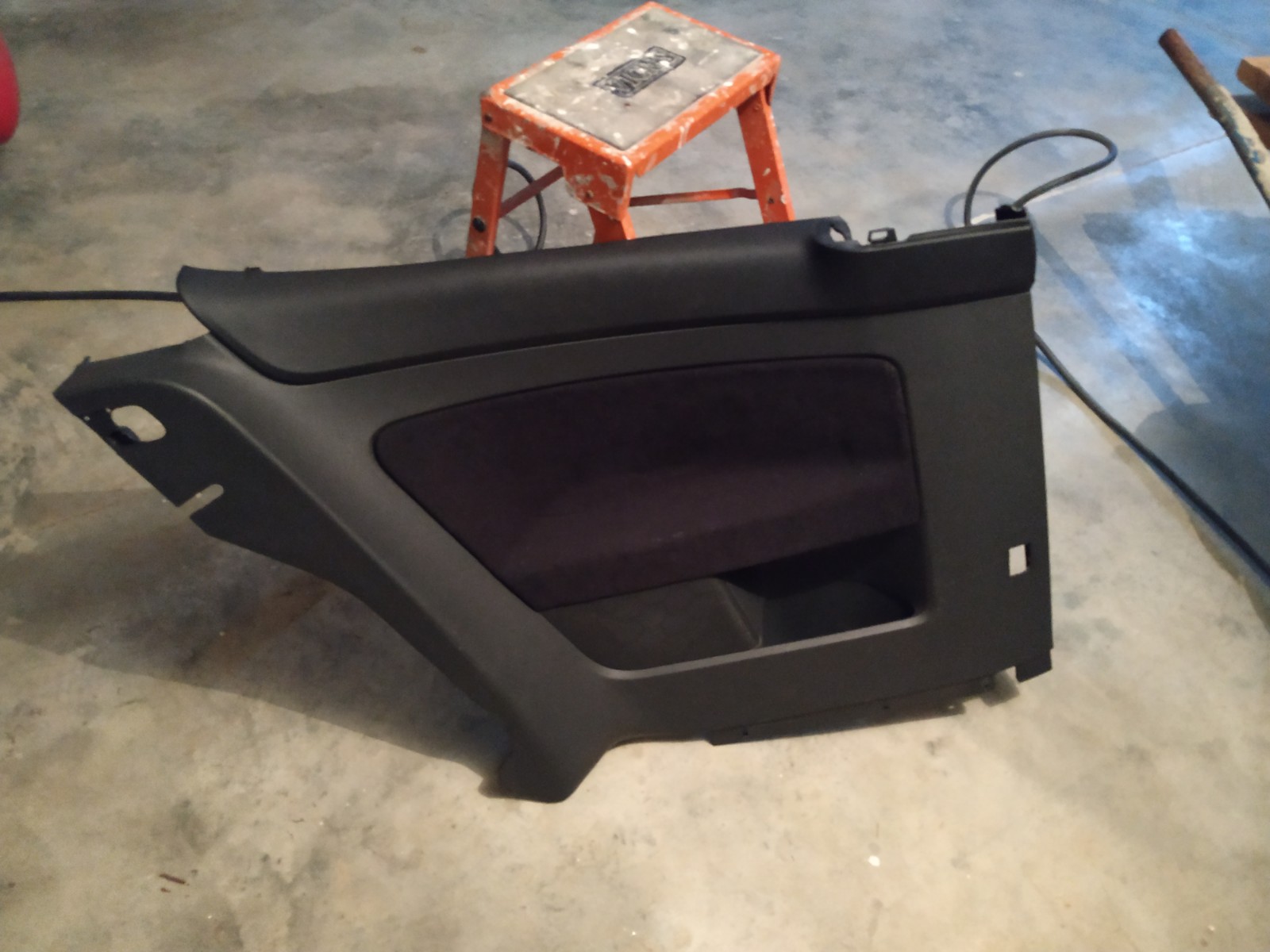

This was an absolute PITA. Still have three to do and don't feel like starting them.
You will notice that there is now no tweeter, the rear speakers were not connected anyway. It disintegrated when i tried to remove it.
I heated the plastic welds to split the trimmed piece then reheated pushed the two pieces of plastic together and blasted with the compressor to cool. In places i also melted the plastic from the tweeter on top to give a bit more strength. Will let you know if/when it fails.
