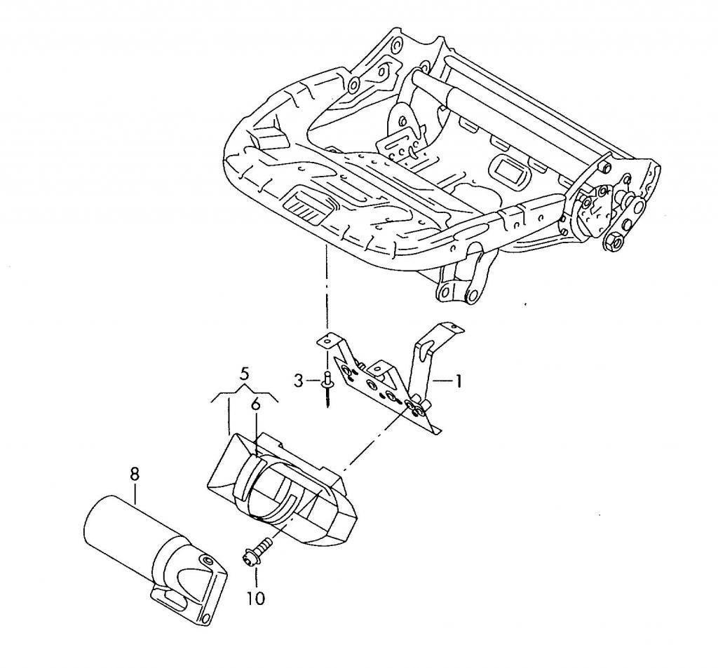

fitted this bad boy. Safety First!

^^^^ WANT!!  :party: Part numbers for all the various bits and prices please! Easyto fit? From the dealers?

....That's pretty tidy. Tell us more about it, please  :smiley:

i ordered from a parts company from Holland, HC automotive so its all in euros. Done this because VW linwood only get part drop offs on wednesdays, or at least they say that anyway. all genuine parts and i doubt there will be a big difference in price, once you convert it
1K0881286A - METAL RETAINING BRACKET - 17EUROS
N90812302 - POP RIVET - QTY 3 - 0.37EUROS EA.
1K0882607A - BLACK PLASTIC HOLDING BRACKET (INCLUDES A BACKING PLATE AND STRAP) - 28 EUROS
2 x 6mm bolts, i think i picket up 25mm length m6's, could use a bit longer, down to personal preference
The VW extinghuiser itself is like 100GBP+, so started a hunt and found an exact replica manufactured by a company called gloria and its available from B+Q, im told that gloria are more than likely the manufacturers of the VW one. it cost around £20, ebay had them aswell.
Fairly easy install, just dont do what i did and mount it under the Passenger side as it doesnt fit!! clashes with the slider mechanism. spent ages grinding out the rivets!!

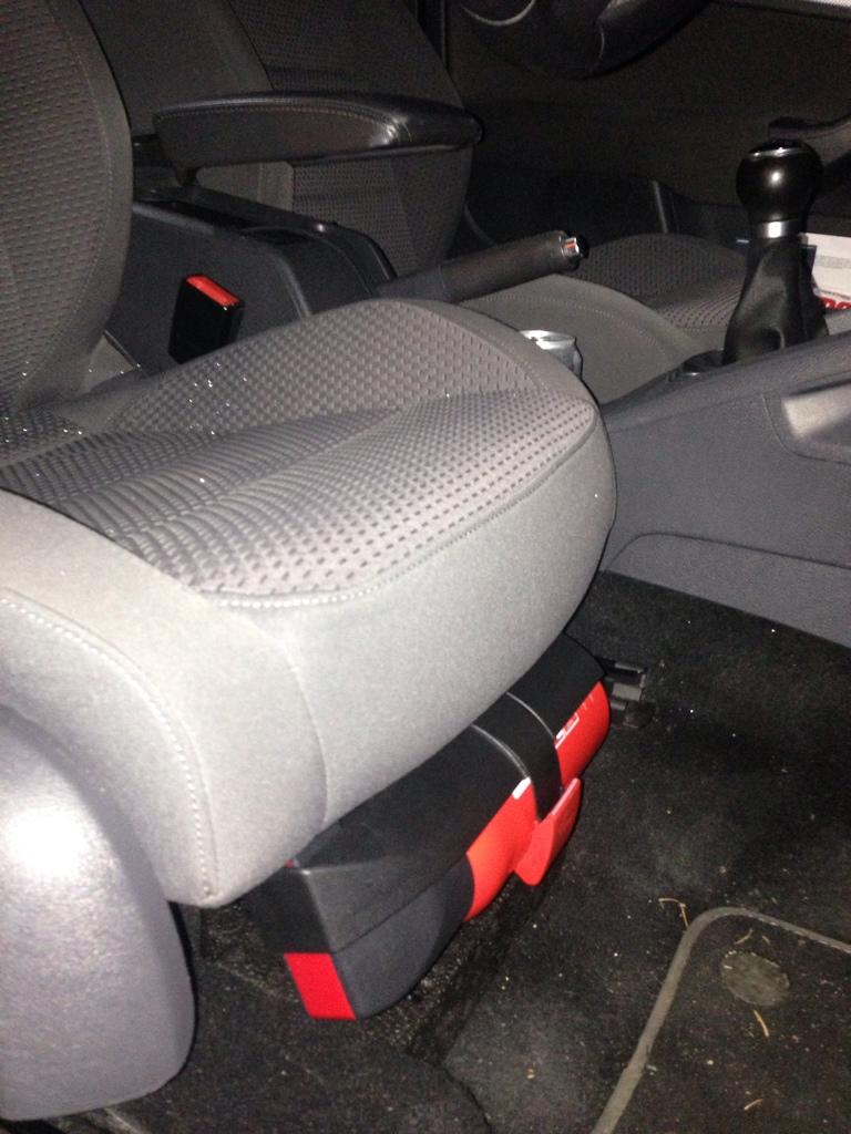

and a pic.

Probably no room under my Recaro seats, especially as mine are slammed down to their lowest position. But I guess that bracket could be adapted to fit elsewhere?

wouldnt be able to comment, but its a good steel bracket so could be adaptable, ive seen a few folk use the safety kit fasteners in the boot to stow a fire extinguisher.
Also, i have the bluetooth module and there is still a bit of clearance.
