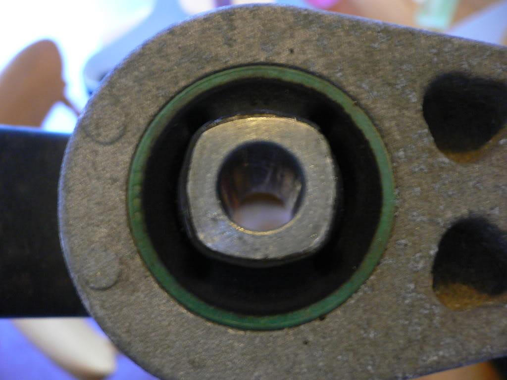

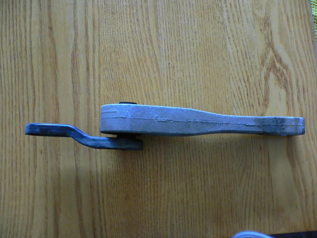

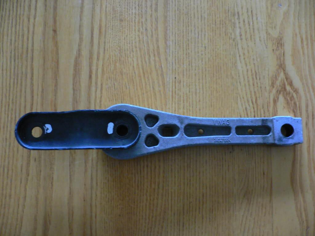

As you can see, the joint has a poly bush and is a lot tighter (for want of a better word) so the bush is thinner. The OEM one has a very thick, voided bush, so you can see it'll distort like hell once some power is put through it...Hell, I can bend it a considerable amount by hand, so God knows what an engine will do to it?
