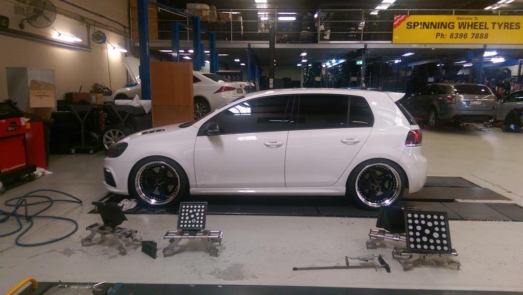

Many thanks to Fulvio at Spinning Wheel and Tyres, and thanks to everyone I've spoken to regarding wheels, fitment, guards, wider guards, camber, etc. Ray, Bima, Thomas, Paul (Dub), Nat (dev17a) and Alan (granturismo).

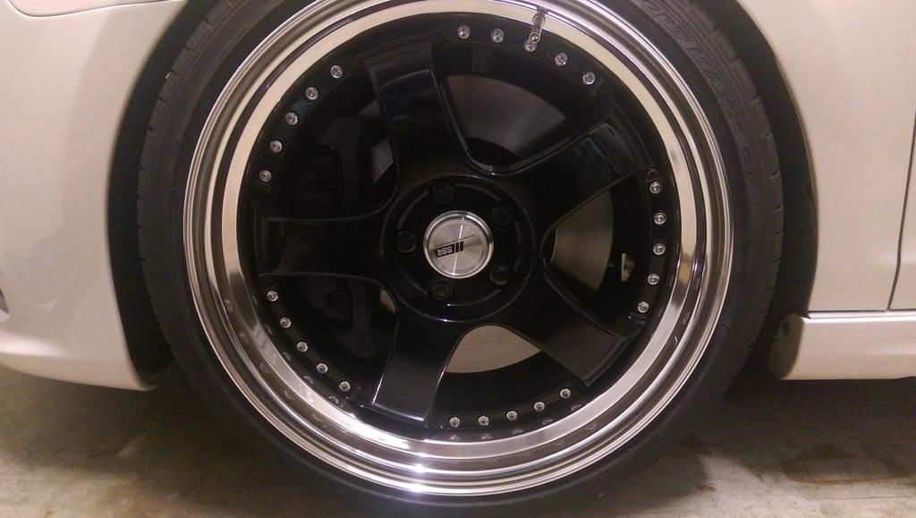

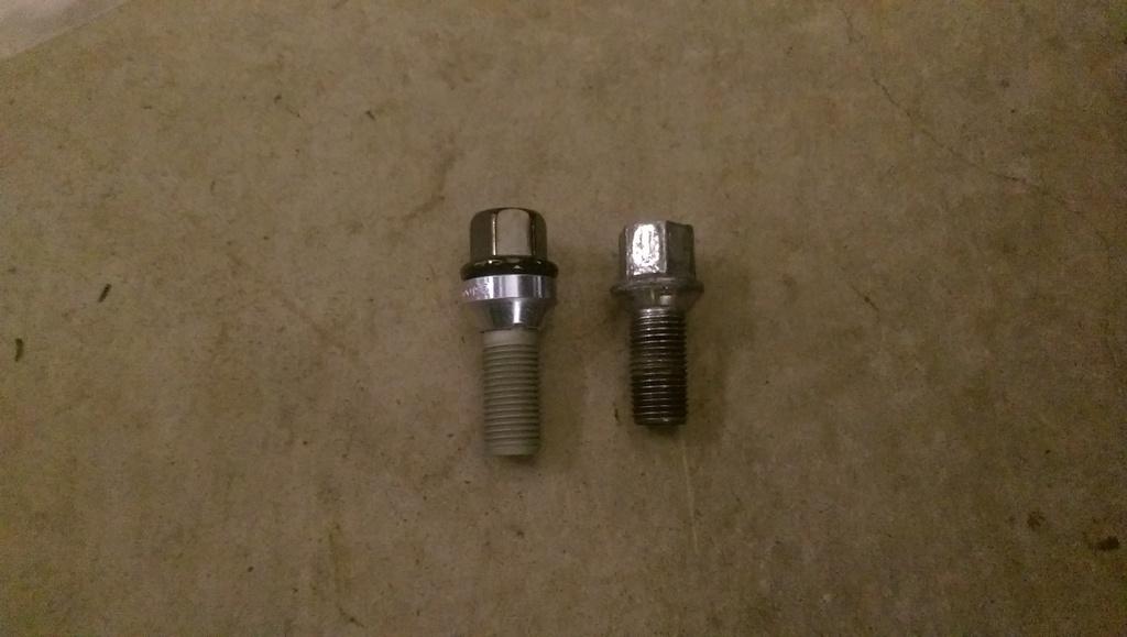

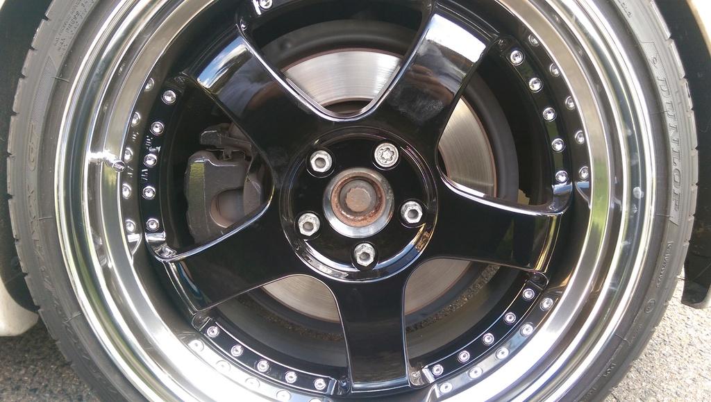

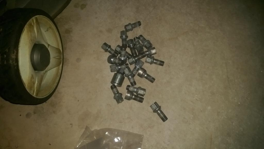

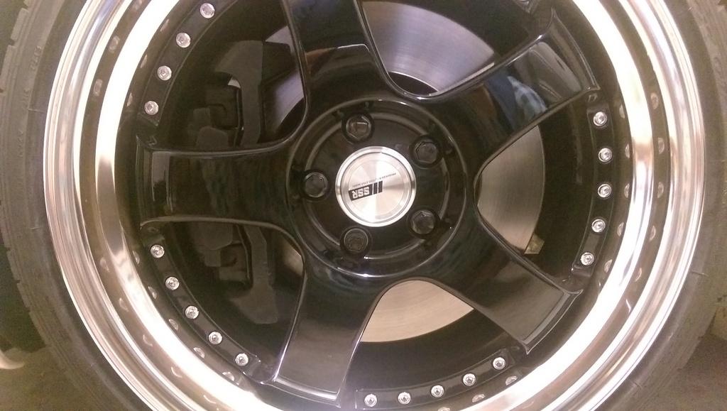

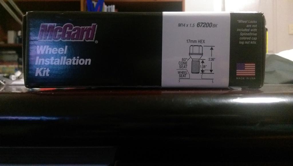

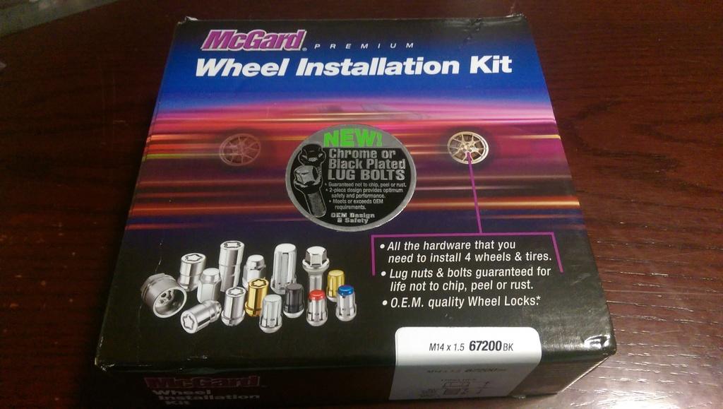

So when I (finally) got the wheels put on, there was one little thing I forgot to think about and that was the lug bolts. I was told that the SSR Professors needed V-taper (conical) lug bolts whereas the OEM VW/Audi's are Ball seat. I could use them for the time being but it meant that though the OEM lug bolts were keeping the wheels on the hub, it wasn't secure as they were ball seat lug bolts.
So I decided to get some McGard Wheel bolts (Thanks again to Nat AKA dev17a). The McGard bolts are 28mm shank length, slightly longer than the OEM 26mm, and I opted for the black plated heads. They come in either Chrome or Black.
McGard Wheel bolts with Black plated heads.
M14x1.5, 17mm hex like the OEM, 28mm shank length
Out with the old...
...and in the with the new
V-Taper (conical) vs Ball seat and difference in length of the shank
In storage...

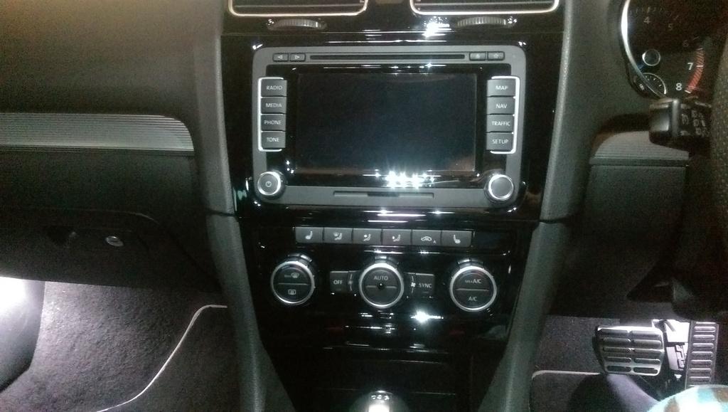

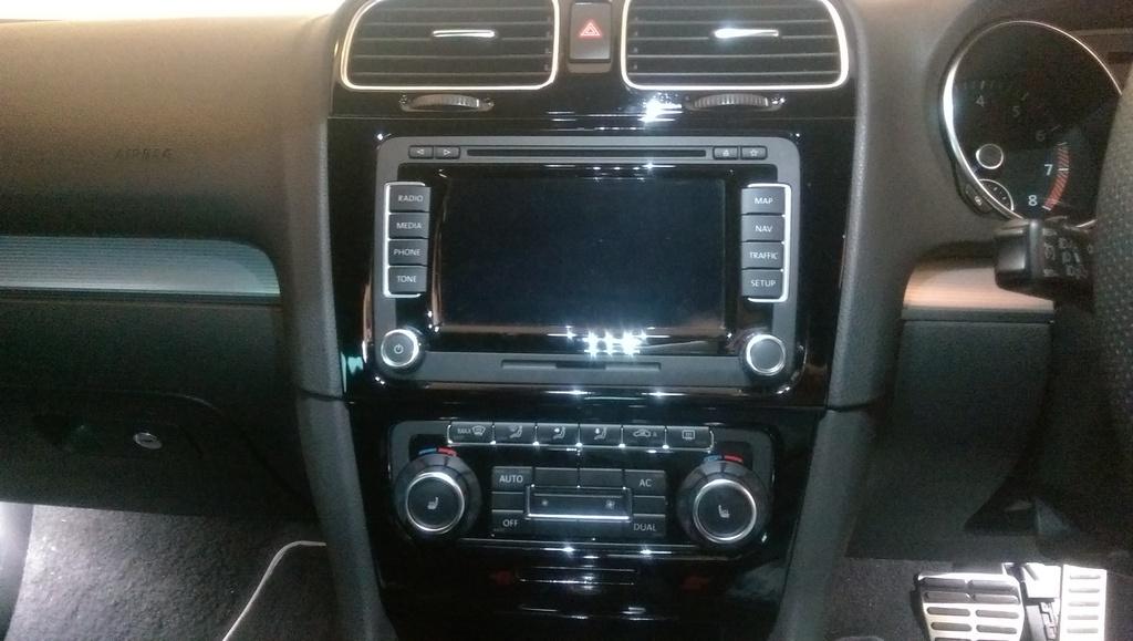

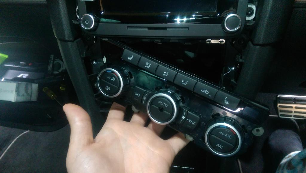

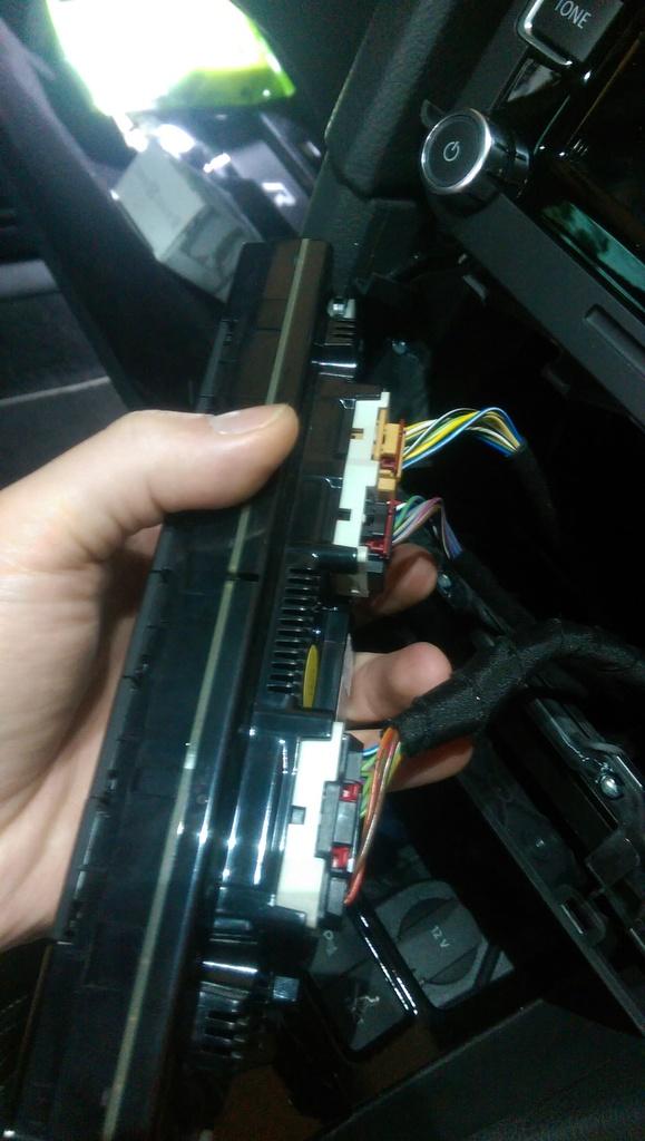

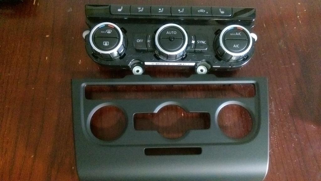

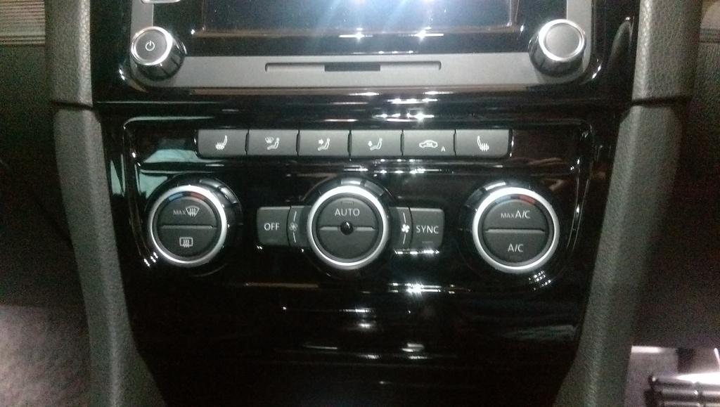

Finally fitted the MK7 Climatronic unit. With my trim pieces being painted in Gloss Black, I had to get the trim surround of the MK7 climatronic unit painted as well to match. Greg at Baileys Smash opposite Exoticars got it done for me.
Install was very easy. Remove the trim, remove old climatronic unit, install new one, check to see if it all works, put the trims back in place, done!
Before :
In progress :
After :
Small cosmetic update but makes it look a little neater. :)

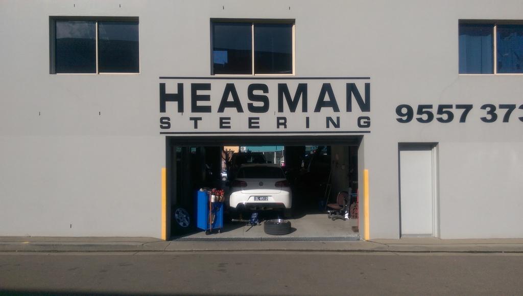

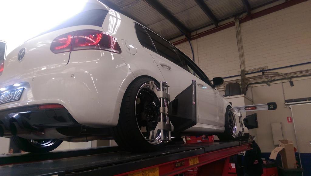

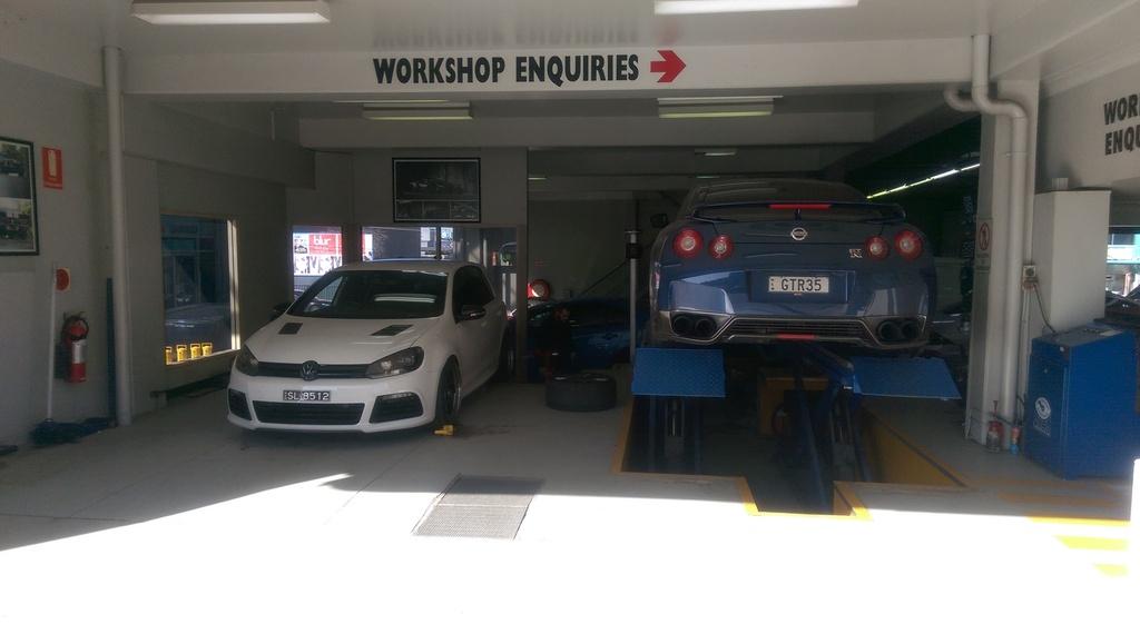

Recently made a trip to Heasmans Steering to get my coilover and camber sorted. I wanted the rear raised a touch and the camber to be even on all sides (the left had more camber dialled in than the right for whatever reason). The left rear was a touch lower than the other side and every time there was a big dip in the road, the wheel would scrub on the passenger side only.
Doug measured up the coilovers and firstly made sure that all 4 corners were set at the same height. Then, he dialled in around -3 camber for the rear and -1.5 at the front. Now, no more scrub issues!
This sweet R35 GTR was getting some suspension work done too...
Heasmans always seems to have nice cars such as this Camaro and a Shelby Cobra putting out 1000hp! You can also see peeking out a Fiat Abarth 695 SS peeking out from the side

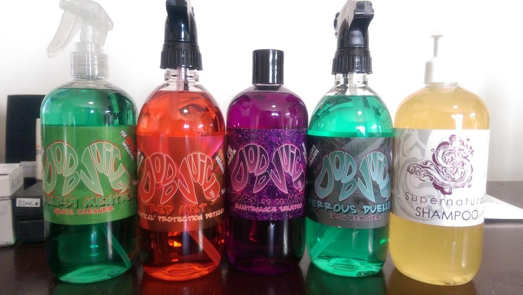

With the suspension finally being sorted and no scrubs (haha TLC >D), decided to give the car a wash. I was running low on car shampoo and other car wash products so I recently went a bit nuts and bought a bunch of products by DodoJuice from CarCareProducts.
Gave the car a wash using the DodoJuice "Born to be Mild" shampoo. I used to use Duragloss before this but I found this to be just as good. Very strong concentrate.

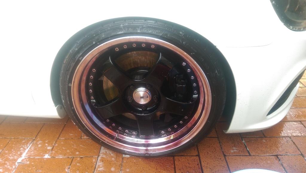

Also used the DodoJuice "Ferrous Dueller" and sprayed it on the wheels. This is meant to lift of any iron or brake dust deposits and it will turn purple after about five minutes of spraying as it dissolves the iron fallout/brake dust. It was really quick and easy. Just spray, wait 5-10 minutes for it to do its thing and then rinse off.
After drying the car, I applied the DodoJuice "Red Mist" detailer, which is a synthetic spray sealant meant to give existing wax layers an extra layer of protection as well as improving the water beading characteristics. Also used the DodoJuice "Clearly Menthol" glass cleaner a go. Streak free and smells quite nice. Very impressed with the DodoJuice range.
