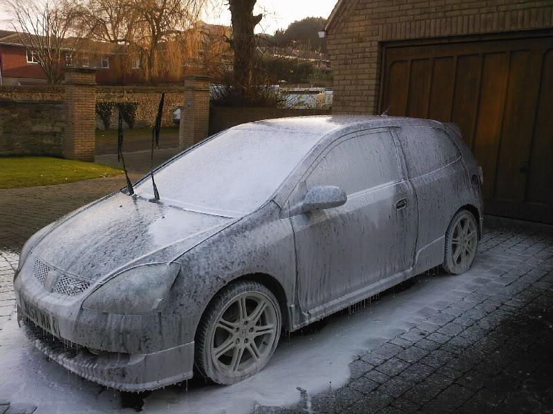

Here is my car which has just been foamed using a karcher pressure washer and foam gun along with super snow foam:

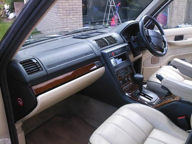

Interior
This is straight forward really. I use a trim restorer to make the plastic look new and regularly hoover. Leather condition the seats (by hand for the best results, microfibres will scratch the protective layer off). I do this once every two weeks. This will prevent the leather from cracking.

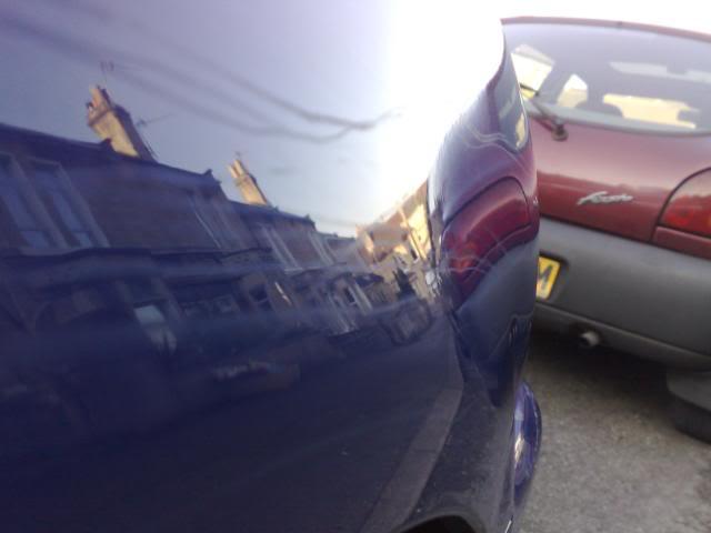

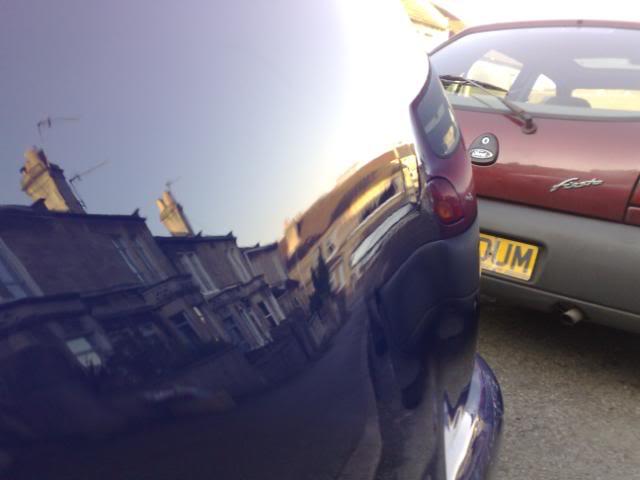

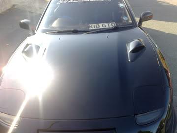

Heres a few pics of some cars i have done (so you know i have a good idea of what im talking about )
A GTO i PC'd
Before
After

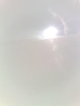

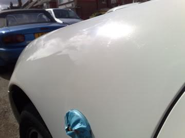

Some work i did on a mazda (white is great to turn round!)
The right side has been PC'd
You can see from another angle (the left side has been PC'd)
On the wing you can see the near part has yet to be PC'd

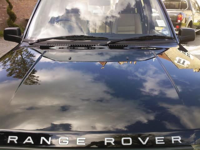

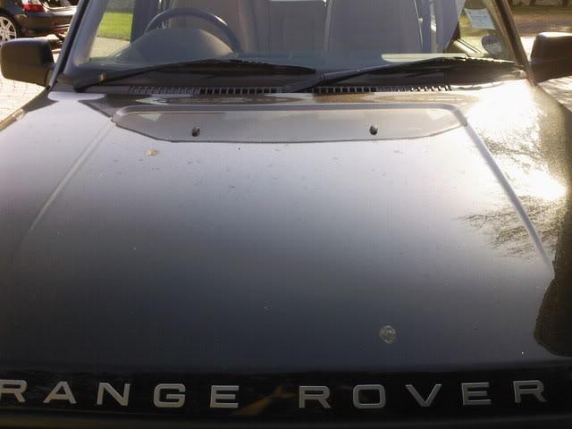

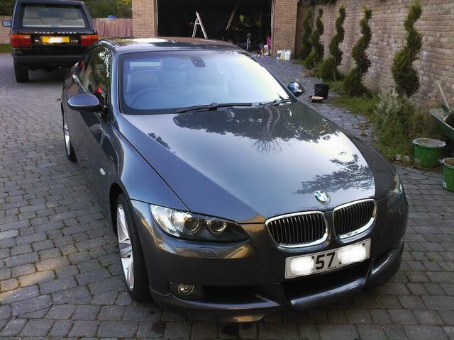

A few others i have done:
I have also worked on:
BMW 325ci
Porsche 911
Mercedes CLK
Citroen Saxo

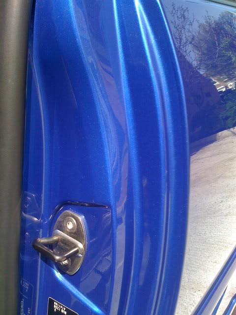

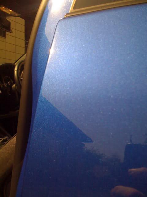

Here is some pics of clearkote red moose glaze with swissvax onyx wax
