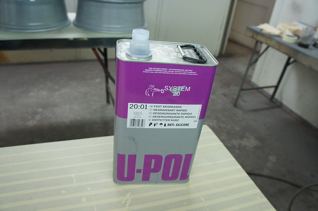

Next the wheels were wiped down with U-Pol Degreaser to ensure that they are completely clean:
DSC01123 by RussZS, on Flickr
DSC01124 by RussZS, on Flickr
DSC01126 by RussZS, on Flickr

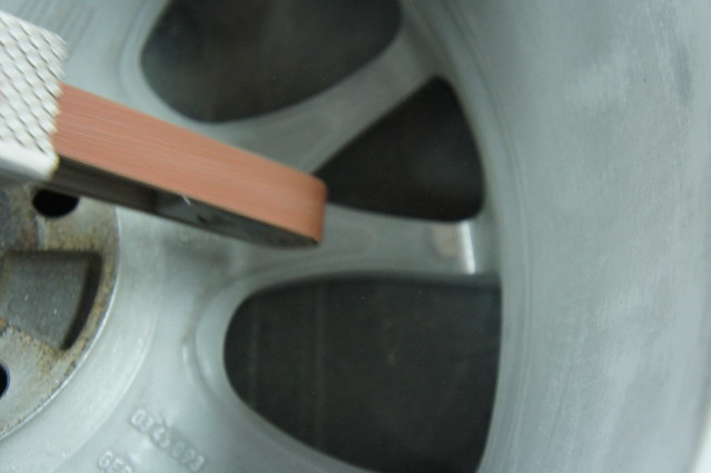

Venom asked about this tool - some more pics for you, sorry for the delay...
DSC01153 by RussZS, on Flickr
DSC01154 by RussZS, on Flickr

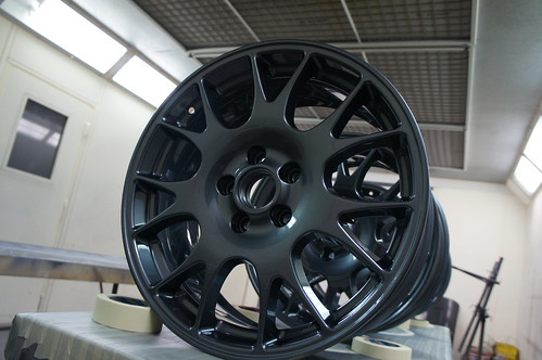

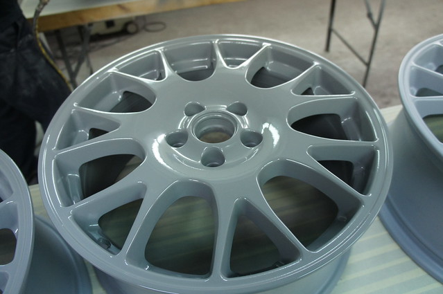

Also, alongside a number of other sets of wheels, I managed to get some pics of the process for these Evo9 wheels - the brief of which was to match the OEM finish as closely as possible:
This set was chemically stripped by a local company then work began at Spray Station by priming:
DSC01479 by RussZS, on Flickr
DSC01481 by RussZS, on Flickr
Again they were fully wet sanded to achieve the best possible finish:
DSC01490 by RussZS, on Flickr
Then wiped down with UPOL to prepare the surface for painting:
DSC01493 by RussZS, on Flickr
Bright metallic silver was used on these to match the original colour:
DSC01494 by RussZS, on Flickr
First coat, no lacquer yet:
DSC01495 by RussZS, on Flickr
DSC01496 by RussZS, on Flickr
Final pics:
DSC01499 by RussZS, on Flickr
DSC01501 by RussZS, on Flickr
DSC01502 by RussZS, on Flickr
DSC01505 by RussZS, on Flickr
DSC01507 by RussZS, on Flickr
DSC01512 by RussZS, on Flickr
DSC01513 by RussZS, on Flickr
I'll add further write ups as we do interesting wheels and colours.  Gloss black next...
