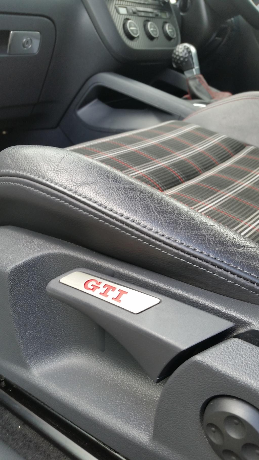

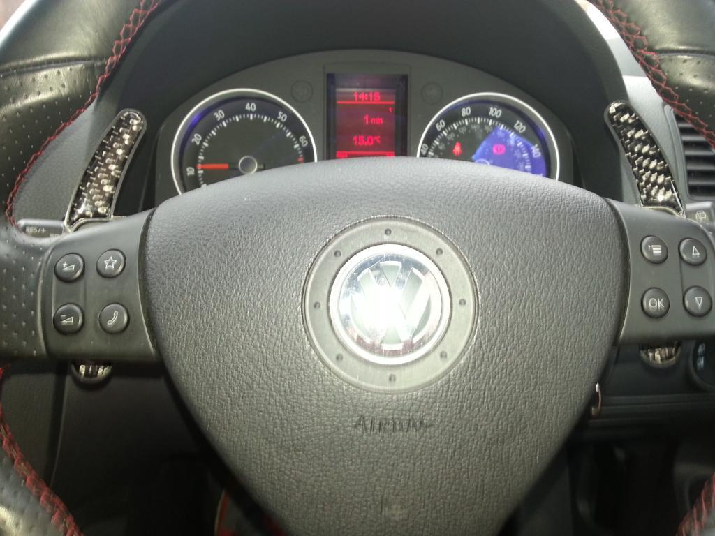

First thing to be done was carbon paddle shifts and seat inserts

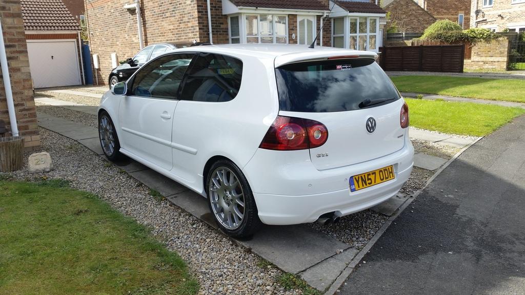

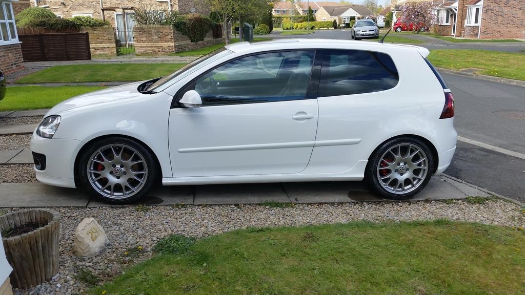

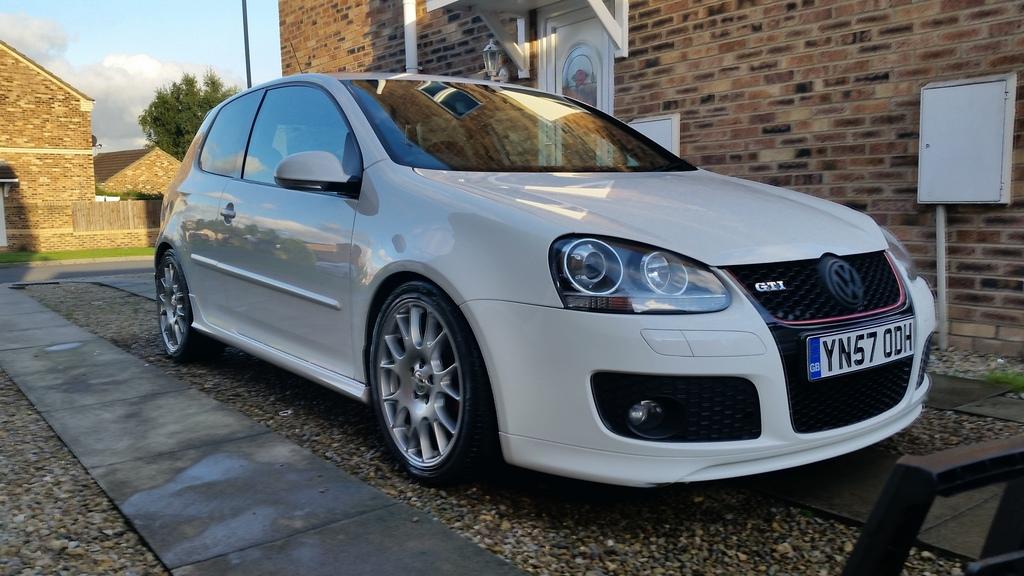

Then she was lowered

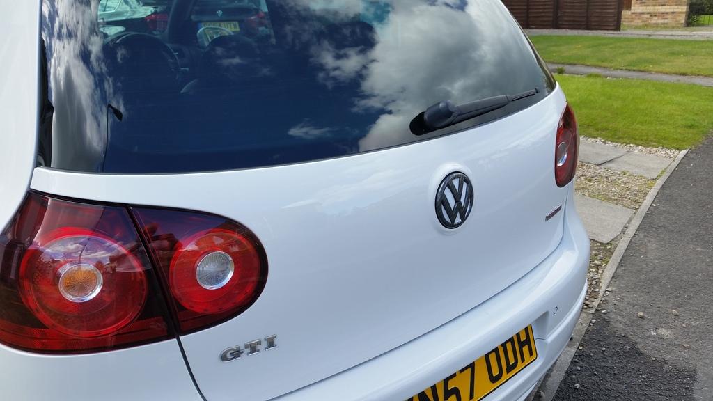

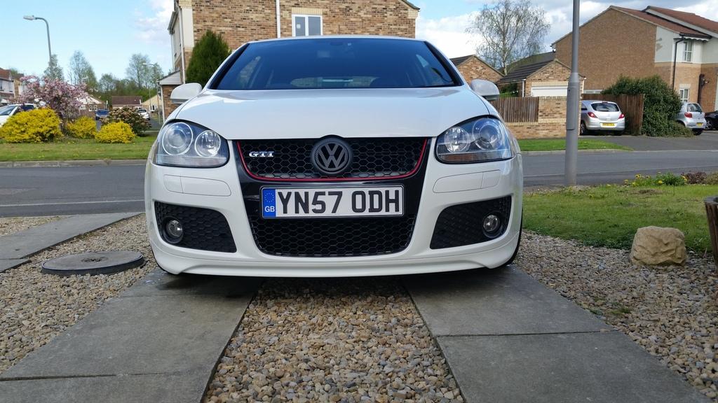

I then wrapped the badges in carbon, but i ended up ordering a faux carbon rear badge and colour coded the boot mechanism, I was going to do it properly but the boot trim scared me off so I cheated and used sticker inserts. They dont match, probably end up changing the front at a later date.

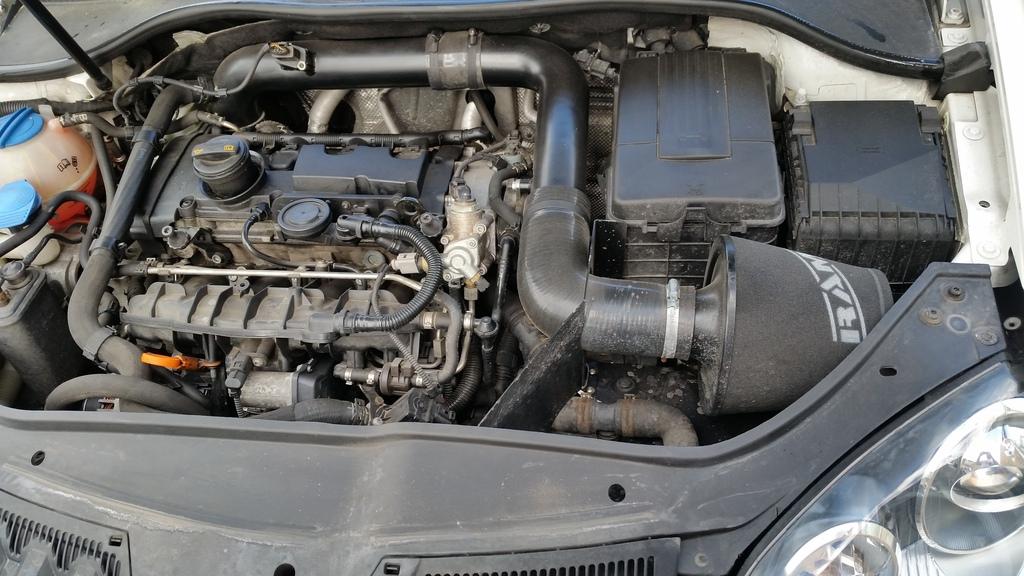

Next up was an intake, I went for the ram air option because of some positive reviews and half the price of others out there. (Please excuse the dirty engine bay, its on the to-do list.)

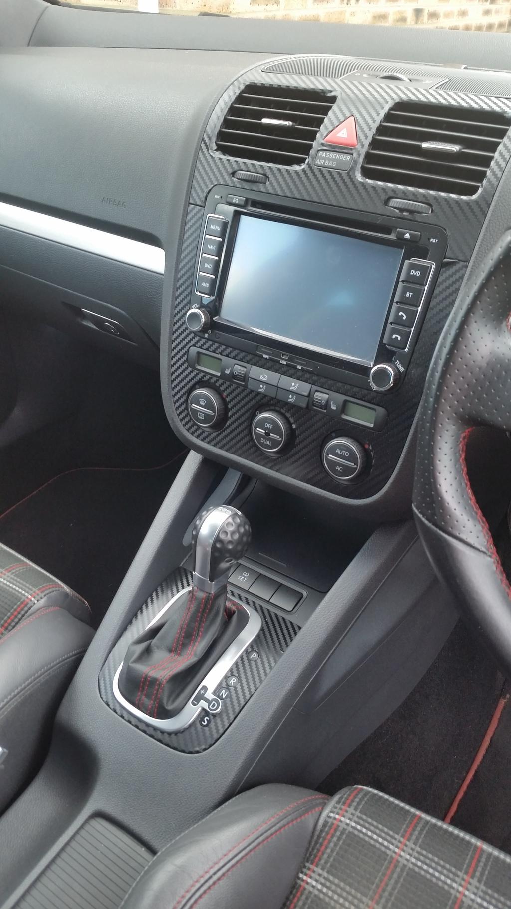

The RCD300 was pissing me off so I was on the look out for a new headunit, I decided to ignore the RNS510 because its quite expensive to get everything I wanted and from what Ive read can be a bit of a headache. I found a chinese copy used on gumtree for £100, now for £100 you cant complain really, does everything I wanted. You can probably see a recurring theme here of me being a cheapskate  :P
At the same time I also got the carbon wrap out again and done the centre dash and the DSG surround. I should do it again really as its a bit messy.

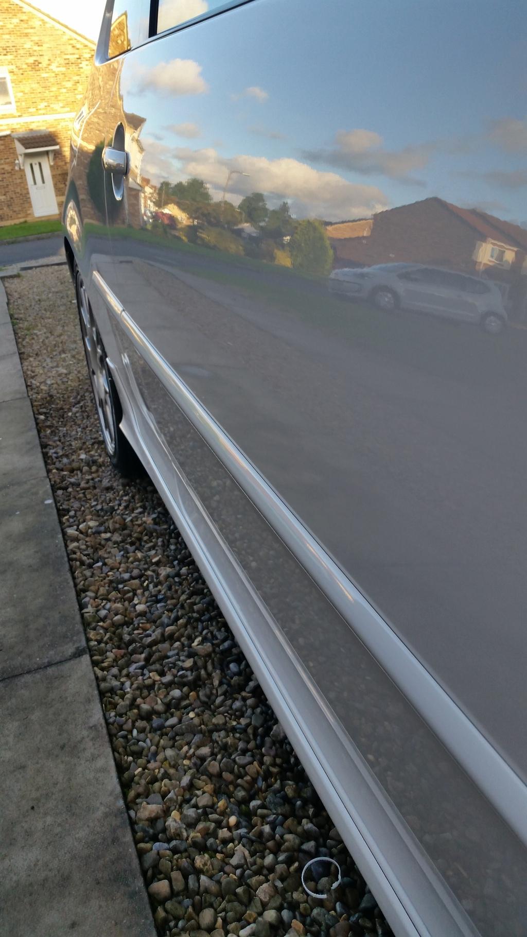

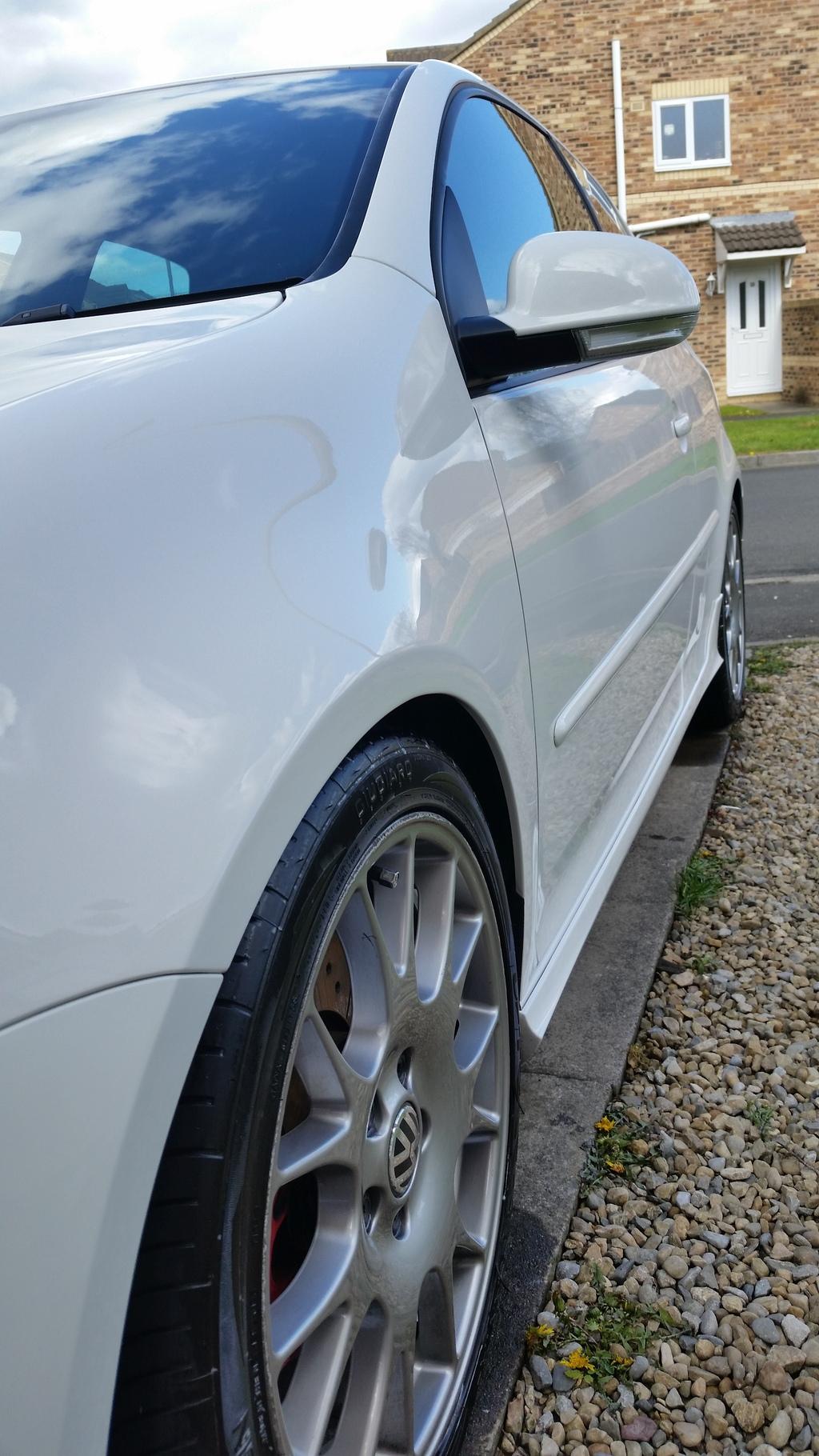

So thats it up to date I think so Ill leave you with a coupe of photos of todays whoring session.

How did you get the DSG surround off? mine could do with a wrap as its scratched
AndyBrown
There's a guide kicking about somewhere off the top of my head lift up the ash tray and there's 2 screws, pull the leather part up and slide it over the knob.
There's a clip connected to the prnds lights aswell you need to undo.
Double check that tho before you do anything in case I'm wrong or missed something off.

how does the ram air intake sound? any whistle when you put the boot down? just ordered one for my s3
AndyBrown
I like the noise, wouldn't describe it as a whistle.
Can really hear it go tho with a nice pshhh when you lift off.
I'll make a video tomorrow for you if I remember.

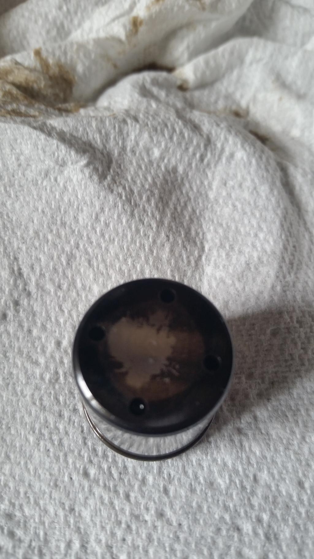

Not a major update but changed the cam follower this fine bank holiday monday.
This is the old one after 71k

Cracking car mate. I have the ramair intake. See the pipe below the intake that is shown with 2 clips on pic, watch the heatsheild doesn't cut in to that pipe mine was starting to but i got some of this.

Awesome, thanks for that, Ill get it ordered now.
Ive put a tie wrap round the heat shield on to that pipe just to hold it off as a quick fix but.
The edges arent the friendliest on that heat shield like are they.

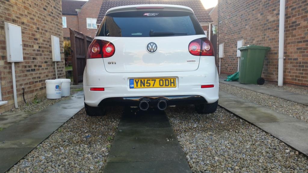

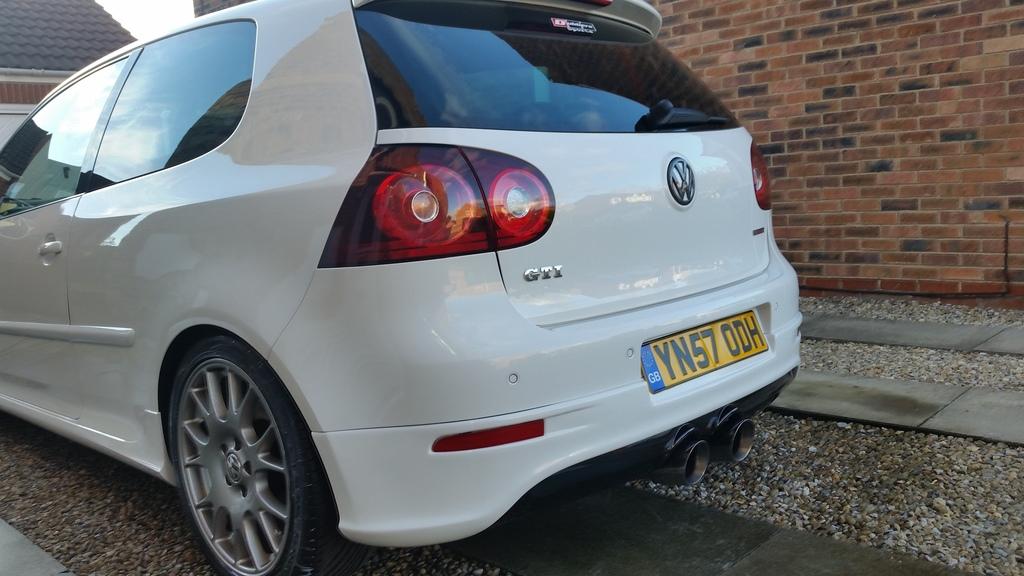

I've now got a 3" turbo decat r32 style from EMS Performance, it's only got one resonator on it and it's loud, like really loud especially on full chat.
It came from a cupra which I'm presuming the back bumper comes out further than the r32 bumper as the tips are hanging out a good few inch.
Need to get the tips cut and re welded to suit the r32 bumper which will need spraying aswell.

Heres the fnished article, had the bumper sprayed last week after a 6 week wait.
Gave her a bath tonight so got a photo of the rear.
