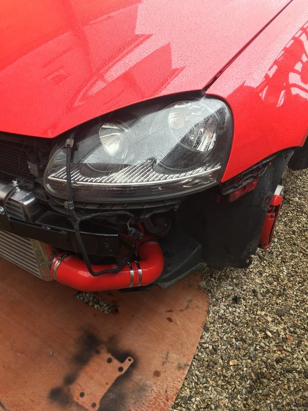

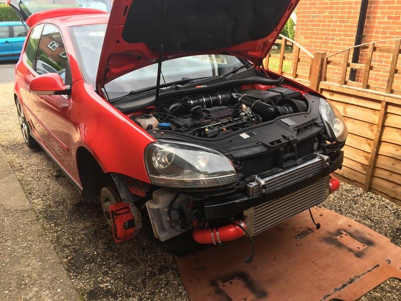

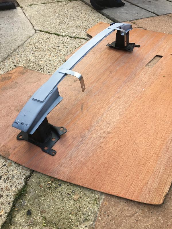

Finished off the fmic yesterday, all went back together pretty well so I had it complete a day sooner than I expected. Just waiting on some open fog light grilles to turn up now

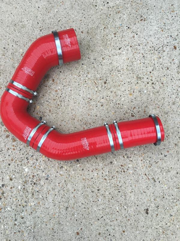

Nice work Stu how much was the pipework and welly is about 85 pounds ?
how long did it take to fit ?

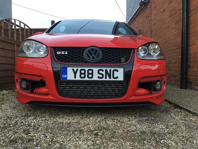

Nice job on the intercooler. Get those fog grilles in asap though, looks a bit pikey without them!

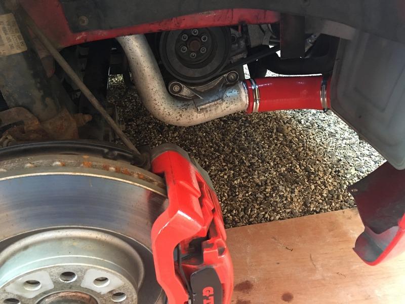

Pete - All in it cost me £241. That includes pipes, i/c, connectors etc. If you have the means of doing it yourself it's a cheap mod for what it is. It took me a couple of days if I was on it all day, mine was split up into a few evenings here and there.
Thanks AJP, completely agree it looks awful at the moment! I was worried from previous experience about how much of a pain the grilles are to get out from the front so I decided to get them off whilst I could get behind them. Loba pump and exhaust is next on the list after the clutch.

The bracket on the crash bar to the cooler was something I bent up from 3mm mild steel and welded on.
