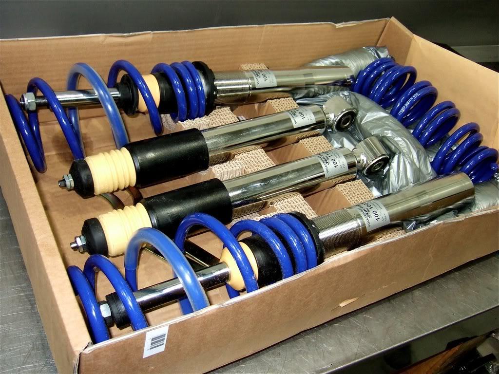

Obviously Bilstein are probably the best there is but are expensive and have more adjustability than I need as I don't do regular track days. KW's are probably the next best and having worked with Mark Farmer at VWRacing/RacingLine for my Quaife diff, it was a no-brainer to go to VWR. They run both the Volkswagen Racing Cup and Formula Ford competitions and probably have more experience of the Mk5 platform than anyone else in the UK. They also have close working relationships with VW in Germany.
If I needed yet more reasons to use VWR, they have a technical partnership with KW in Germany - They are twintube which is unusual for a 'street' damper but allows better adjustments. The valving and setting parameters on mine are as on the race cars. They are adjustable but to settings exclusive to VWR as a result of extensive testing on their race cars. My spring rating is exclusive too (hence the different colour). This particular version of the V3 has been produced exclusively for VWR and is designed for 'Fast Road' use.

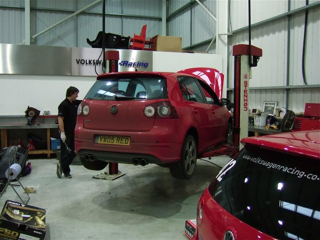

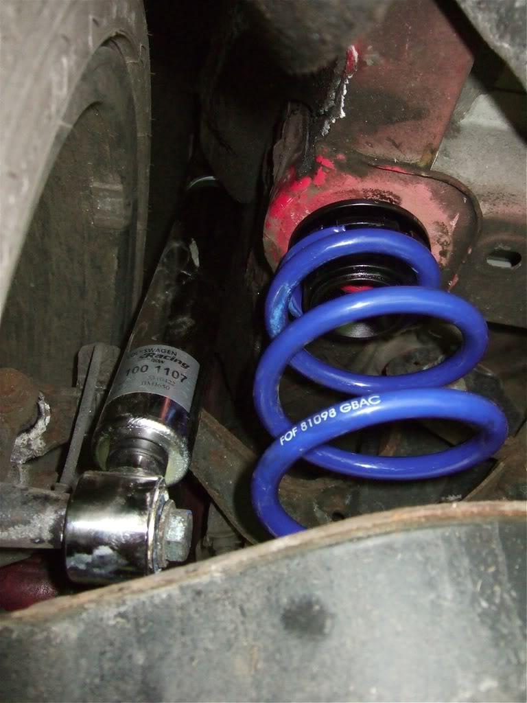

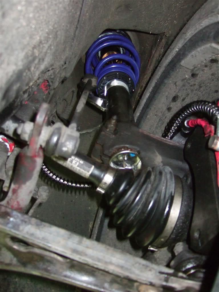

^ On arrival it didn't take long to get working on my car ^
My existing suspension was pretty well 'stuck on'! Simon did most of the installation - He's a real enthusiast and is currently building a Mk2 GTI with a VR6 engine.
^ Simon was constantly smiling while working! ^
It made sense to fit my Whiteline AntiLift Kit in the same workshop session.
As VWR's experience is particularly race focussed, it results in a number of practices which have very positive advantages. One of them is assembling components with lots of appropriate grease so that they can be easily replaced in the future. Another is their eagle-eye for spotting wear and the condition of components. The racing environment puts everything under extreme stresses and it's important to maintain everything in best working condition.
Mark anchored my KoniFSD's to the bench and discovered that he could compress the hydraulics by hand! He also pointed out evidence of leakage and suggested the seals had failed. Good news because it means that Koni will doubtless confirm the same and replace them with new ones without fuss.

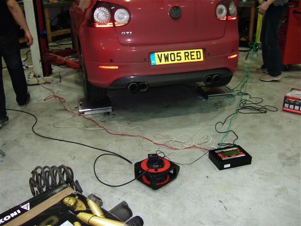

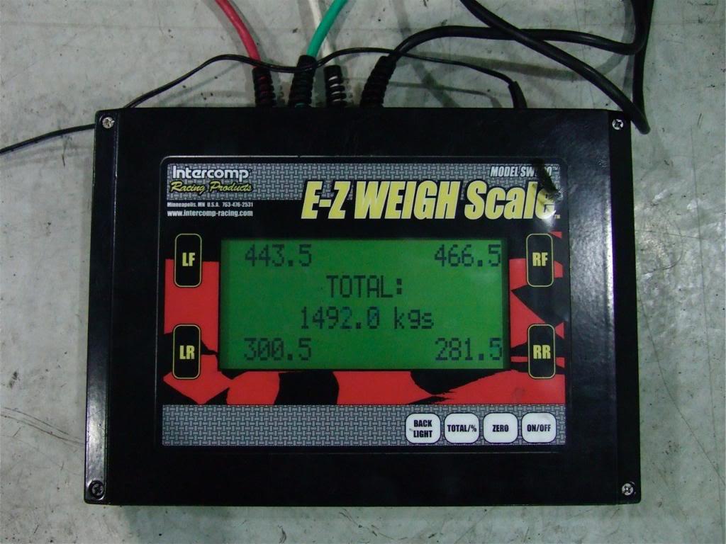

After the installation was done, it was time for Mark to apply his expertise in setting up the suspension. This involved alignment and corner-weighting - So it was string and bags of sugar (very BIALI-style). First the corner weighting which involves a weight scale under each wheel and a digital readout of the weight at each corner.
^ The corner-weights readout before adjustments were made ^
Mark then asked me to sit in the car to add my weight and also noted that there was three-quarters of a tank of fuel.
He then adjusted my suspension settings to take account of this info.

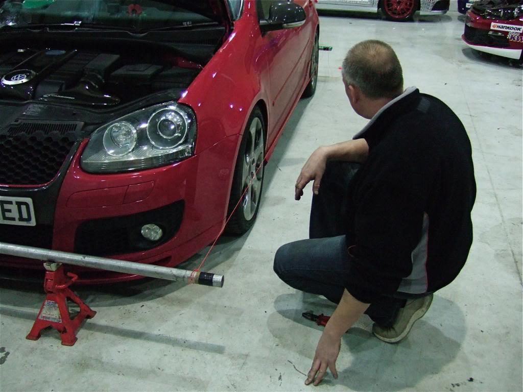

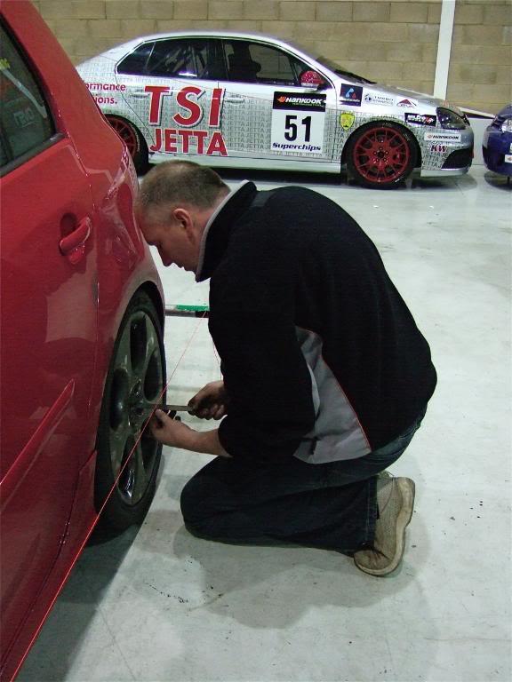

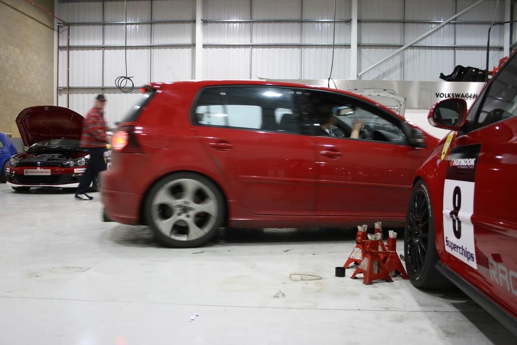

Next came the piece of string. I had asked Mark if they used a laser alignment rig such as BeissBarth and he said no, he used string, which is the 'old school' method. He pointed out that at a race you couldn't easily carry around a big laser rig.
Then it was time to take the car out on the road to settle the suspension before checking alignment again.
^ However, I didn't expect they would race my car around the workshop! ^
^ But now I know why all those other race cars were there ^ [Yes, that Beetle is what you think it is!]
Then it was my turn to take my car out and check it was alright. Fortunately Milton Keynes has lots of roundabouts and so I was able to go round a few - Some I did several times at once! The road was greasy, she remained as flat as a pancake and the Quaife very quickly blew out the TC light. Nice!!!!

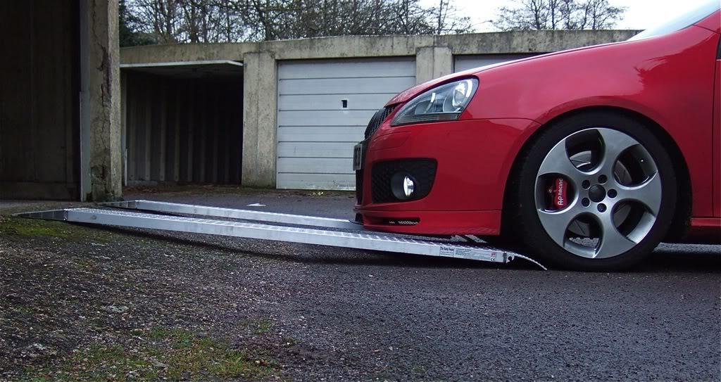

For me there aren't any except that I wouldn't dare use most indoor public carparks because of the steep ramp angle changes. But those were often dodgy in my car as it was.
For me this isn't a minus point, but some people wouldn't like the ride either as a driver or passenger - I can feel every manhole cover and cats-eye but I like the feedback and the ride isn't harsh - It's just 'nobbly'. My daughter doesn't know I've changed the suspension and has made no comment on the ride even on the rough road we live on, and she's very focussed on cars at the moment as she's learning to drive and will be taking her test soon.
Some may think that £1,550 (all inclusive) is expensive - I wouldn't! I'd say it's very good value for money and I feel both safer and happier to have had Mark's experience in setting it up. The V3's have a reputation for being tricky to get right.
My garage access is now a problem : -
But I solved that problem : -
^ A separate ramps review will follow [I'll link it from here when posted] ^

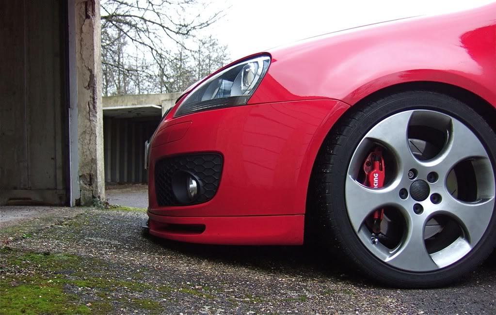

No bodyroll, extremely flatly planted, excellent feedback. The feel of the ride coupled with the sound of the Milltek add up to an even more taut and tactile driving experience. Although much less powerful than the VWR/RL 'Fast Road' demo GTI, my car now feels not that hugely different in the way that it handles, but although I'm more confident than I was in the VWR/RL car, I haven't explored its full potential but we didn't hang about! Both cars feel very controllable. But, of course, the demo GTI has extra camber and that will make a difference when pushed hard.
If I have any problems I know that VWR/RL will look after me very well. I absolutely love driving, so I love my car and I want to have the confidence of knowing it's well looked after by other enthusiasts who have the specialist skills and this also keeps me and my daughter potentially safer.
Yes, the lower look does suit the car better but it's the ride which I think is more important.

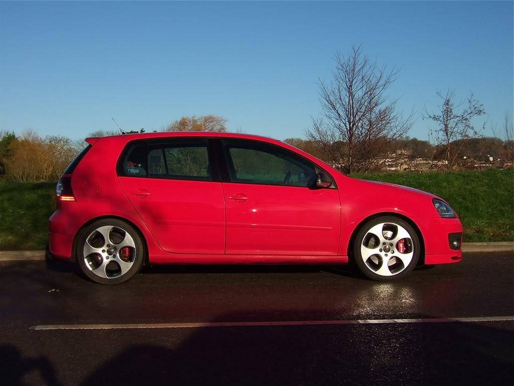

My brief to Mark had been to feel free do what he knows best but keep it practical for the road and not give me any uneven tyre wear problems and expenses. Clearly he has done exactly that and put a huge grin on my face.
I drove home the 170 miles in the dark and mostly on A-roads, so the next morning I spent out on some local B-roads which are slightly rough in places - I wasn't disappointed!
^ BEFORE ^
^ AFTER ^
