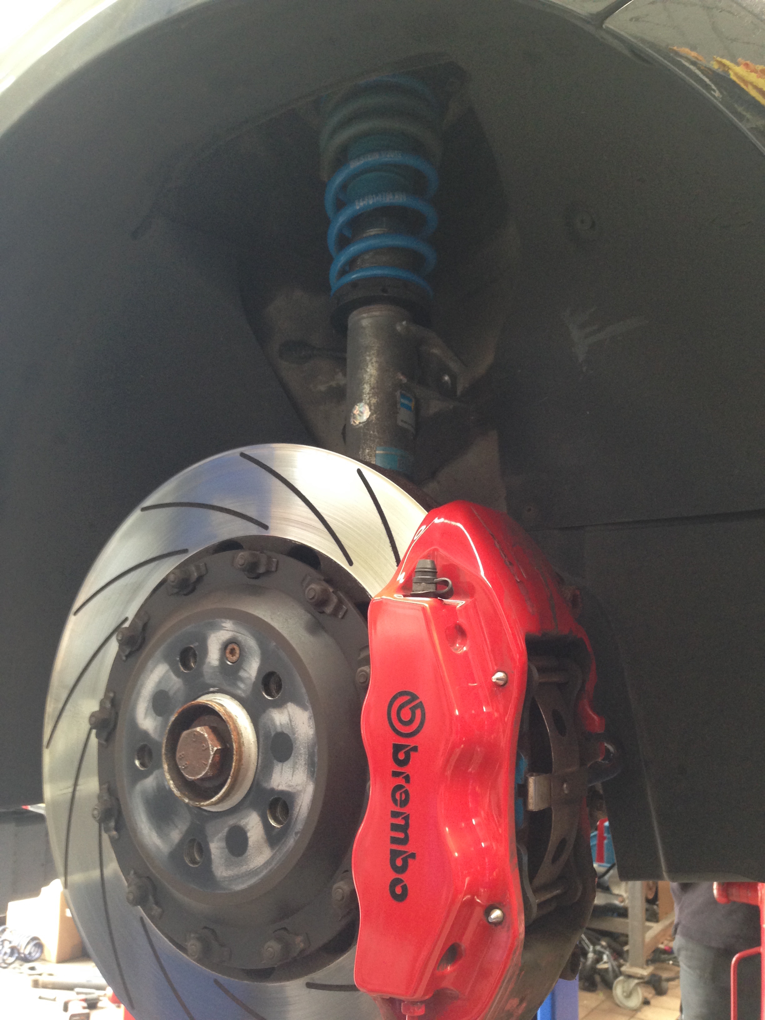

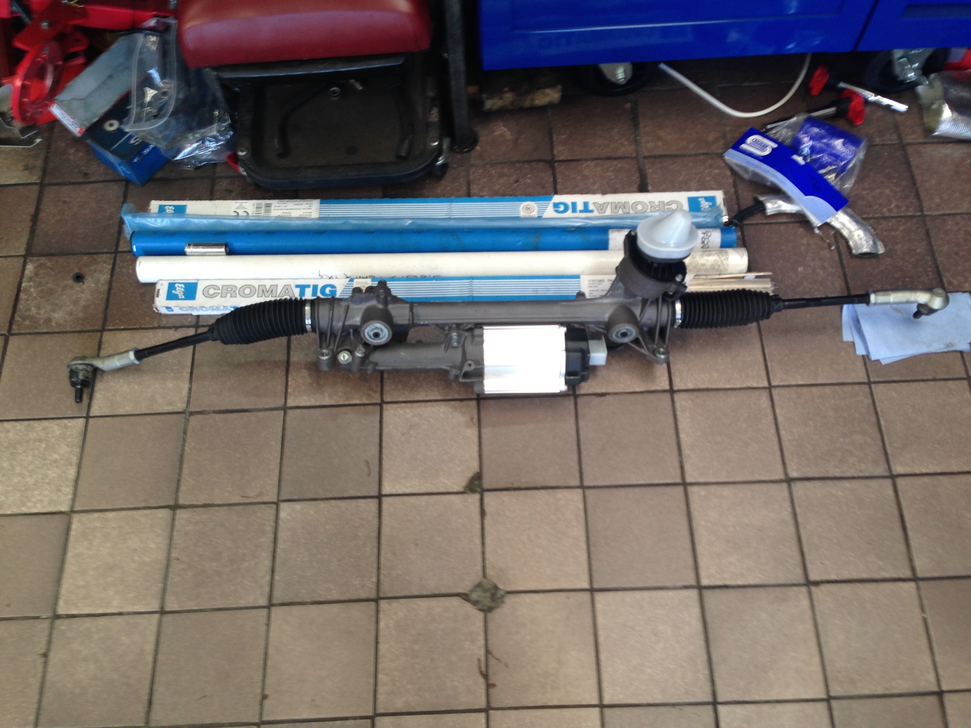

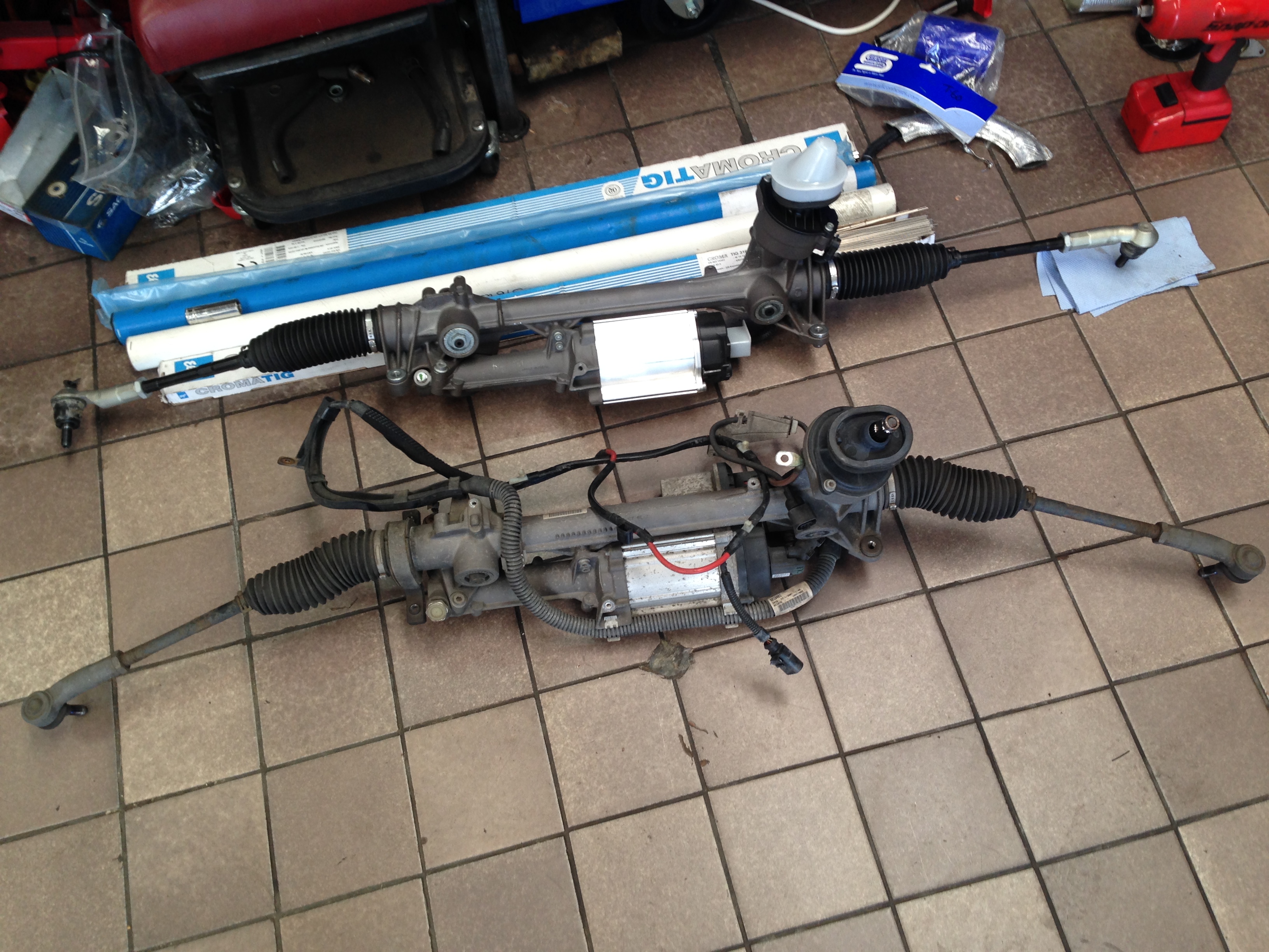

So friday saw a new steering rack go on. The groaning has gone so thats a relief.
New
PSS10s went on. Seemed to go on easily enough.

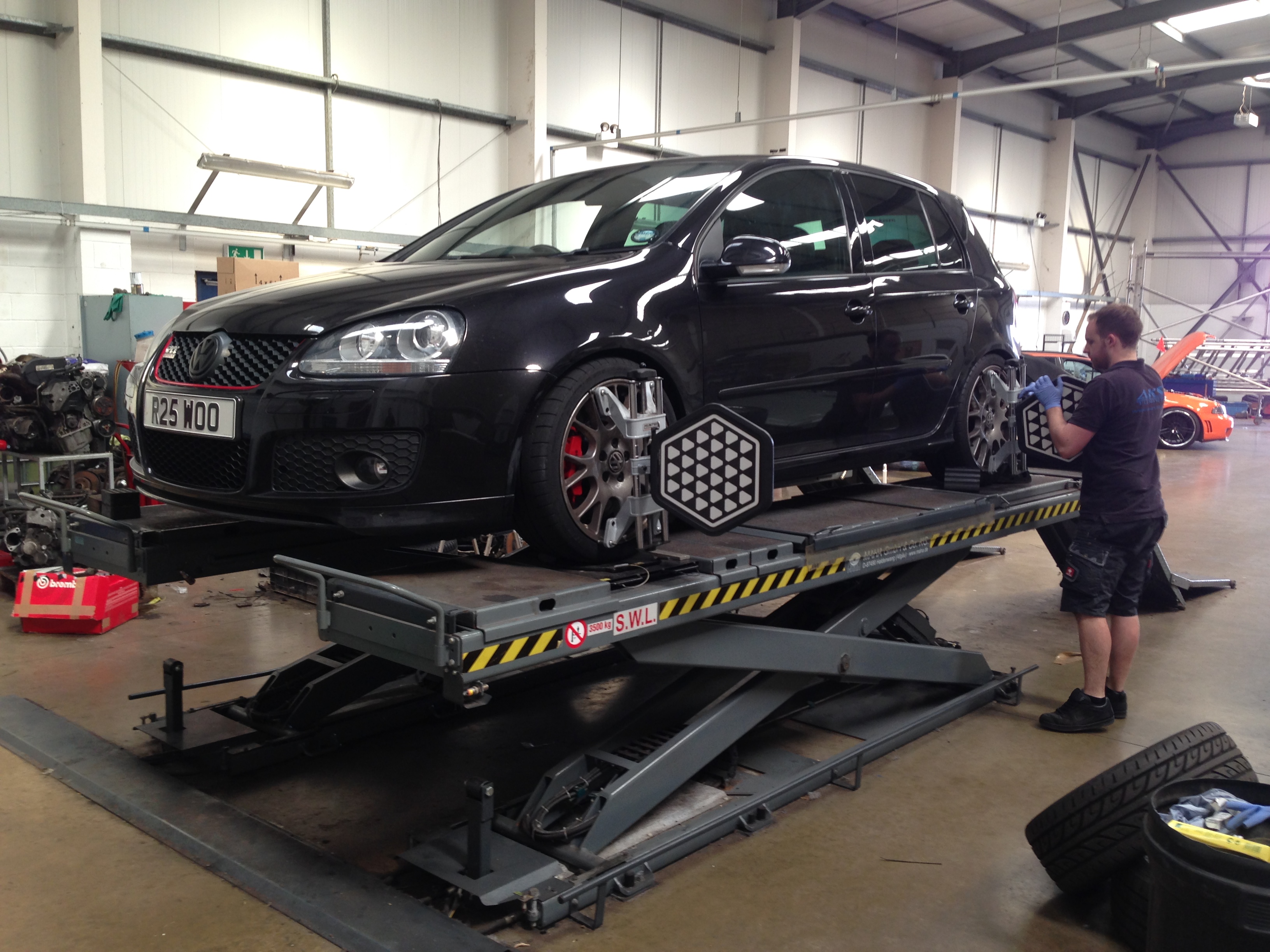

And then onto TT Shops old to do the alignment, where a problem was struck.

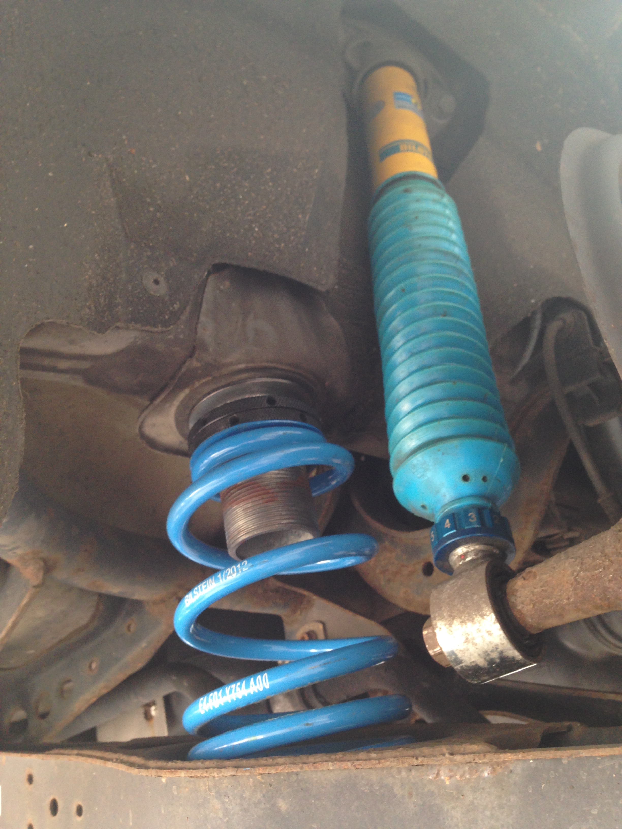

Alex has been telling me for probably about 2 years that the rear TOE adjustment bushes are seizing up, the ones on the left here...
ignore the text on the image, its wrong
Anyway... the bolt snapped so I am having superpro bushes put in with new bolts, should hopefully make all future alignment much easier
I only drove the car about 5 miles but the first impressions of the PSS10 is good. No where near as hard as I thought they would be (set to F5 R4). Damping is much much improved over the trashed OEM dampers, which all appeared to have very little in terms on compression damping.
More on the PSS10 once I've got it back
« Last Edit: August 02, 2015, 01:29:19 pm by rich83 »

isn't that eccentric bolt for toe? the camber eccentric bolt is higher up towards the front of the car
  • Posts: 13447
Re: rich83 - Edition 30
« Reply #2213 on: August 02, 2015, 01:26:00 pm »
Yes... you are correct, got it mixed up, as did the person who made that image (not mine)  :signLOL:
Offline jaffa
  • -Receive: 44
  • Posts: 753
« Reply #2214 on: August 02, 2015, 01:28:32 pm »
I'm sure iv seen that picture a couple of times on the forum  :signLOL:
so which ones are getting replaced camber or toe?
  • Posts: 13447
« Reply #2215 on: August 02, 2015, 01:29:45 pm »
The toe ones  :happy2:

What alerted you to the steering rack giving up?
Edition 30 - no. 1387
  • Posts: 13447
« Reply #2217 on: August 02, 2015, 05:11:46 pm »
Great to read - can't wait to get rid of my OEM dampers now. They are exactly as you describe... no compression...
It was making noise when steering. It wasnt 'that' bad, but it was only gonna get worse and annoyed me and made the car feel old.  :sad1:
