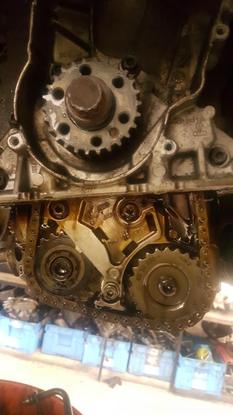

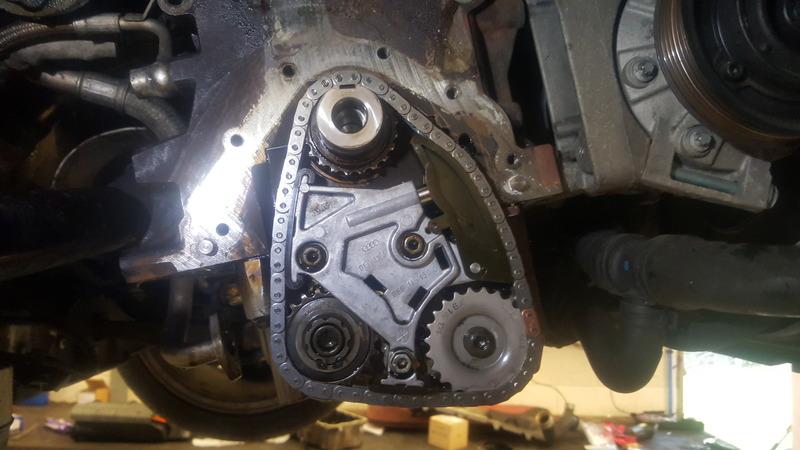

Picked my GTI up few weeks ago and have been worried about the oil pump chain as its a high miler and have seen them let go, so i replaced the chain, sprocket and tensioner
Old set up, tensioner was almost maxed out!
New tensioner hardly moved once the locking pin was removed, amazing how much slack the old chain had.

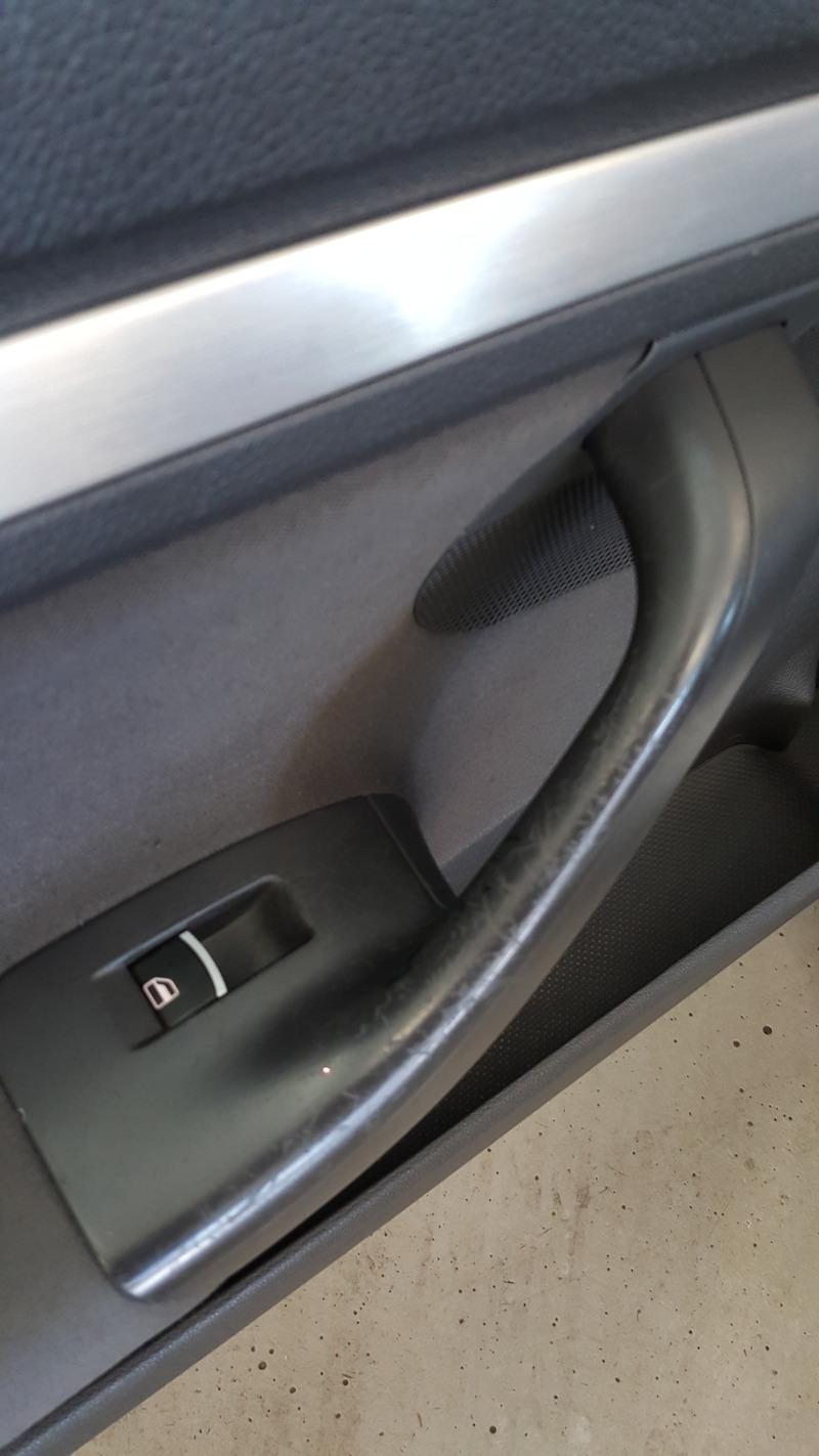

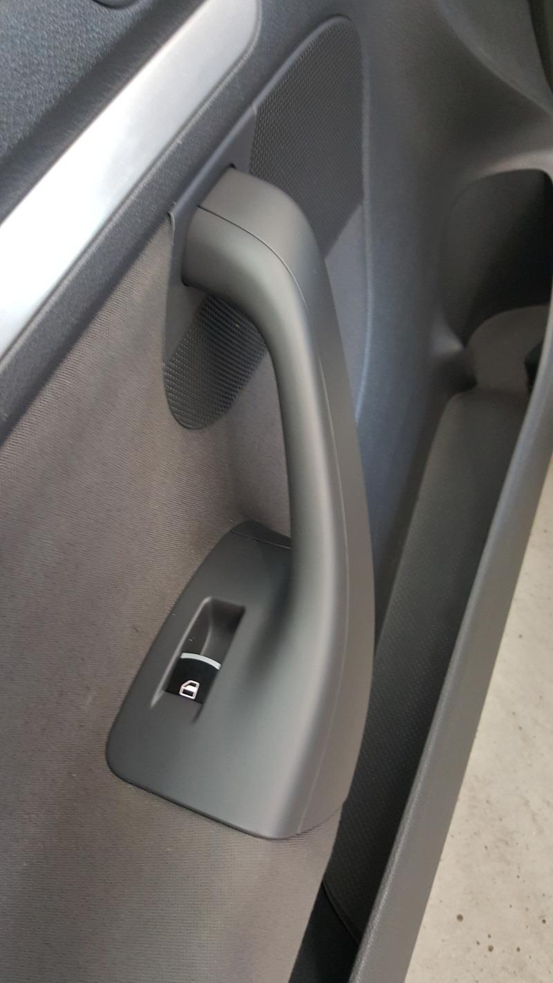

Also swapped out the old door handles as they were annoying me
Old
New

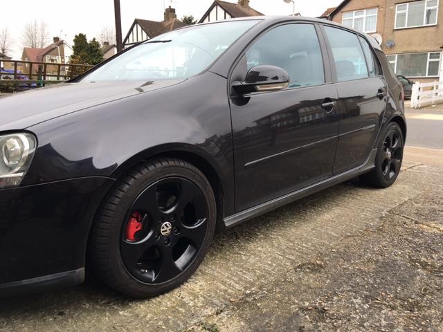

Got my refurb'd wheels today, after doing somesaults in my head about the colour, I went for the satin black, and I'm happy with the results. I wanted a siliver lip, perhaps next time.
:happy2: good job!
I'm ticking towards 97k, think this is worth doing? I'll be dropping the sump soon anyway to replace the oil pickup.
