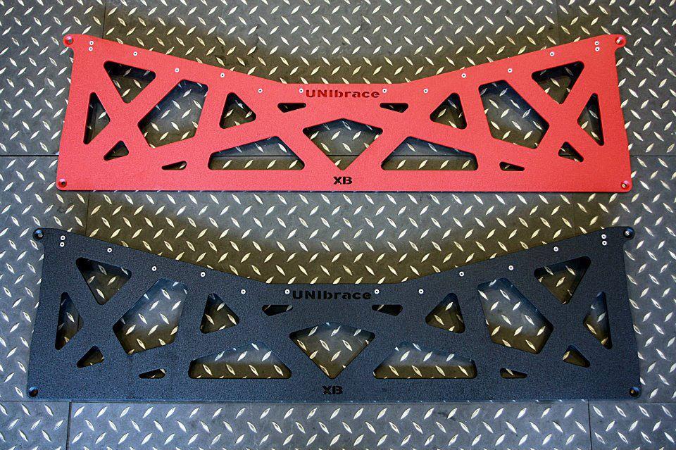

The XB is a structural cross brace added to a car to increase body rigidity and the UB is an underbody chassis stiffener, both specifically designed and produced for a variety of hatchback bodies such as VW Golfs, R32's, and some of the Audi range. The producer Bruce Levin, a professional architect and product designer, continues to develop applications for different car versions where possible. But are either of these products something you really need?

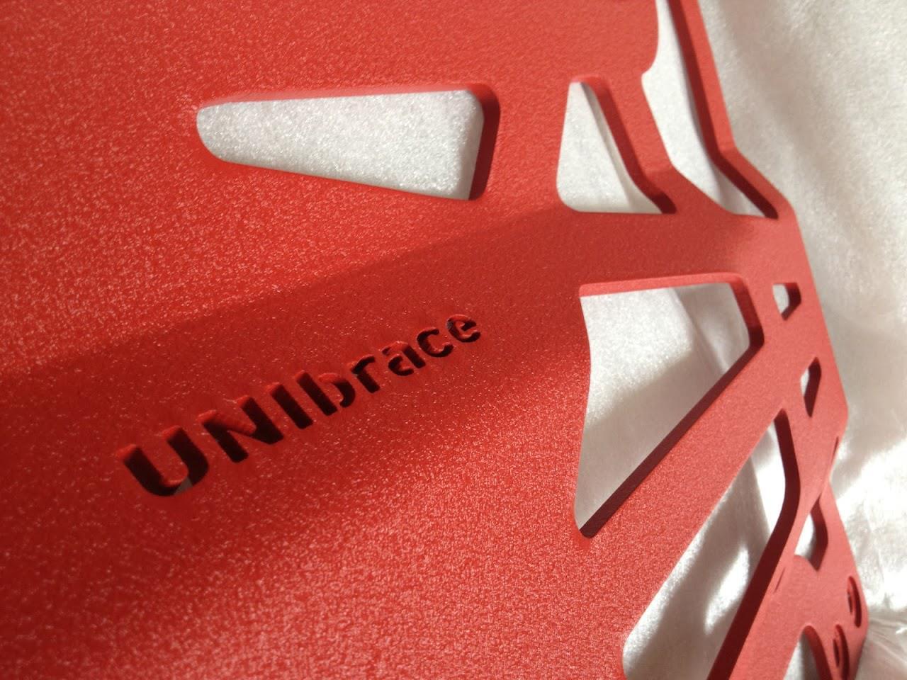

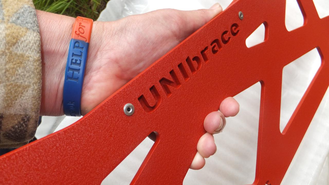

^ UNIbrace XB - Both XB and UB products are available in red or black.
^ Product quality is beyond any question - Absolutely faultless! You can tell how well the products have been considered and that this reflects the standards of a professional designer.

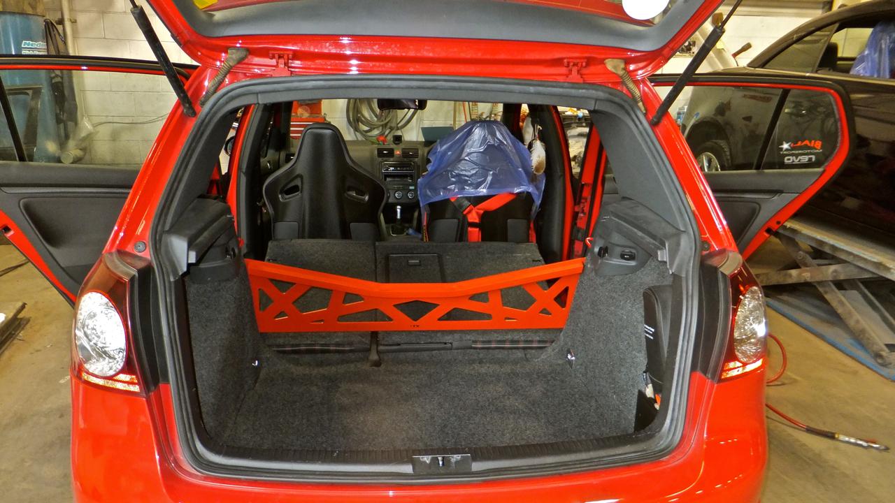

The UNIbrace XB is constructed of super strong 6061-T heat treated 0.187 inch (~4.75 mm) aluminium ('aloooominum' if you are American!) with high temperature automotive powdercoating. The UNIbrace UB is slightly thicker at 0.25 inch (~6.35 mm). They are waterjet cut and CNC bent. In other words, they are 'the biz', and also 'the shiz'!
WHY INSTALL A UNIBRACE XB?
A hatchback car body is inherently an open box and consequently a potentially weak structure. Volkswagen have made improvements from generation to generation but the Golf platform is primarily designed to meet the requirements of their general market which is aimed at a more pedestrian consumer than the typical enthusiast who will be reading this review. The phrase "Designed by German Craftsmen and Modified by Mad Englishmen" comes to mind - In this case it's a Mad American.
There is more body distortion in such an open box hatchback structure than may be initially obvious. I have heard some folks say that the rear seats contribute to reducing the distortion but, as the following photo shows, the bench seat is attached to the floor pan and the seat backs are split in two separate units. So, although I'm not a structural engineer, I believe that any claimed contribution by the seat units is pretty insignificant.

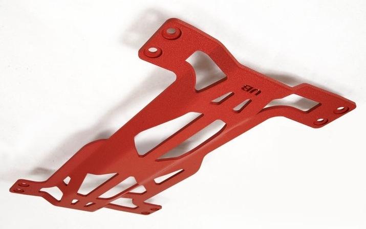

WHY INSTALL A UNIBRACE UB?

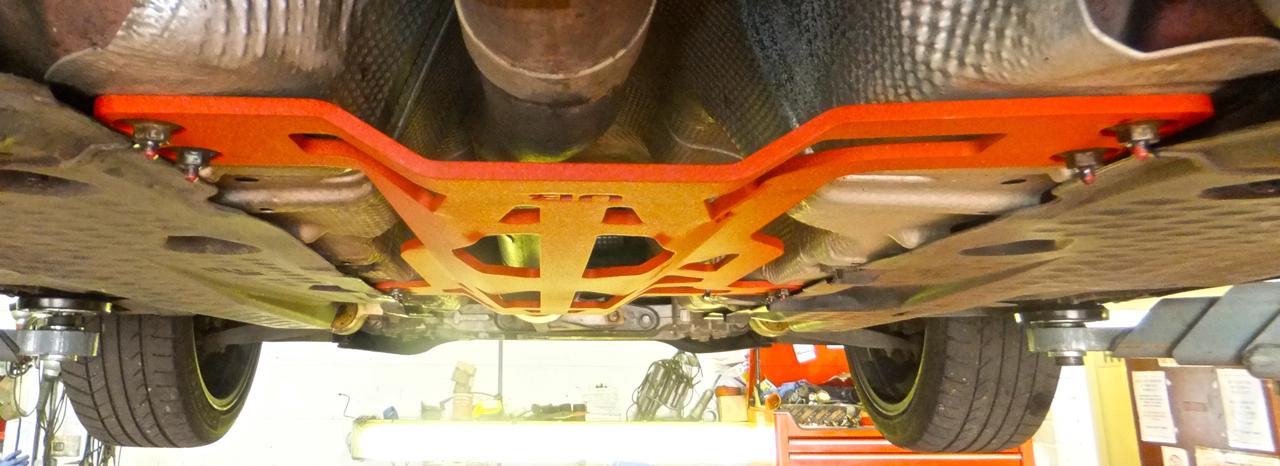

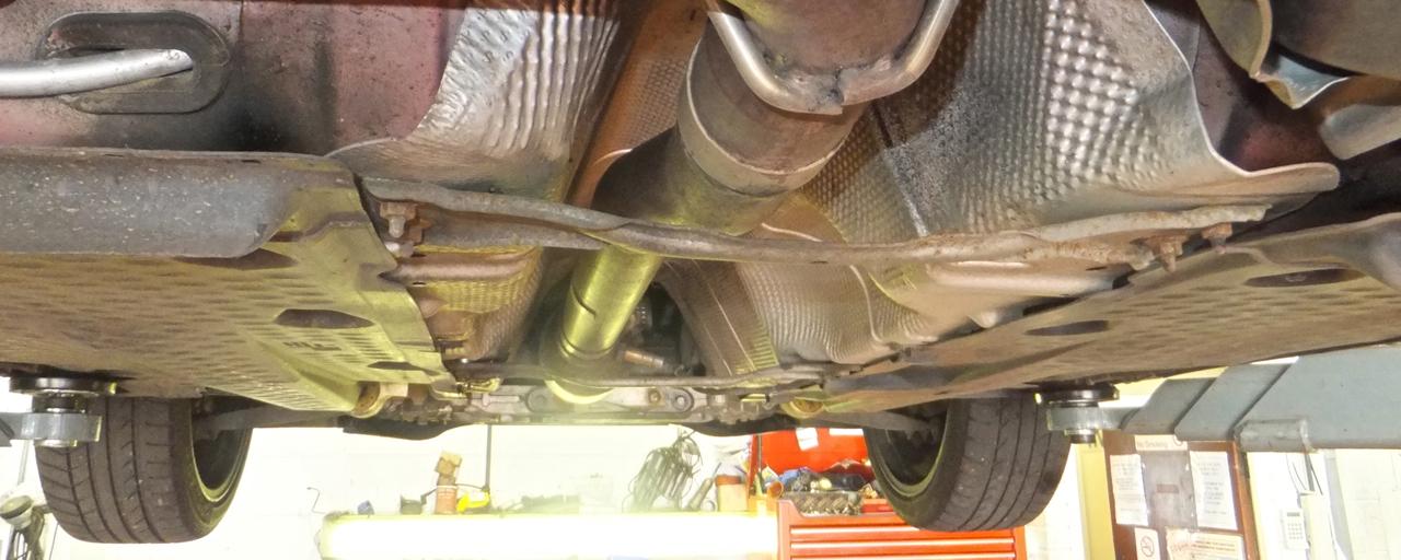

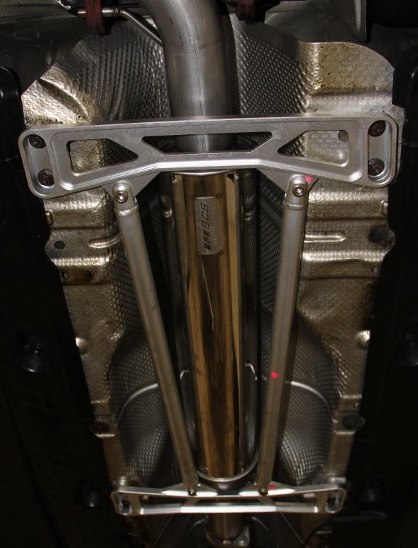

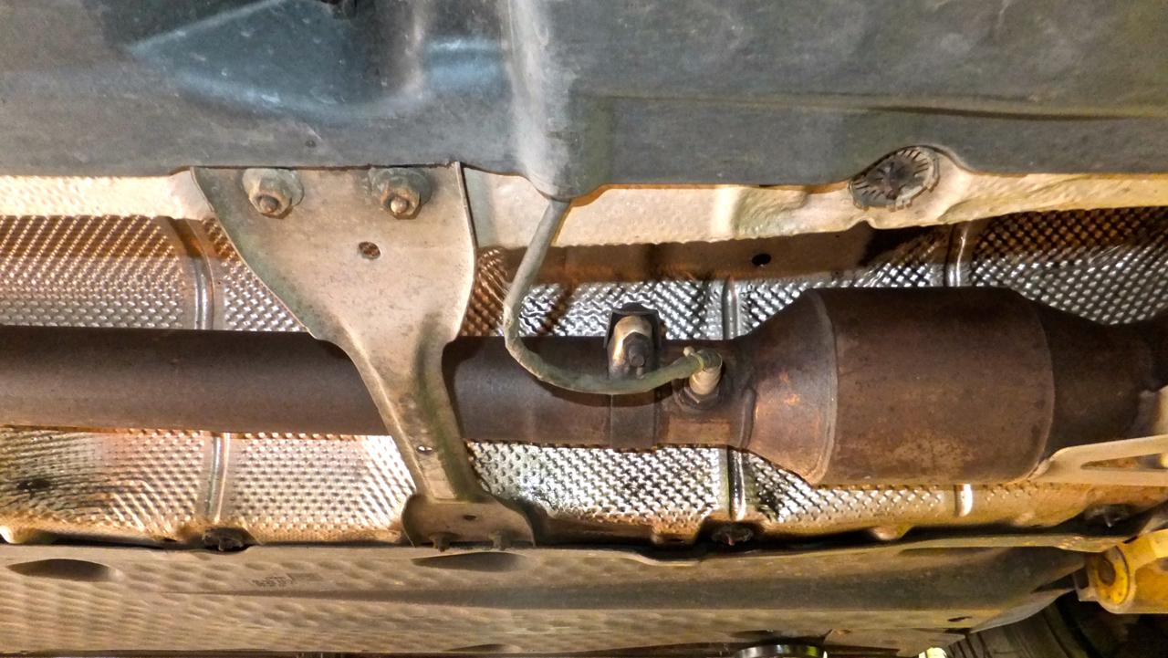

The ex factory car merely has two independent thin aluminium straps across the exhaust pipe 'tunnel' fitted at some distance apart. The UNIbrace UB uses the same fixing points but is a shaped latticework brace which structurally accommodates all four fixing points instead of just two independent pairs. The result is a stiffer chassis, reducing twist, and hence advantages to suspension and handling when driving enthusiastically. And when I say "enthusiastically" I do not mean "irresponsibly".
^ Black UB installed.
When I showed him a photo of the UNIbrace UB, a friend in the motorsport industry described it as "A solid piece of kit, somewhere between a sump guard, a grass shield, and a piece of undercar jewellery".

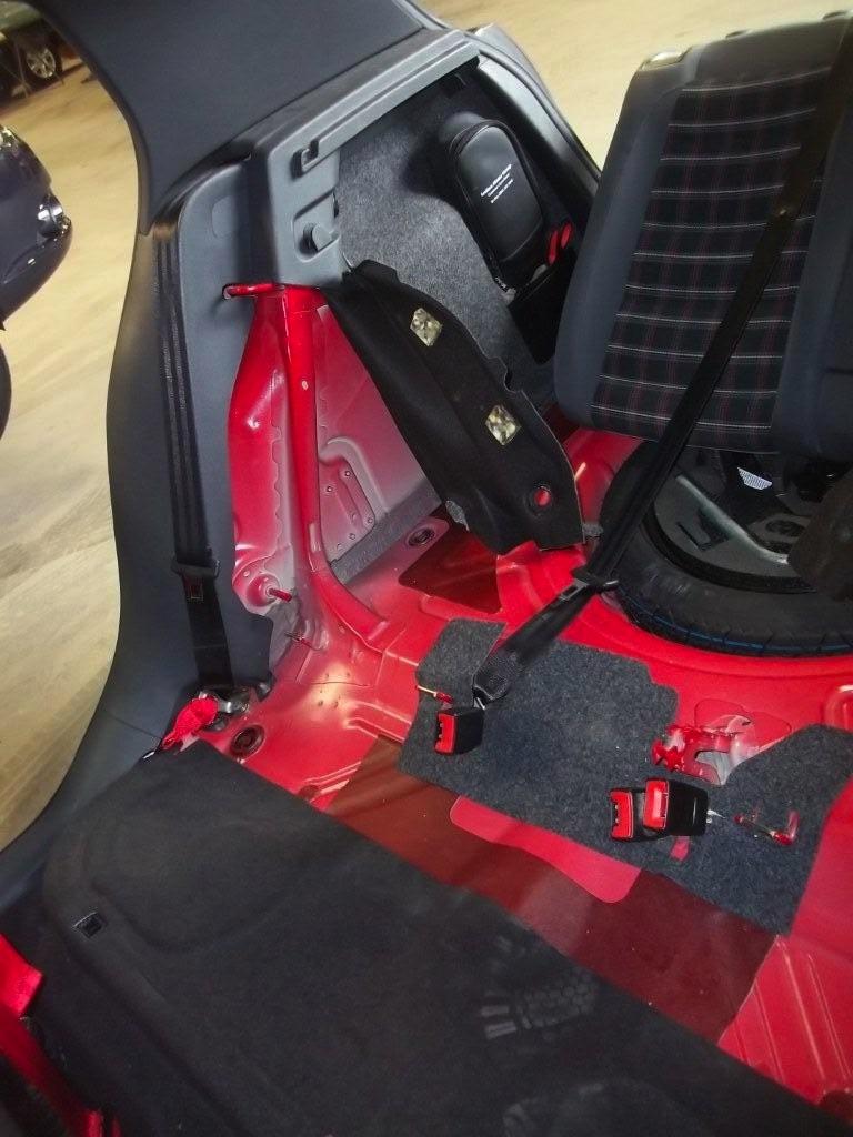

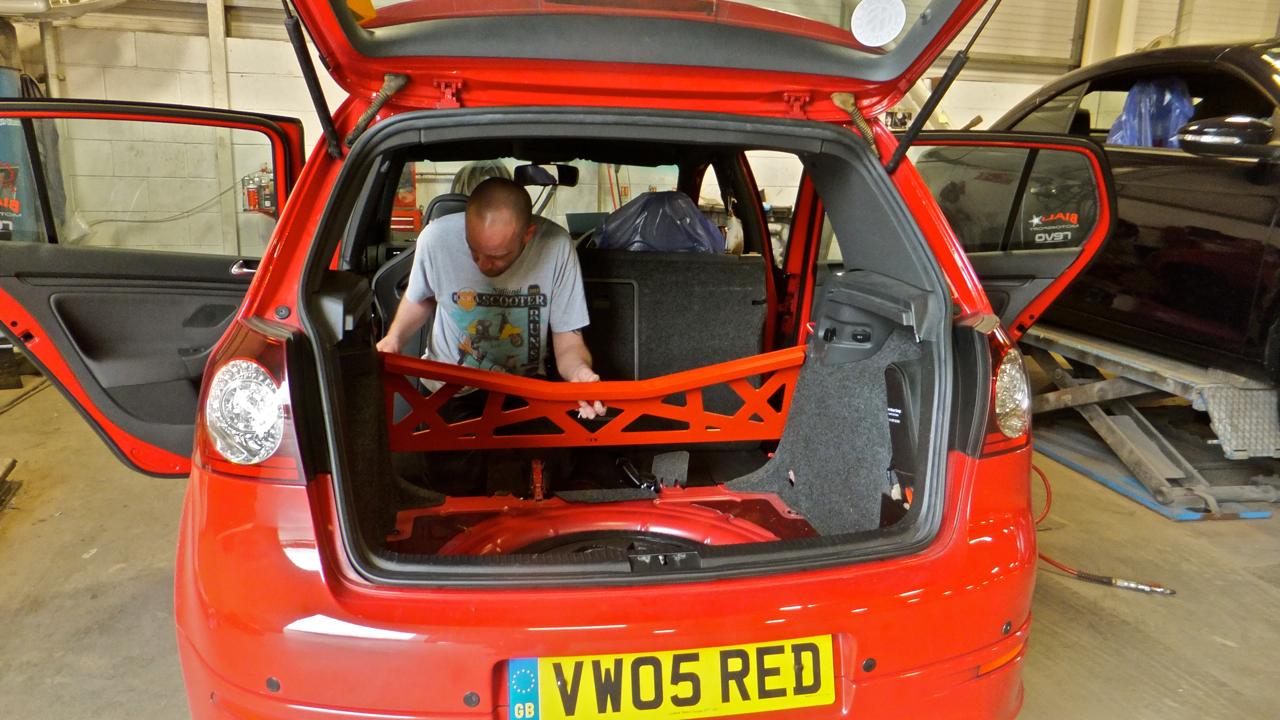

XB INSTALLATION:

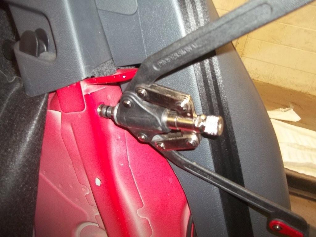

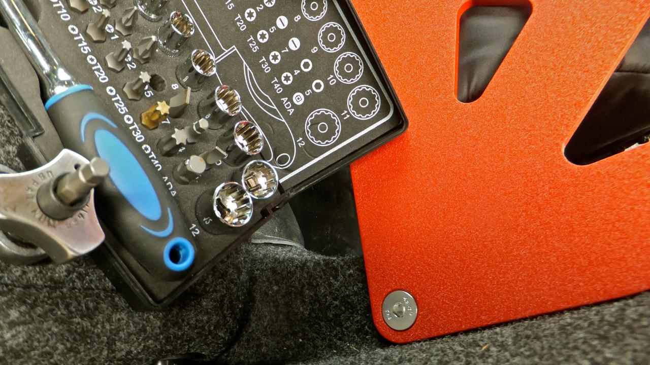

Being very methodical and applying patience is the key. I don't own the tools, workshop, or have the expertise to do mechanics etc myself so I went to my trusted VW dealer's affiliated bodyshop where they have previously fitted my DRL's, carbon bonnet, and recently wings. I was present for the last hour of installation. It took 3.5 hours and not 1.5 - 2 hours as UNIbrace suggest. This was as a result of working steadily but carefully and following the excellent installation instructions which UNIbrace provide online. The fitter, Lambretta enthusiast John, enjoyed the job and said he was impressed by the quality. UNIbrace can supply a Nutsert tool at extra cost but my bodyshop already had such tools.

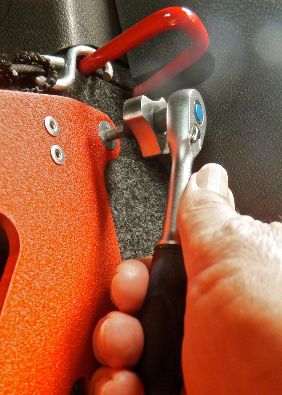

It is important of course to tighten the fixings to the correctly advised torque values in all instances.
After installing the Nutsert anchoring points, the XB can easily be taken in and out of the car via 4 Allen key bolts - A job which takes less than 5 minutes:
Allen key size 5. Hand tighten plus a quarter turn taking care to seat the threads properly. Attach diagonals first and do not tighten any until all are seated properly.

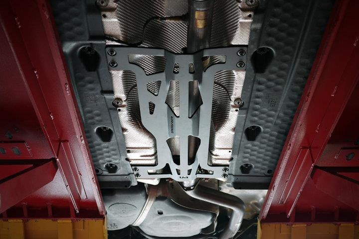

Very easy but I went to JKM and they can also adjust my suspension if needed. This video shows the UB installation extremely well indeed:

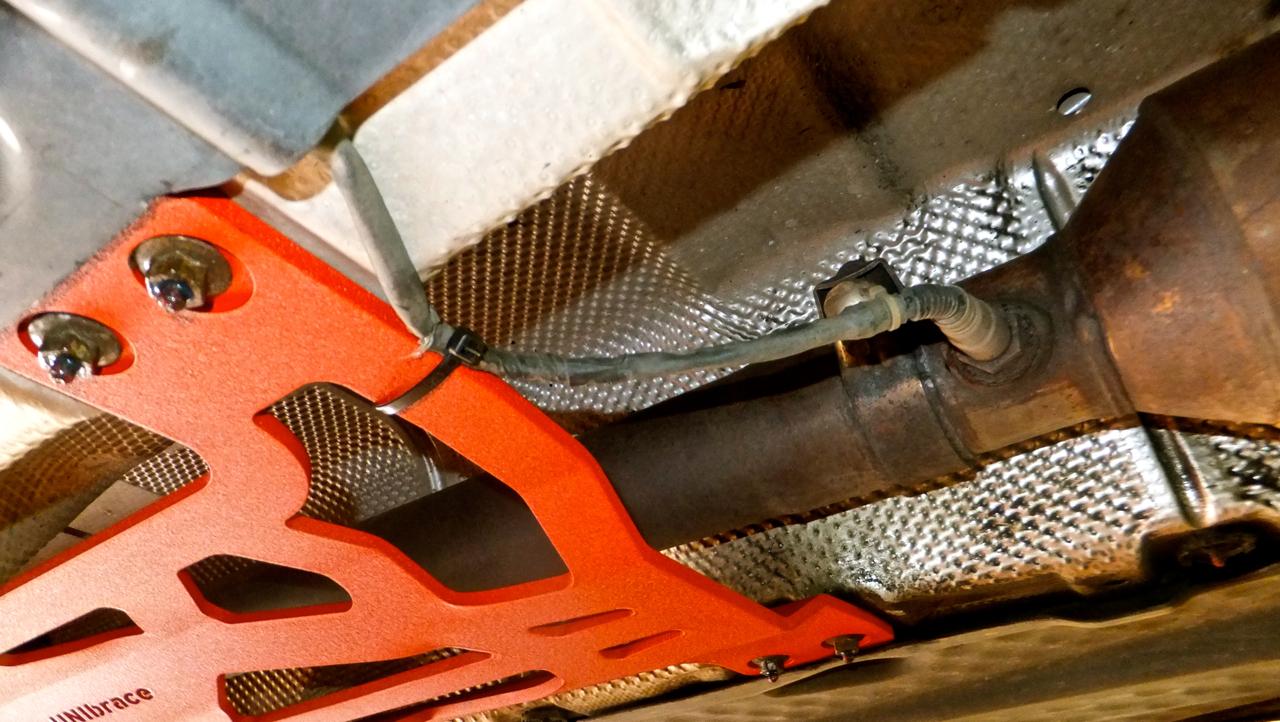

^ Before UB installation - Just two OEM lightweight aluminium independent flimsy straps across the exhaust pipe tunnel.
^ After UB installation - An aircraft industry standard aluminium lattice brace.
^ Before UB installation - Post-cat lambda sensor cable hanging loose.
^ After UB installation - Post-cat lambda sensor cable tied to UB for protection. My ground clearance is only 95 mm.

- Once mounted, the XB can be easily taken in and out with only 4 Allen key fixings - A process which takes no more than 4-5 minutes.

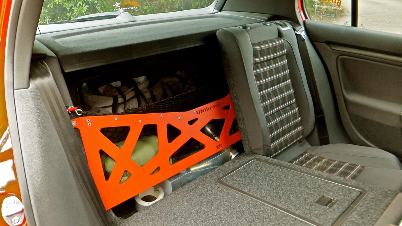

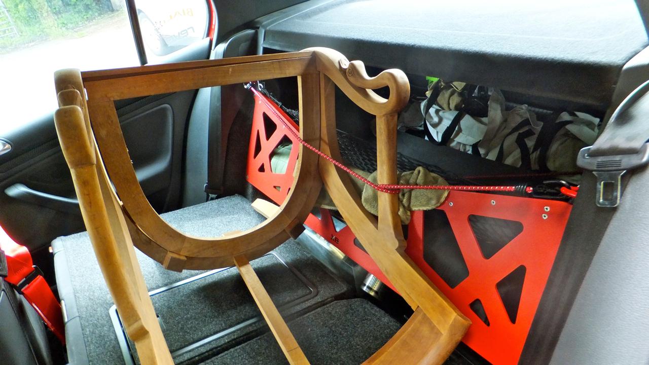

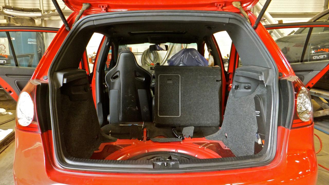

- An added bonus of the XB, especially on the 5-door Golf, is as a restrainer of loaded goods on the sloping seat backs when folded down.
- An extra added bonus is that with the parcel shelf removed, you can fit 4 track alloys with tyres in the boot like a Swiss Roll and the XB will restrain them.

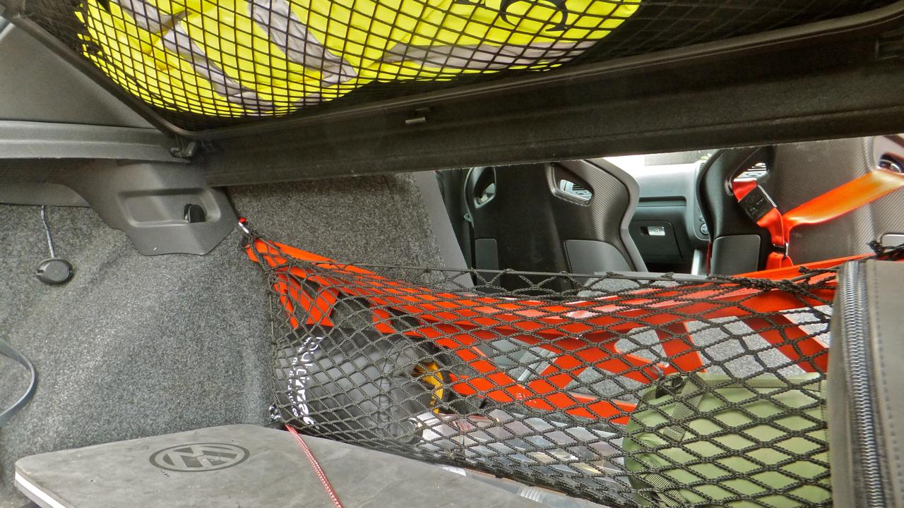

- The XB also serves to provide a back for a 'luggage net' when the seats are folded down.
- The XB has a bonus advantage of providing secure anchorage for awkward loads such as a dining chair.

On the question of UB exhaust clearance, is Dom including spacers in his sale? If not, and if I don't need mine they'll be unused and available to buy in a couple of weeks.
Offline bacillus
  • -Receive: 453
  • Posts: 6341
Re: UNIbraces XB & UB - Review....
« Reply #14 on: June 03, 2012, 12:29:59 pm »
I think you'll be needing yours RR (in Kregeil's experience) seeing you have a Milltek.
http://www.mk5golfgti.co.uk/forum/index.php/topic,46534.msg559514.html#msg559514
