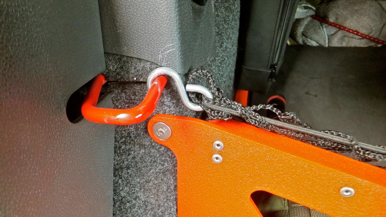

Robin, could you please let us know how long and how much effort it takes for you to remove the XB?
This something I could have been interested in but I could easily need the rear space unexpectedly. I would have liked some kind of "quick" removal system that could be done by hands eg leave in two locking bases and then the main XB could be lifted in/out within seconds.

....Will do, Jas. I'll actually do it when I next get the car out in the next couple of days and post about it.
I had a phone chat earlier today with my BIALI mate Dan who has the Mk4 R32 with a XB and he says it's easy and just a matter of 4 Allen key bolts.
I think it will take a 3-4 minutes rather than seconds. Always best to only loosely attach by diagonals first and only tighten when all 4 corners are properly seated. The XB itself is easy to handle by one person as it only weighs 6 lb.
If the XB was secured by a method only taking seconds, it would most likely have its stiffening function very compromised.

Everything has its on natural frequency, maybe the road surface vibrated the car at the unibraces natural frequency, resonance... It will certainly be interested to see when driving the same road, if it happens again, and if varying speed affects the outcome...
Also if you are wanting to feel UB seperately, I would remove Xb, so you can remind yourself how it all feels without it, then add UB, obtain impressions on how it makes the car feel, then add the Xb on top for the full effect...

....Re standard, UB, XB, comparisons - That's more or less what I plan to do, Dom. Timing depends on when VWR can fit me in.
I have now driven exactly the same road with seats down and the extra sound has gone.
