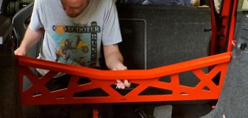

The XB is working in tension and compression across the chassis, it does not flex.. a flat brace does not have compression stiffness(it will buckle in compression) which is why the box section part stiffens it/restrains it to give it compression abilities...
As a structural engineer who specialises in steel framed building, if bracing is used, then generally two types. Flat cross bracing or tubular sections.
1) Flat bracing is laid out in pairs (like X) so in a panel the load can be transfered into a diagonal section in tension. Load one way and the brace is in tension, load the other way and the other cross brace is in tension, meaning the original brace doesn't have to go in compression.
2) Tubular bracing you have a single strut diaginally across, and this can work in tension or compression.
Well that's how I see the XB working...

....Which is doubtless why the XB incorporates a box section cross member as the photo below:
I haven't gone into the structural details in my original post but at least it is now being discussed within the UNIbraces review thread.  :happy2:
