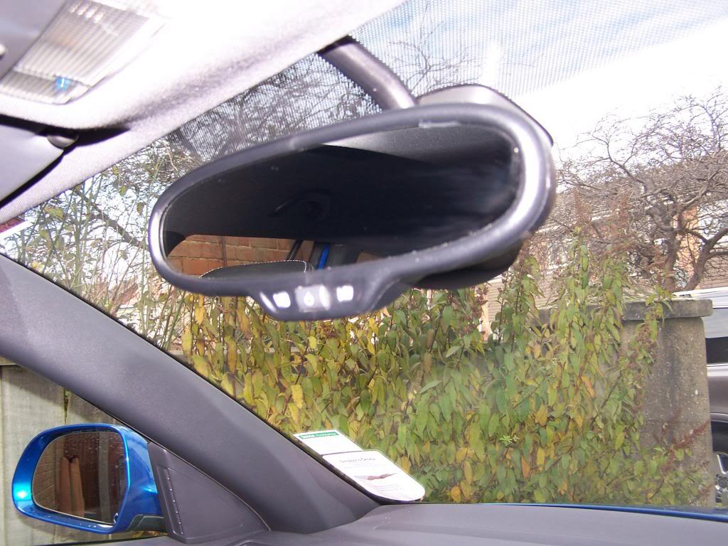

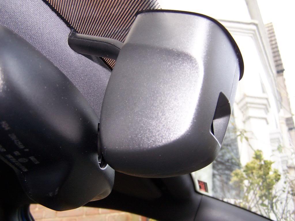

New update
Scirocco Interior mirror ( I liked it in the Golf, so gave in again)
Main feature High Beam Assist (automatic High beam with Automatic dipping)
« Last Edit: November 30, 2013, 11:40:28 am by Eddie-NL »

« Reply #91 on: November 29, 2013, 08:01:55 pm »
Loving these little tweaks mate  :happy2:

Fantastic Ed big thumbs up for the excellent High Beam Assist :notworthy:
i will have this in my mk6 golf next week too :happy2:

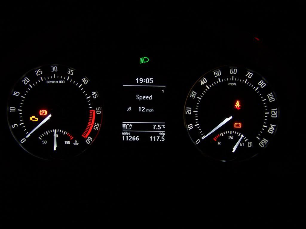

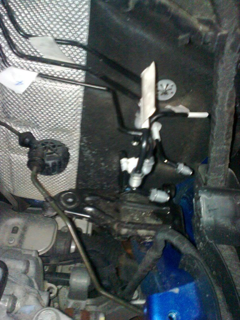

Today I changed my ABS pump :signLOL:
I managed to do it myself too, so pleased about that
No ABS pump
Cluster and Key coding

Fair play mate :happy2: What are the signs of a dieing one?
Offline Eddie-NL
  • Trader - 2014
  • -Receive: 298
  • Posts: 2639
Re: Eddie-NL's Octavia Vrs Estate
« Reply #96 on: December 04, 2013, 06:40:46 pm »
There was nothing wrong with my original one
New one has Hill-Hold
and is prep work for my next mod
Location Great Yarmouth

I've a few questions for you:-
I'd love to know how long it took you - how difficult you rated (1 easy 10 hard)?
Was there any adaption required - Did you bleed it on your own?
How did the pedal feel post change ( spongy or hard) finally, what travel after the install( same, more or less)?
Offline Eddie-NL
  • Trader - 2014
  • -Receive: 298
  • Posts: 2639
« Reply #98 on: December 04, 2013, 07:32:25 pm »
Well done Ed.   :congrats:
I went to a local garage, they allowed me to use their ramp
Took 3 hours from driving in to the garage and me driving it out
on a scale of 1-10 about 4
I got them to help with the bleeding of the brakes
plenty of lights on the dash
Had to do 4 different lots of Basic settings
the pump was Used and it wouldn't let me code it till all the faults had been sorted
pedal feels ok, done a couple of emergency stops afterwards and ABS kicks in ok

« Reply #102 on: December 07, 2013, 10:29:13 am »
Well Done Ed.........if only it could  :driver: itself!!!
Yes it Can
The sensor on the side
« Last Edit: December 07, 2013, 03:07:46 pm by Eddie-NL »
