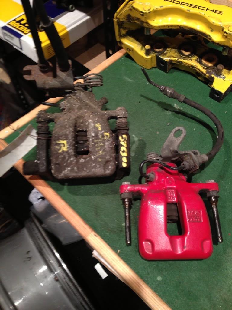

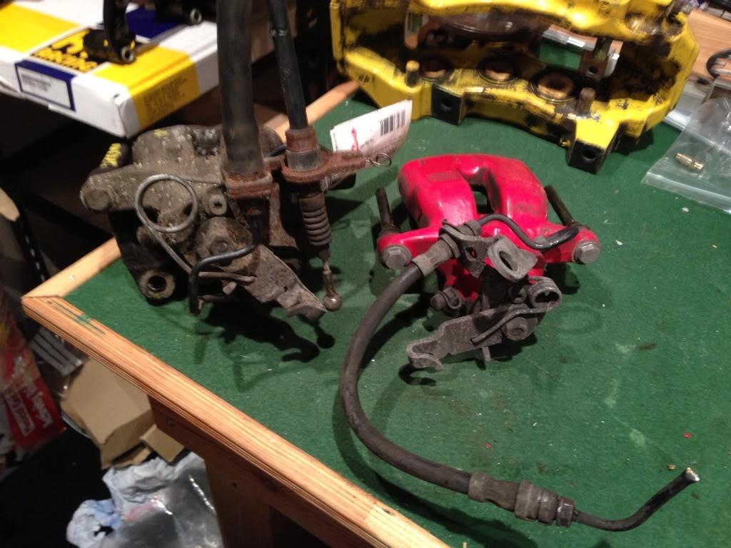

So doing what i do which is perving over ETKA making stuff fit other stuff, it became obvious that we can make Caddy 2k rear calipers fit the standard 286mm GTI discs simply by swapping them out, the handbrake arm and cable holder all need replacing on the back of them with those already fitted to the standard caliper but thats only a 13mm nut a 30Tx screw and a two prong puller. The calipers are not painted so will need some paint prior to fitting.

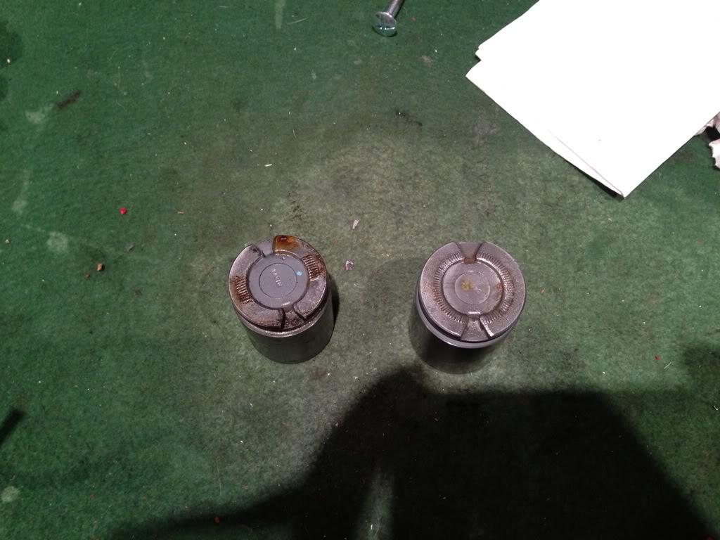

The 286mm Kit is a solid disc and unvented and therefore weighs a lot less than the 310mm discs which are around 7.9kg per corner, the caddy caliper has a 41mm piston which is the same size as S3/R32 and TTRS.
So a S3 pedal with only a 12mm reduction in effective radius which is a trade off for about 7kg of unsprung weight and an OEM look, it complements the NQS front kit as its little money and can offer a tangible increase in stability.

GTI Pads are reused....the ONLY difference once you've swapped over the bracketry on the back is the piston size.
I wouldn't buy new Calipers that's going to be expensive, they normally go for about £100 per pair on the bay, that said they'll probably start fetching more.

Its mounting up of course especially if the plan is to send them for paint.. That said if you wanted to paint them yourselves its not that bad.....let me explain.
The caddy Calipers are not painted and you could strictly speaking have them bead blasted entire and then paint them having removed the handbrake gubbins to do a good job.
The golf mk5 rear carriers could be dipped and then blasted to get rid of the OEM paint.
Paint them together with that folatec stuff and it starts to make sense

I've just fitted mk6 Gti calipers on mine this summer,.they came off a late 2010 car apparently. The piston on them is a lot bigger than what was on my mk5 ones and I must say they've made a hell of difference. Not sure if they've uprated them all but when I had to get the lines the lad at VW had to go and look at an ED35 to get the right parts as they weren't on ETKA yet. Nice little mod seeing I only paid £90 for them!

You would think that, but I have the MK6 rear setup on my FL VRS, and trust me the Caddy mod is worthwhile, The MK6 piston is the same size as the MK5 GTI 288mm setup, just the caliper/disc is smaller/lighter. So it would be worthwhile, Its probably going to be my next mod when I get the cash together
