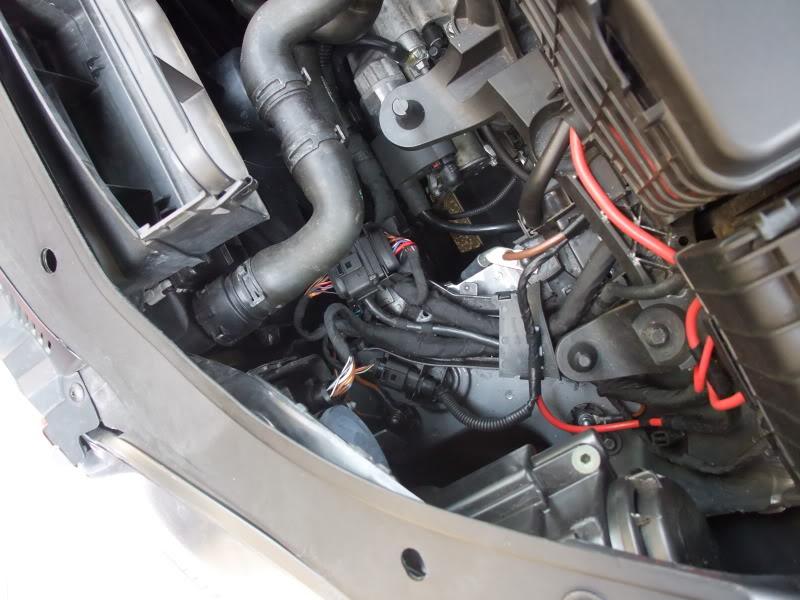

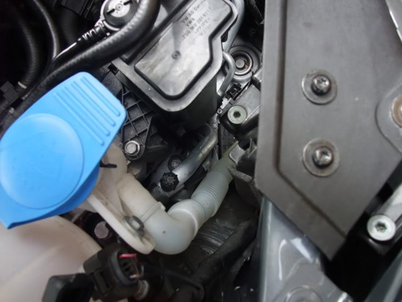

I used these instructions and due to not being happy with the location, and lack of looking correct due to the can touching the rear of the headlight, the charcoal cannister, one of the air con pipes and the screen wash pipeline, or a combination of any of these. See picture below.
 I decided to look at an alternative site.

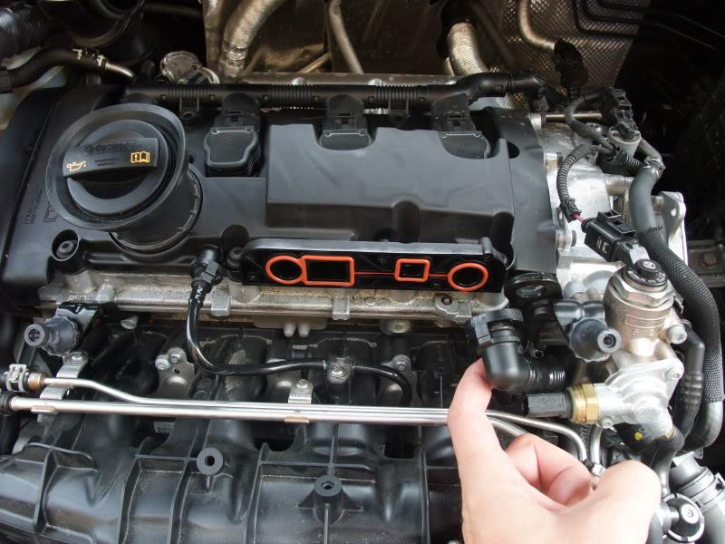

Remove the Accordion hose that runs bewteen the Intake manifold right corner to the PCV assembly and fit the blanking plug (BSH instructions step 1 and 2)
Then using a torx driver T25 remove the OEM PCV assy from the rocker cover.  You should then be left with
Note the Orange gasket, and me holding the breather hose out of the way.

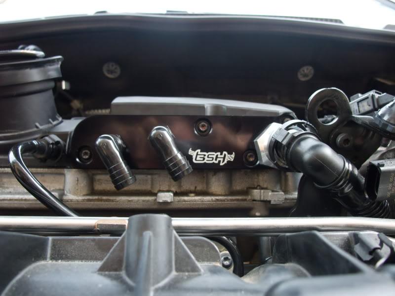

Prepare the manifold plate (A).
Fit the two 90* unions, I used a dab of sealant as I screwed then in.
You will need a 17mm spanner to fit these unions.  I did take a take, but it did not come out.  After you have fitted them you will see they protrude the rear by a few mm.  I trimmed this off with a razor blade.  to leave them flush at the rear.  DO NOT overtighten!
Leave the unions in the configuratuion below. in this pic you will also see the large union (silver fitted)
Then you can offer the Manifold plate and fir as per pic above.  The Screw in the Top right required a small flat to be filed on the washer, as the large silver union overlaps the hole by a mm or so.
Tighten the screws gradually, so as to fit the plate evenly.  also the screws are threaded into plastic, so be careful with how tight you go.
You should then be as below.

I looked at the area in front of the battery, and had thought of using the threaded brass spigot just in front of the battery, but dismissed it due to the tank sitting too high.  I also looked at the area behind the passenger headlight, but would have been too messy.

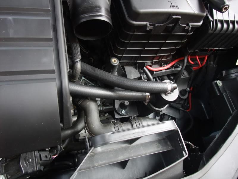

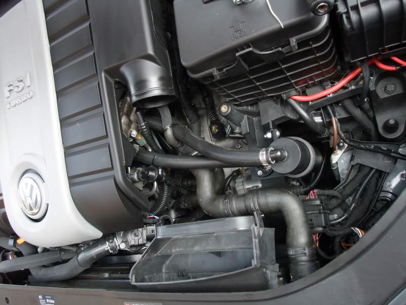

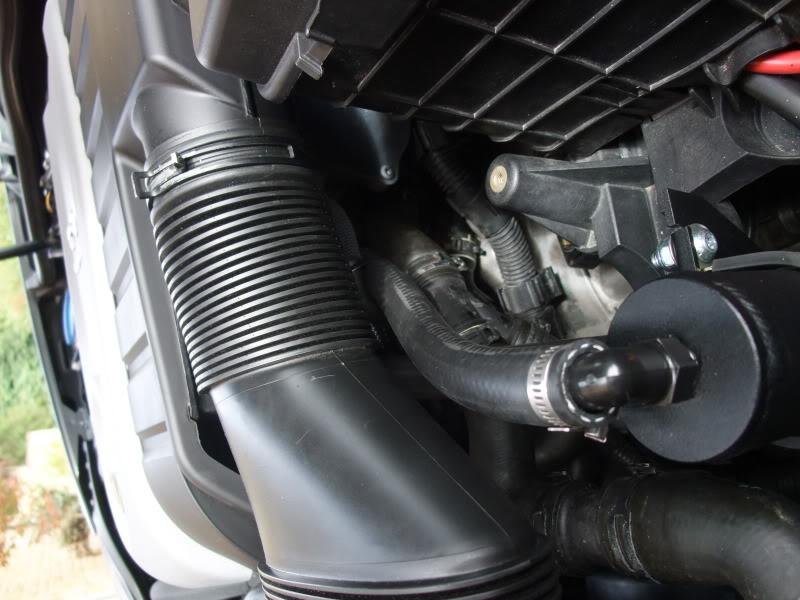

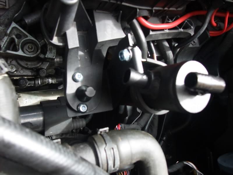

I decided to fit the bracket to the plastic spigot as shown in top mid picture below.

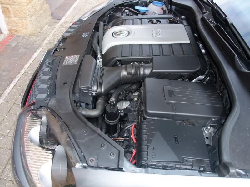

Bracket and catch tank fitted in pic below.

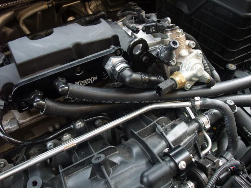

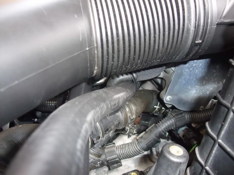

Routing the lines
I decided to route as below.  Be careful about the hoses chafing on the fuel pump and various parts of the engine.
Various pics
I do think that this fit is far better, looks far more OEM, and allows greater access to the can.  I also think that you would be able to fit the greater capacity can in the same way.  Be careful if you are thinking about fitting an intake similar to the ITG one Steve P has been trialling.

I think you could also turn the bracket upside down and fit the Catch can lower still.
