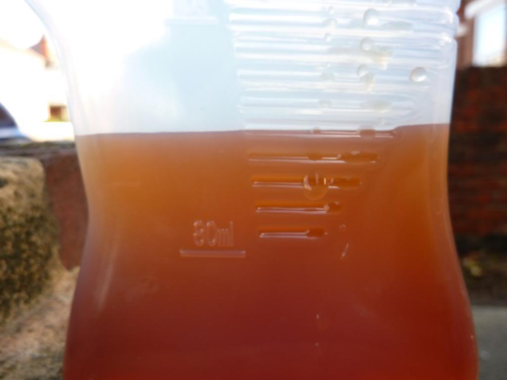

Well i can safely say the catch can works  :grin:
After around 1k miles this is what had been collected in mine  :surprised: :surprised:
As you can see from the pic that is nearly 120ml of Carp which would have gone back into the head.
Now all i have to do is show the missus how to empty it whilst im away  :grin: :grin: :grin:
Carl :happy2:

Looks like mostly water though.

emptyed mine after 100 miles, there was about a mil of water.  :signLOL:

Reason i went for the Stage 1 fix on mine. Fit and forget. Catch cans are unnecessary. Its only excessive pressure throwing the oil out, its not bad oil. The catch can only looks like the stuff that was in it is minging because of the mix with water.

i drained mine after 1k and had about the same amount .
