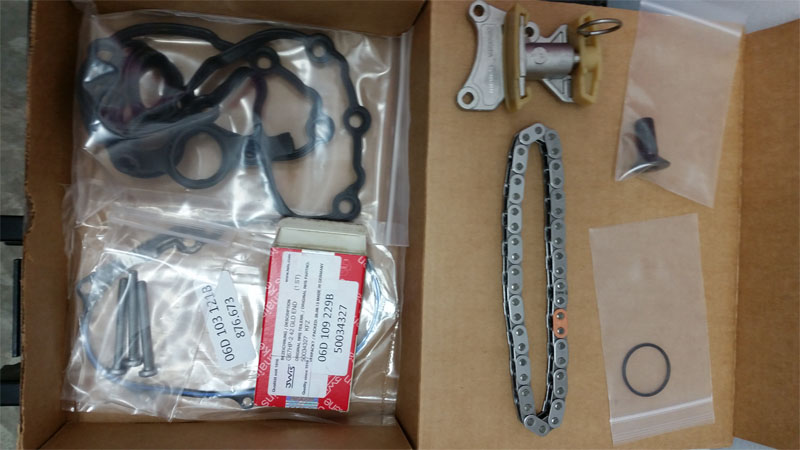

@Yorkie92 @Carl123 Any of you guys had the chain and tensioner changed yet?
Received these bits over the last few days just Physicing my self up to get it done.

To be honest can see anything wrong with the chain, tensioner or adjustor. So will just change them all and hope for the best. I hope the chain and tensioner will sort your problem.
