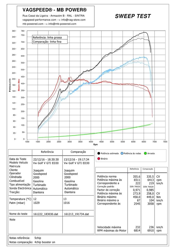

I've heard stories of lighter crank pullies causing issues so be wary of that.
Glad you have made some nice small mods they look good :)
Only question is on the dyno chart what's the odd looking flat spot at 2500rpm?
I didn't heard any but I didn't really search for them. I just trusted the GFB build quality... I'll look into it now. :thinking:
Btw, the GFB crank pulley isn't an underdrive version like the Neuspeed's is.
That flat spot corresponds to the boost spike and boost control. All TFSI engine do that spike on the BAPRO dyno. Not noticeable on the road unless I get traction issues. :signLOL:
The MAHA dyno where I had the car tested for the 1st time seems to filter that spike. :smiley:

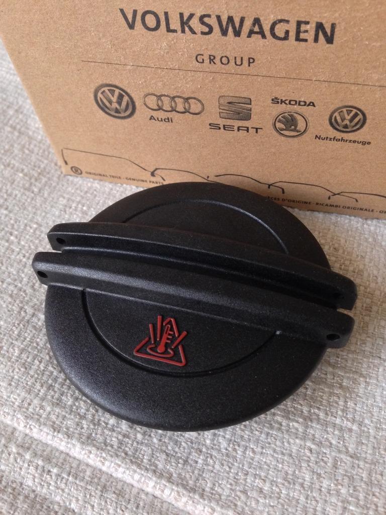

I had to remove the only blue cap I had left on my engine bay so I got this instead. :laugh:

Went today to get the car tested on the dyno again after fitting the VWR intake and the Go Fast Bits lightweight crank pulley.
Now it measured 355,6 CV and 337 lbft, so about +20 CV and the same torque compared to last time, at 15ºC of ambient temp and 27ºC of intake temp. :pomppomp:
The intake really made a good difference, not just on the butt dyno. :grin:
Not sure what was the contribution of the lightweight crank pulley to the final result.
