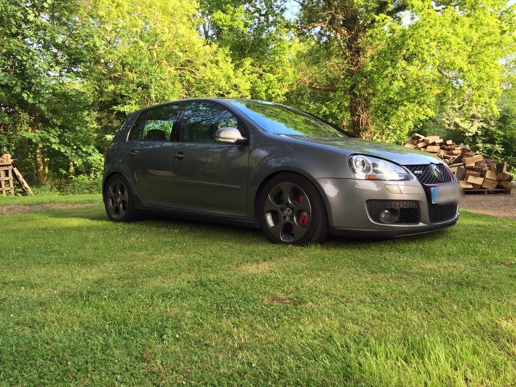

Hi guys and girls here's my golf gti
Here's my spec
 full service history except one stamp missing
Manual

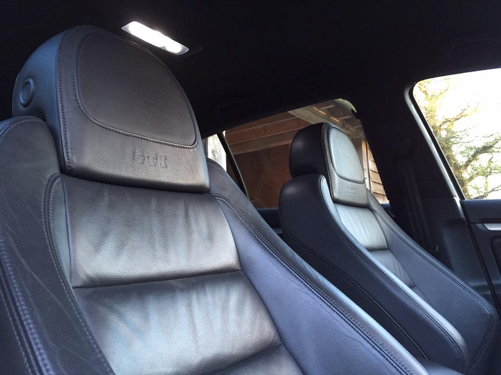

Full heated leather seats
Bi-Xenons
Auto dimming rear view mirror
Highline clocks
Convience pack
Winter pack
Had my front wings replaced to underwarrenty to  :happy2:
I also replaced all the interior lights to led to update the look
 I'll be updating more photos to go with progress as I go on
So far this is what I've done to the golf.....
Here's my full list of mods:
GFB diverter valve
New pcv valve to latest version
Ngk 7's spark plugs
Genuine edition 30 front and rear splitter side skirts
And oil service and filter 5w40 millers nano drive

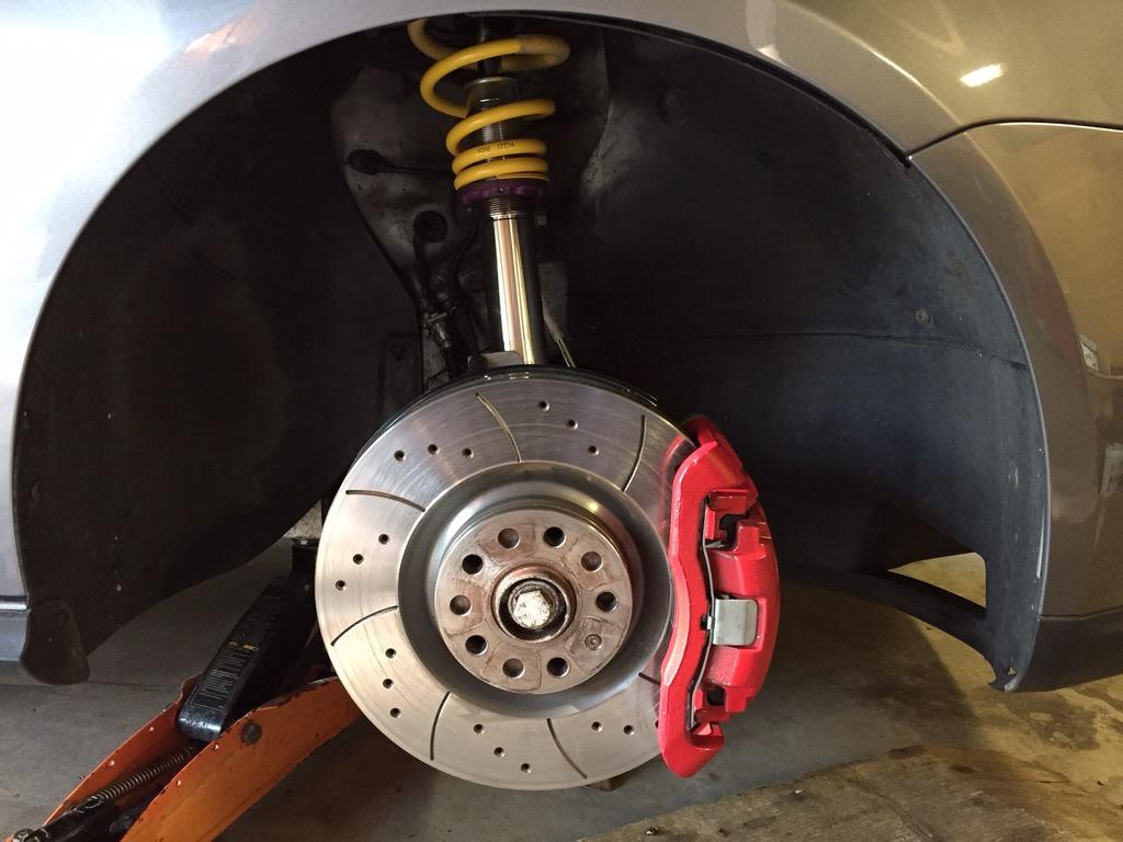

SUSPENSION
Tyrol subframe dear set kit
TTRS top mounts
S3 hubs
Super pro walk kit
Super pro wishbones
Super pro ball joints
KWV1 coil overs
H&R anti roll bars 28mm on the front,24mm on the rear
BRAKES/wheels
TTRS brakes with vagbremtechnic two piece 362mm and project mu H16 pads
Hel brake lines
S3 rear brakes 310 J hooked vented discs
Speedline turini 18"x8.0 et42 with Michelin ps4 tyres
Engine tuning wise ,
New CDL engine
TTE420 turbo
165 bar fprv
S3/golf R injectors
Runner flap delete
Rtech custom stage 3 tte420 420 bhp and 411 ftlb :phew:
Helix organic clutch
Cts discharge pipe and muffler delete
APR intercooler
revo ceramic intake pipe
BCS 3.5" downpipe/decat prestige front silencer power valve exhaust
audi r8 coilpacks
LOBA fuel pump
Banjo bolt delete
Diverter valve relocation to k04 postion
Interior
LEDS all round
RCD 510 DAB with aux in the the arm rest
Polo aerial

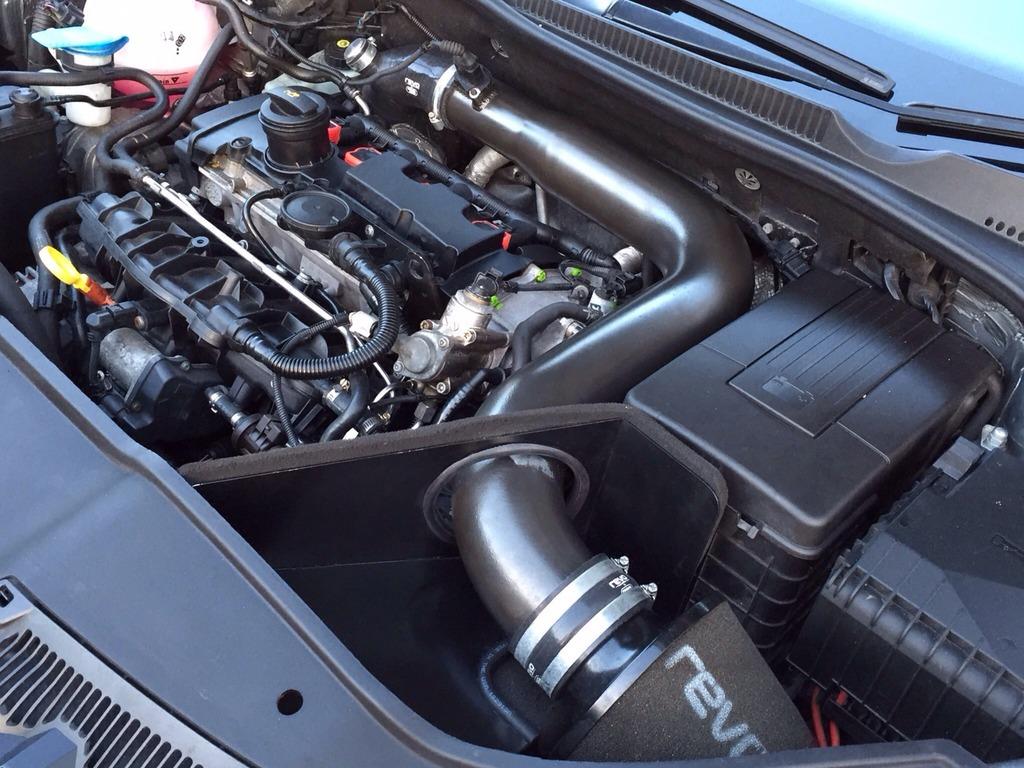

May i ask how you got your engine bay so clean? Mine looks terrible compared to yours  :ashamed:
Not sure what this chap has used on his but on all my cars I give them a spray with tfr and sponge anywhere with dirt build up, hose it off and then spray auto glym instant tyre dressing over it. Shut the bonnet and go for a drive or leave engine to idle so there's some heat circulating and then have a look  :wink: you'll be suprised how fresh it looks

Samiul11 it has been looked after before me but what I use is baby wipes and back to black  :signLOL: and a toothbrush and paint brush then get cracking  :happy2:

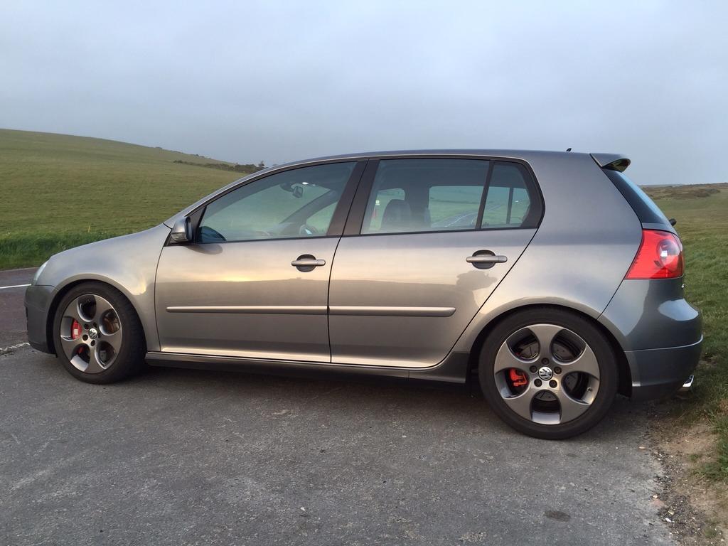

Looking good  :happy2:
What colour are the alloys?
Offline jhook661
  • -Receive: 20
  • Posts: 324
  • My Ride: http://www.mk5golfgti.co.uk/forum/index.php/topic,98678.0.html
Re: Josh's Steel Grey GTI in the making
« Reply #11 on: June 28, 2015, 09:21:57 am »
It's Porsche grey  :laugh:
