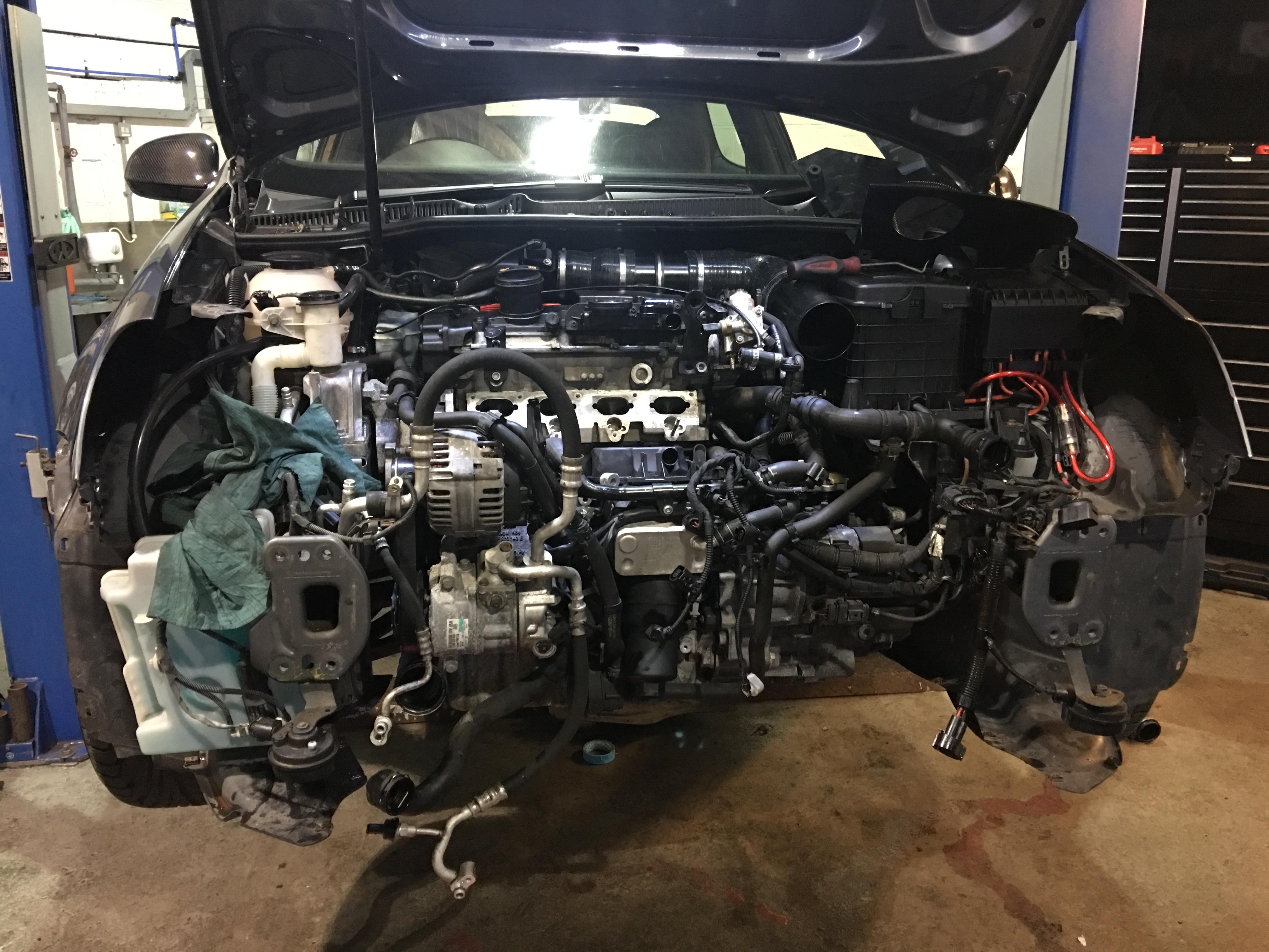

Well managed to get most of my jobs done over the last two days.
Intercooler fitted.
RFD fitted.
EVAP and carbon canister deleted.
RS4 fuel pressure valve fitted.
New coolant.
Aircon regas.

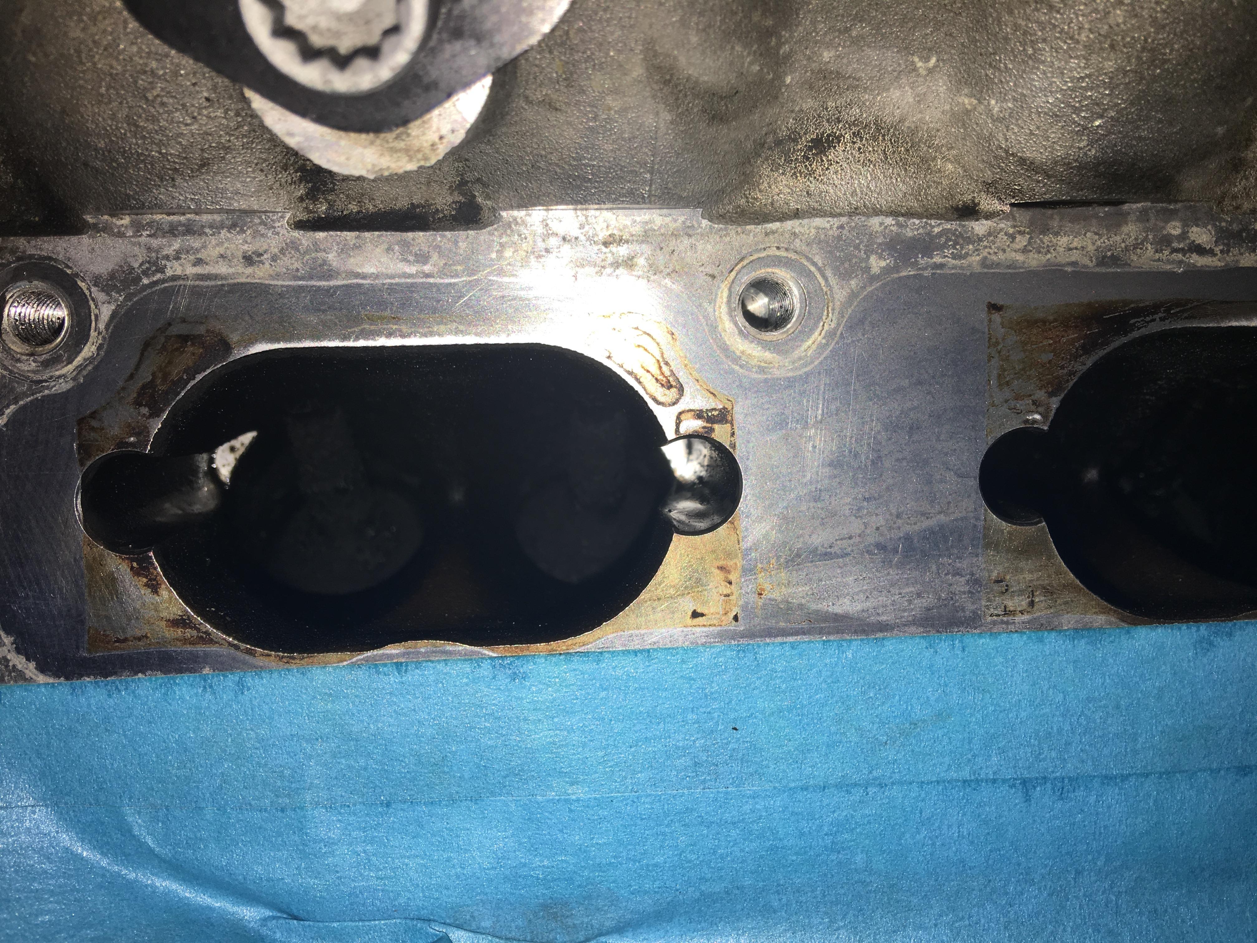

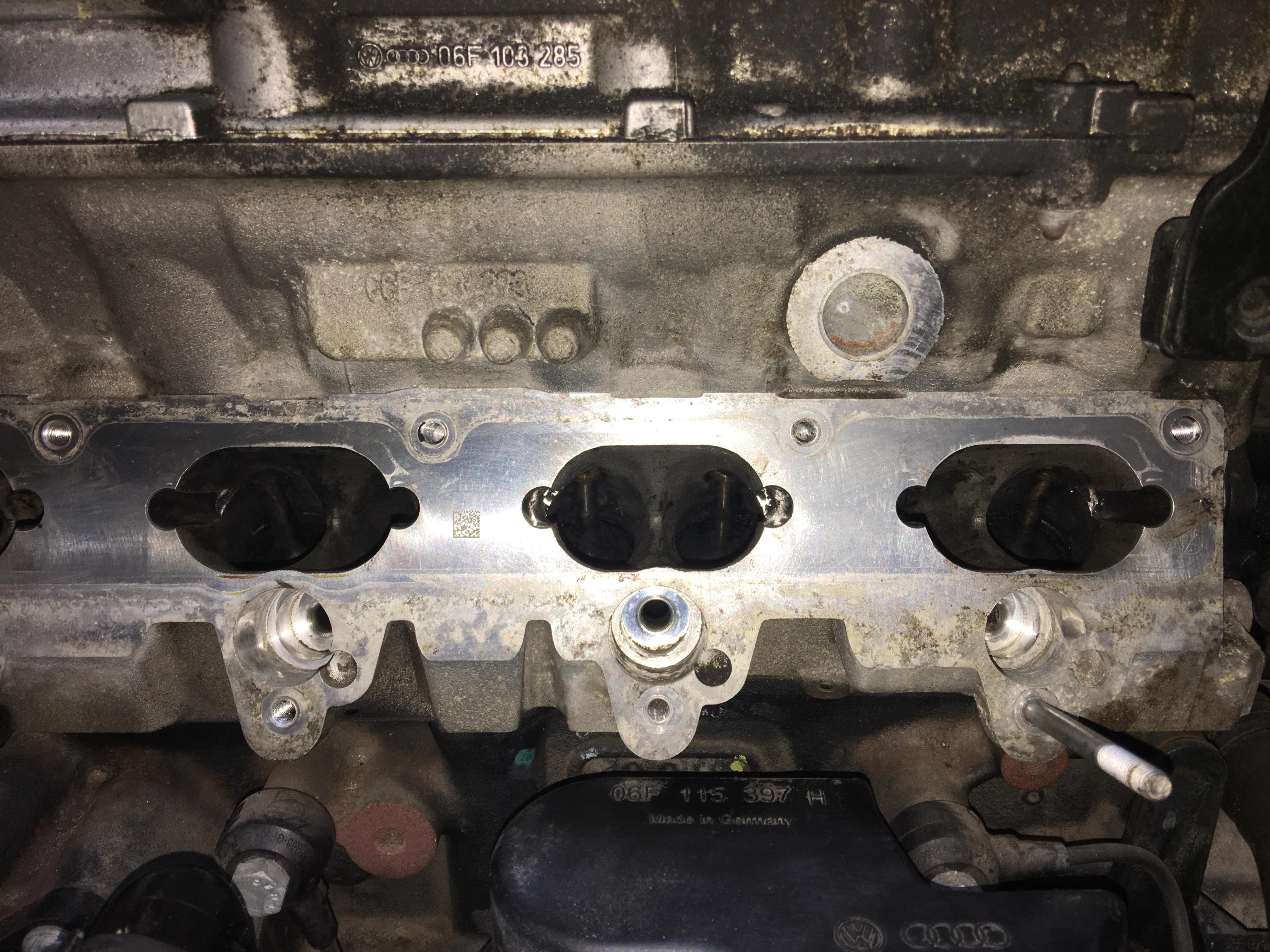

Inlet valves cleaned.
Inlet valves were covered in carbon.
First pass with carbon off. Forgot to take a picture of them all clean.

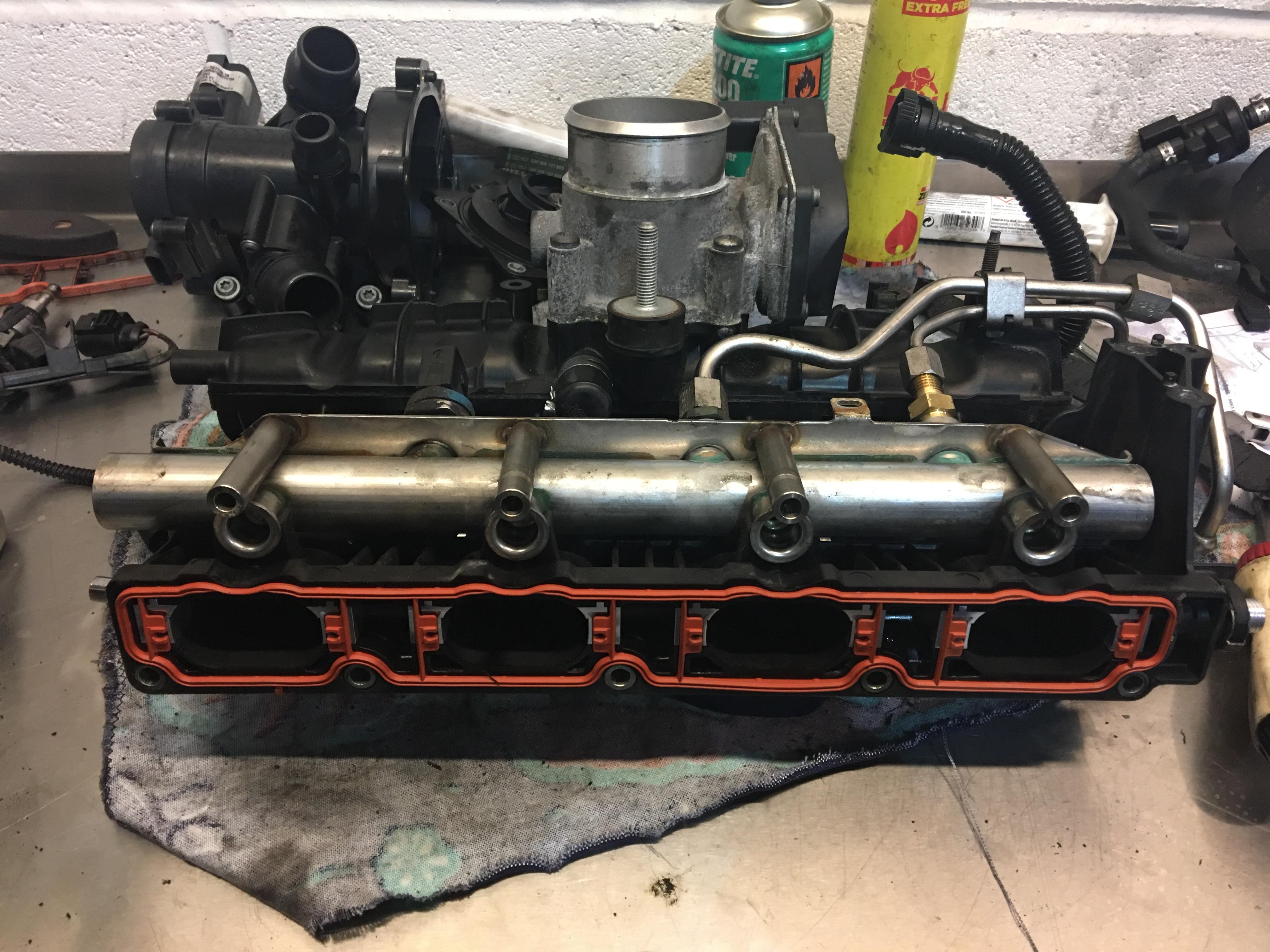

Inlet manifold all complete ready for fitting.
Car does pop and crackle more on over run than before. Seams to pickup better but just need to sort out getting it mapped now and decide if I go for stage 2 or 2+.

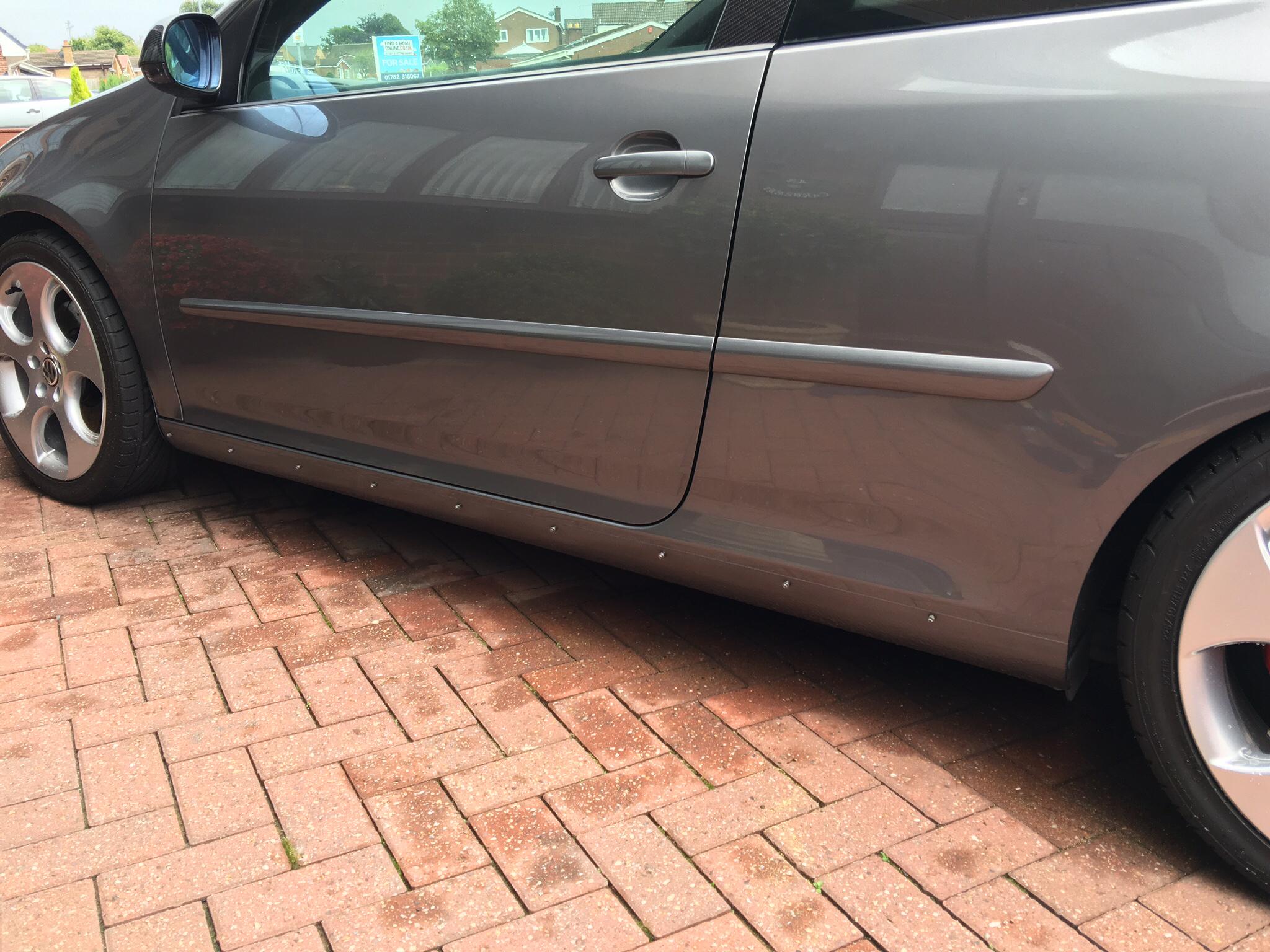

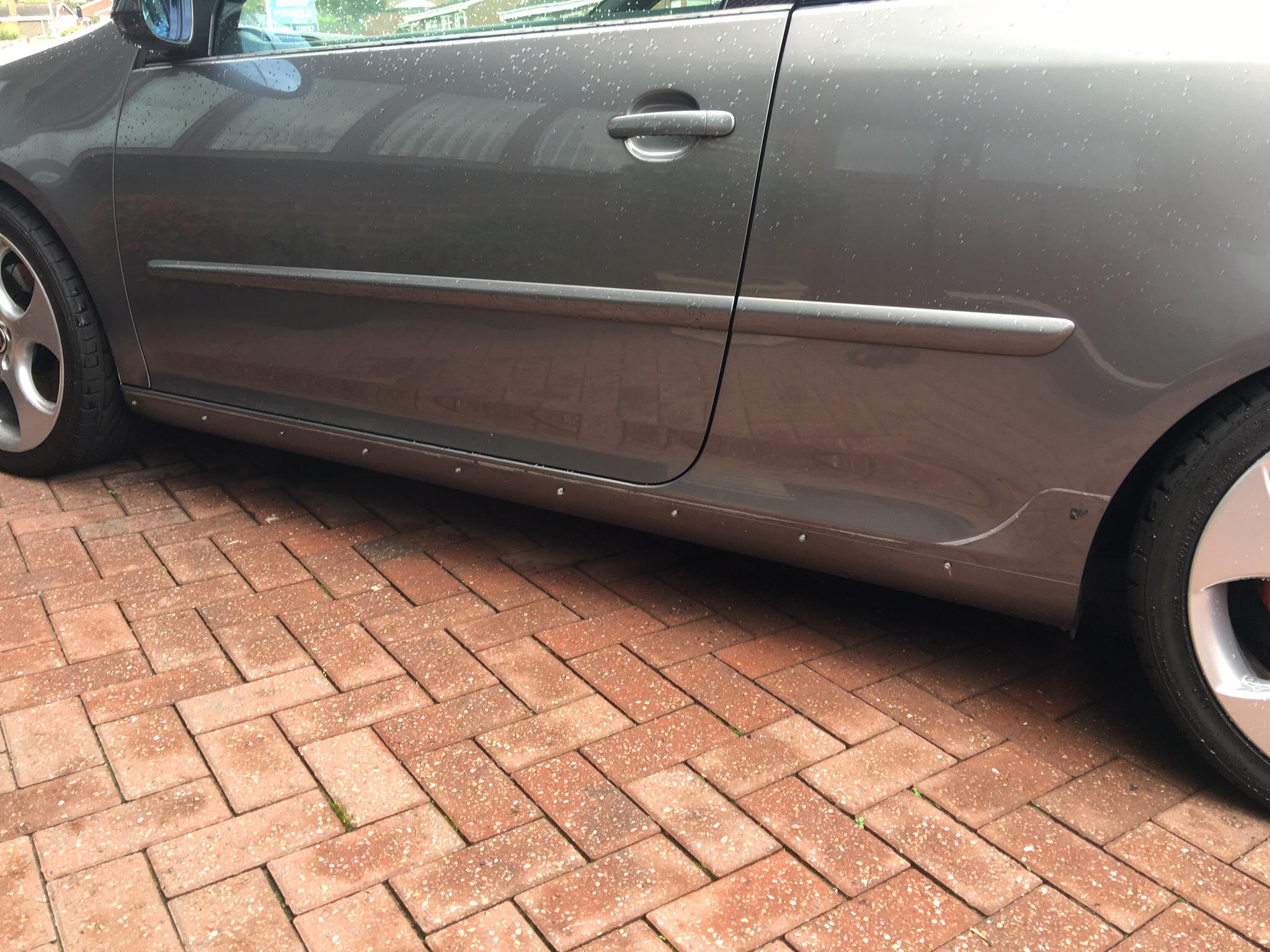

Waited for a dry spell and removed my sill trims.

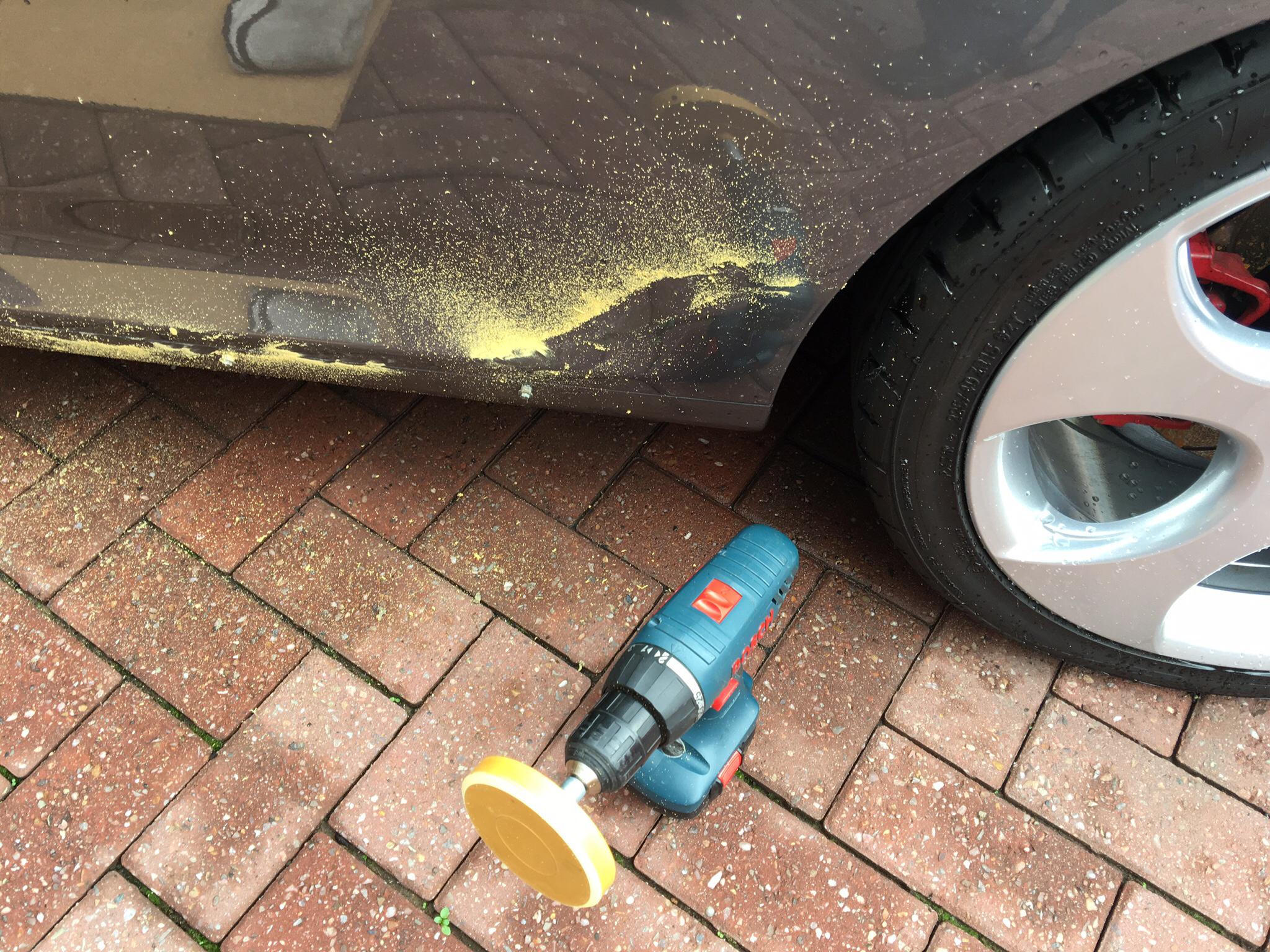

Got the toffee wheel out to remove the remains of the double sided tape.
All done ready for my painted ones to be fitted.

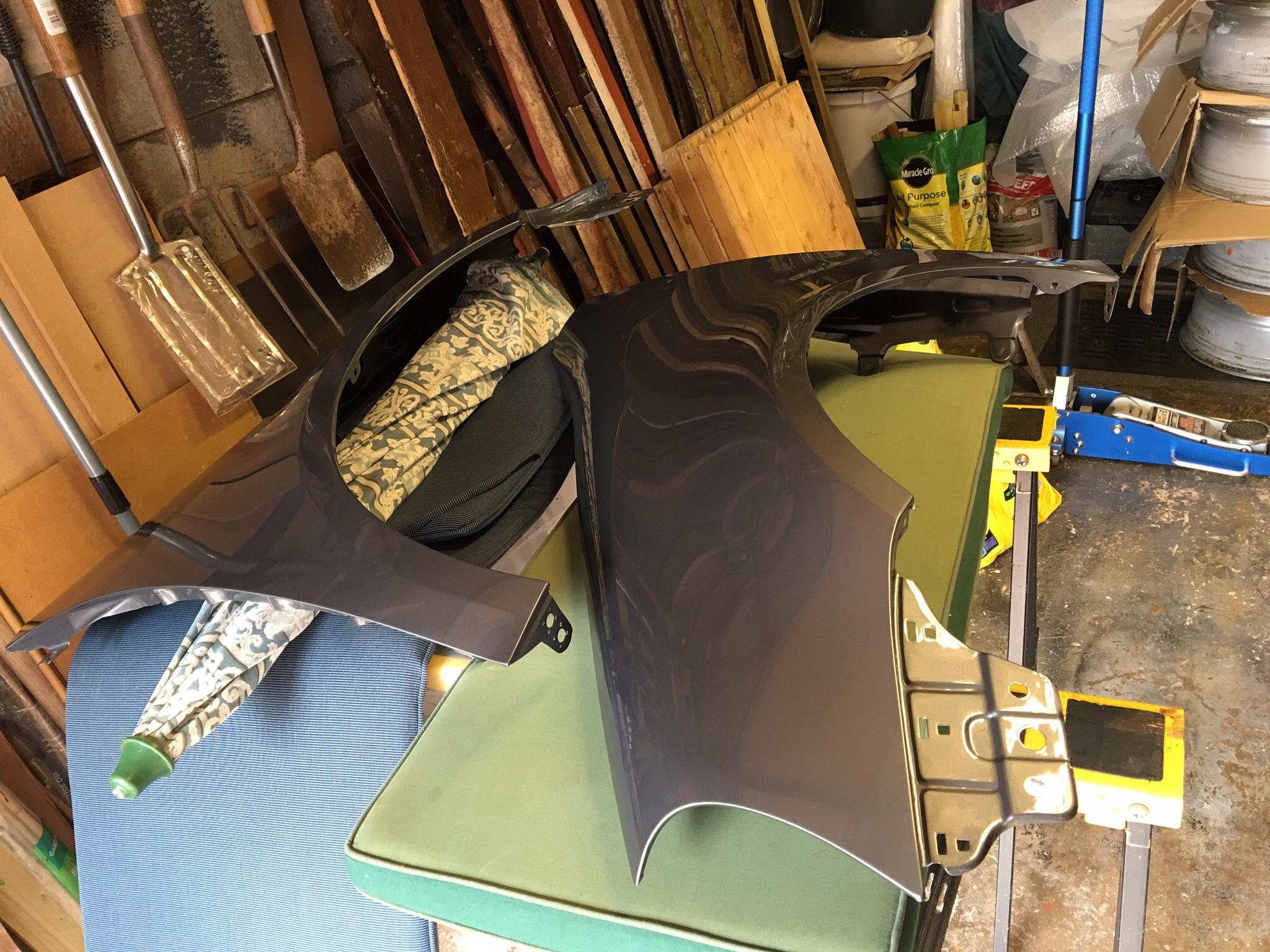

Got my eBay pre painted wings delivered. Paint job is good and looks a close match. Will see how they fit.
Looking at the weather Sunday will be a washout so should be ok on Monday to get some more done.

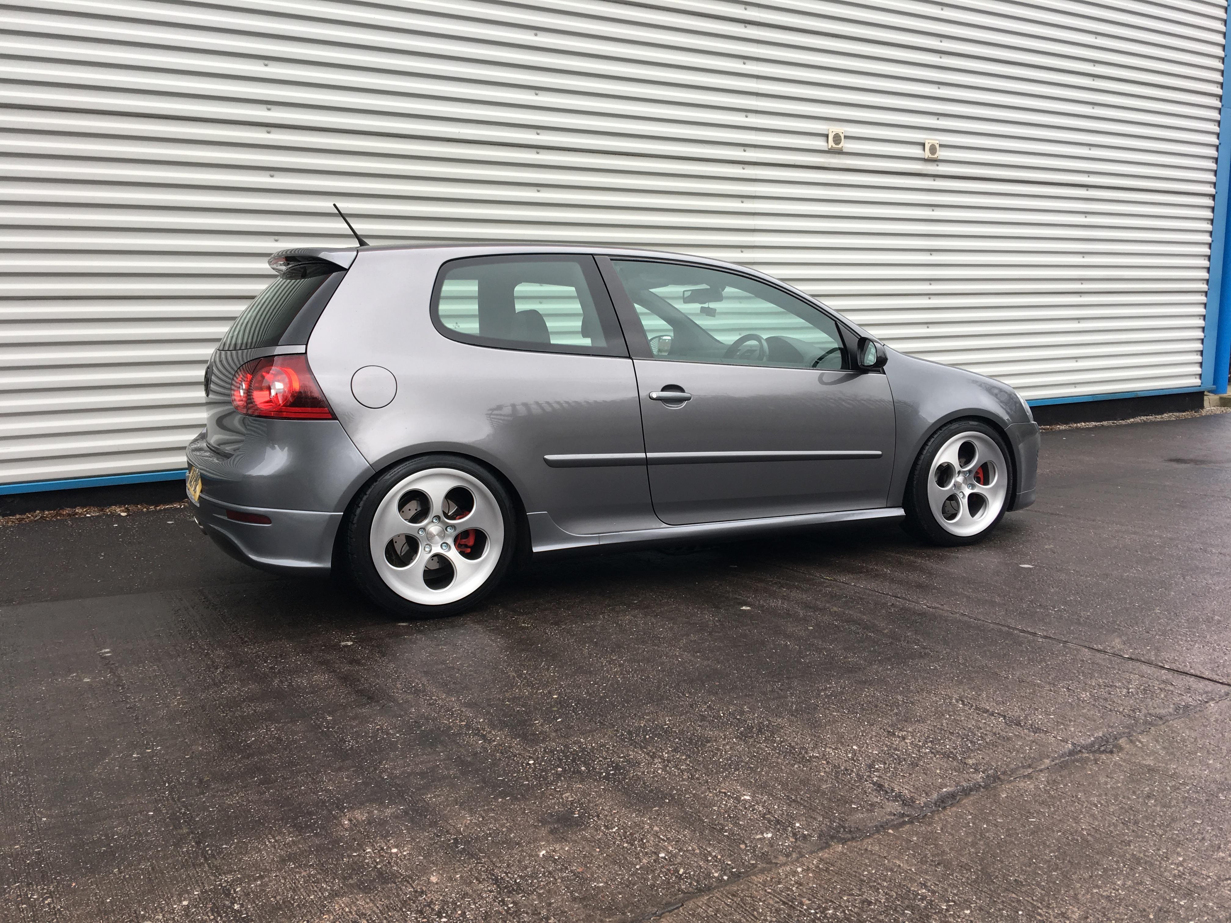

MOT was sorted and shocks were a bit tired as the original items. Decided to install a set of AP coilovers as not that bothered about going very low just wanted a little lower than the springs.
Replaced the mondial wheels as they were heavy and wanted something different. Ended up getting a set of bola b5 wheels in 18x8.5 et45 with 225/40/18 uniroyal rainsport 3. Need to roll the front arch's slightly but they fill the arch's a lot better.
Next job is Cambelt and water pump in a couple of weeks then start on the bodywork to get it all one colour and sort out the number of rust spots.
