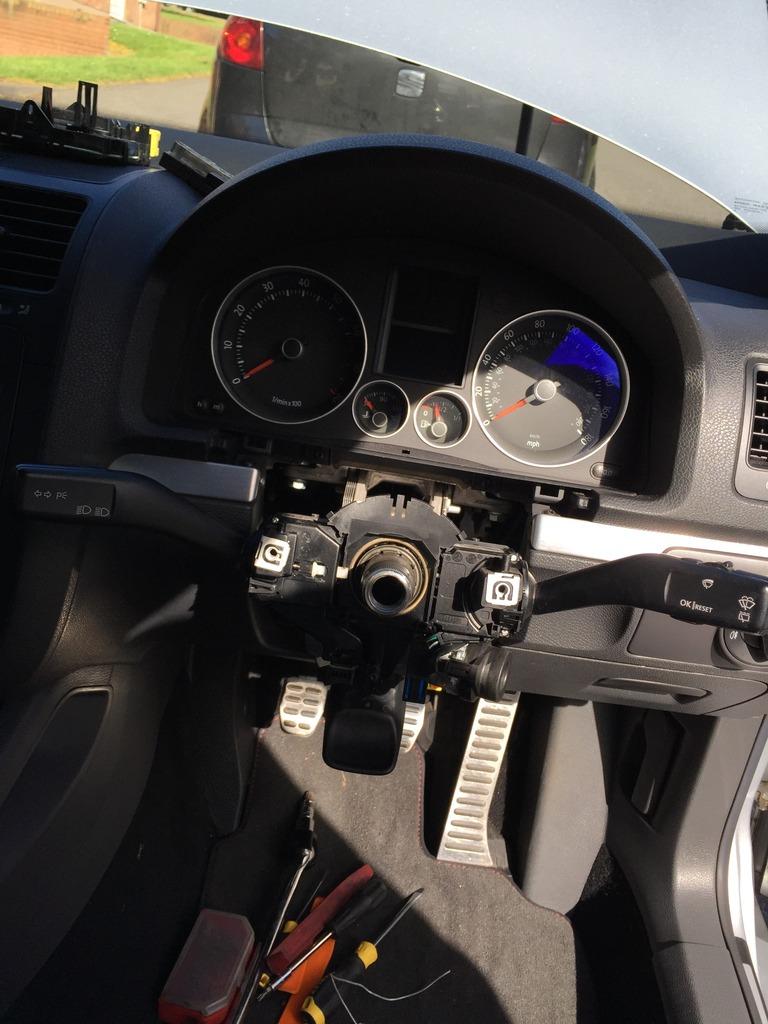

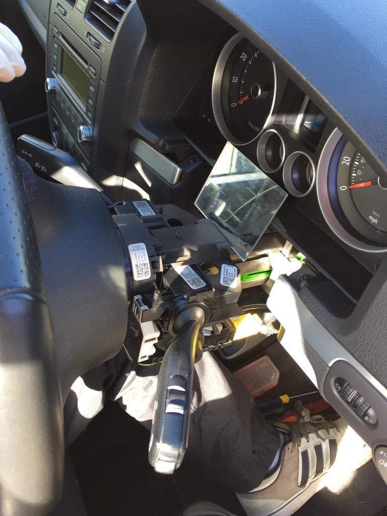

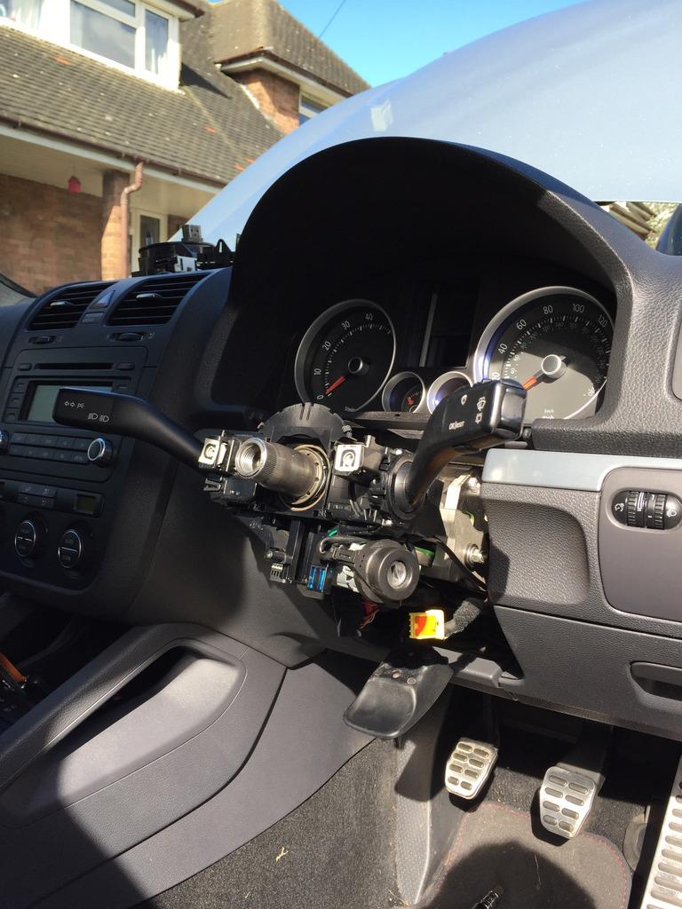

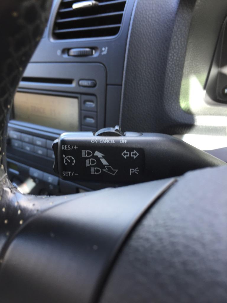

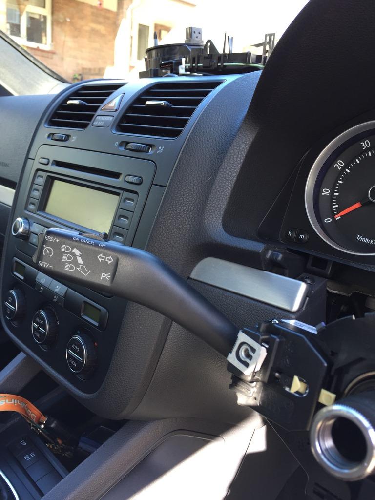

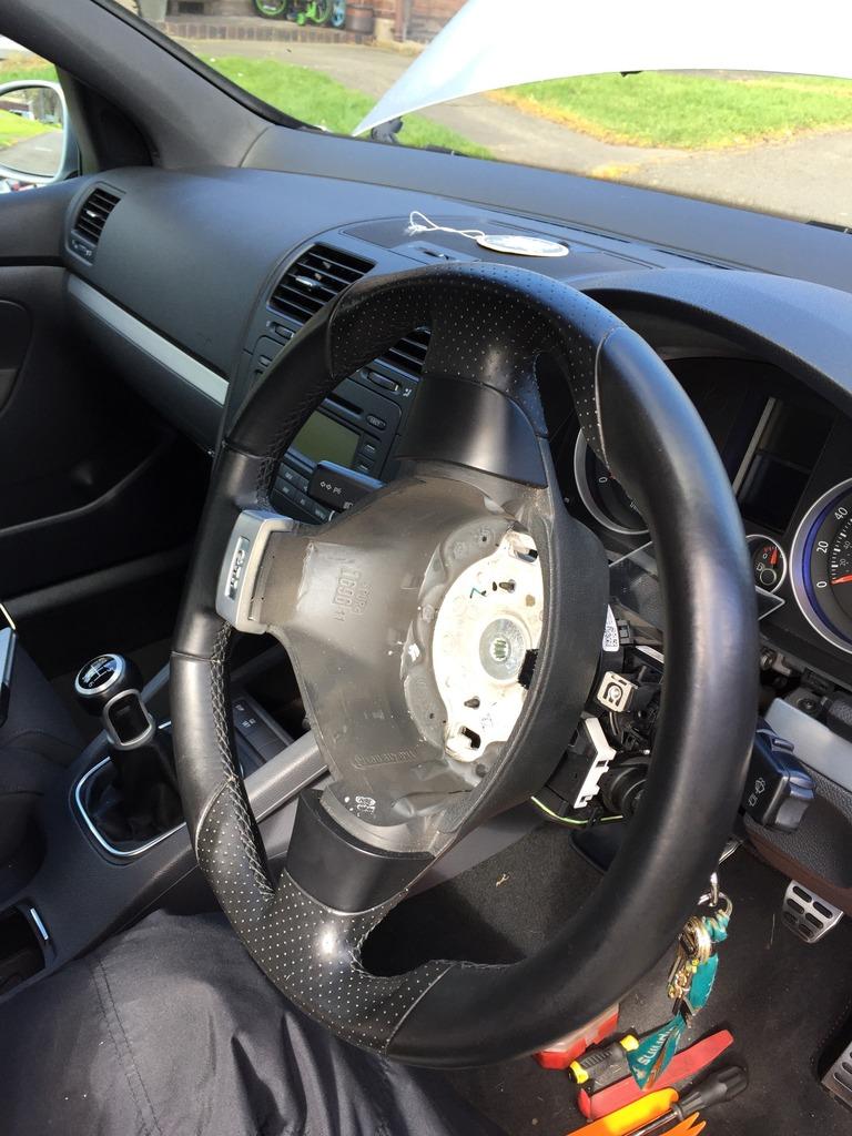

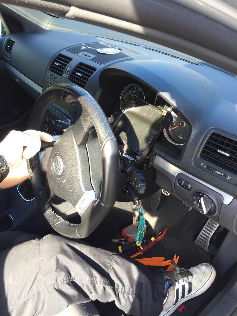

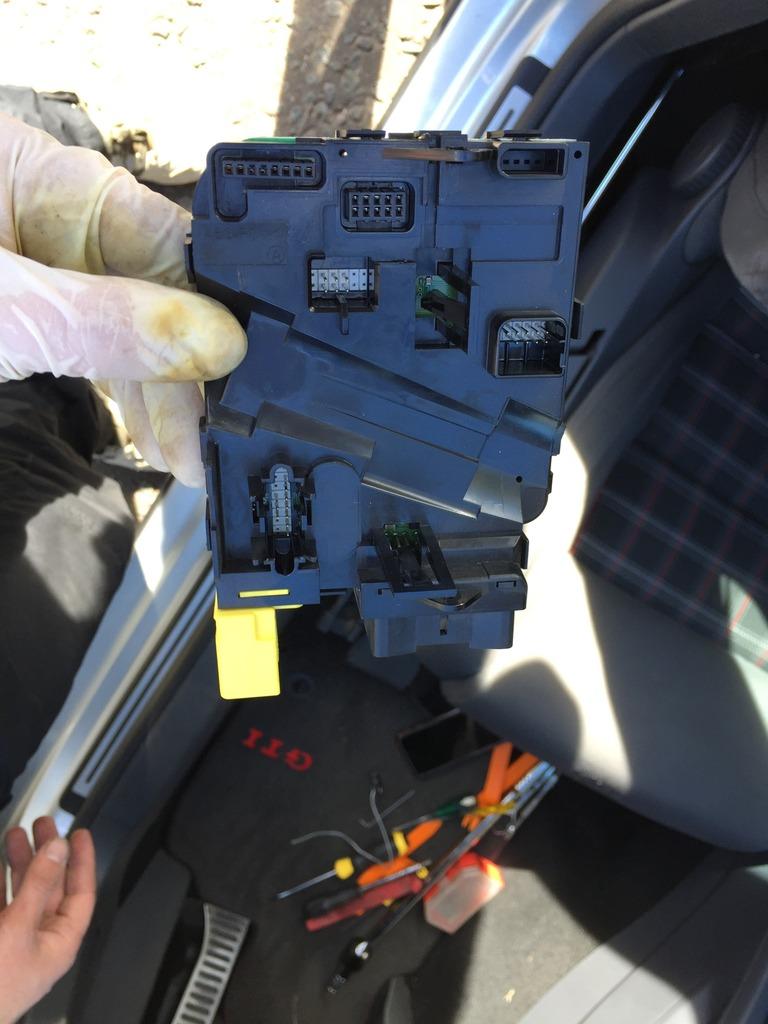

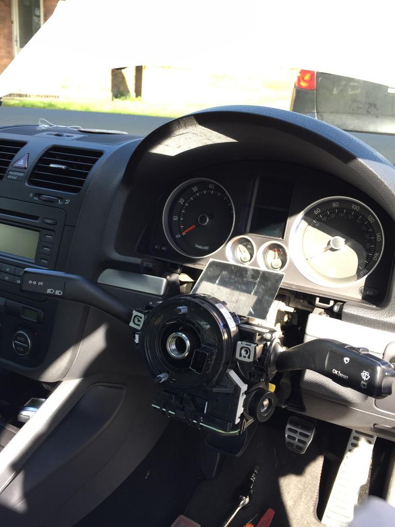

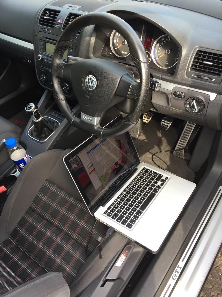

So today, I got round to meeting up with @Tfsi_Mike  to fit my cruise control stalk and to enable some features through VCDS.
Got the car connected

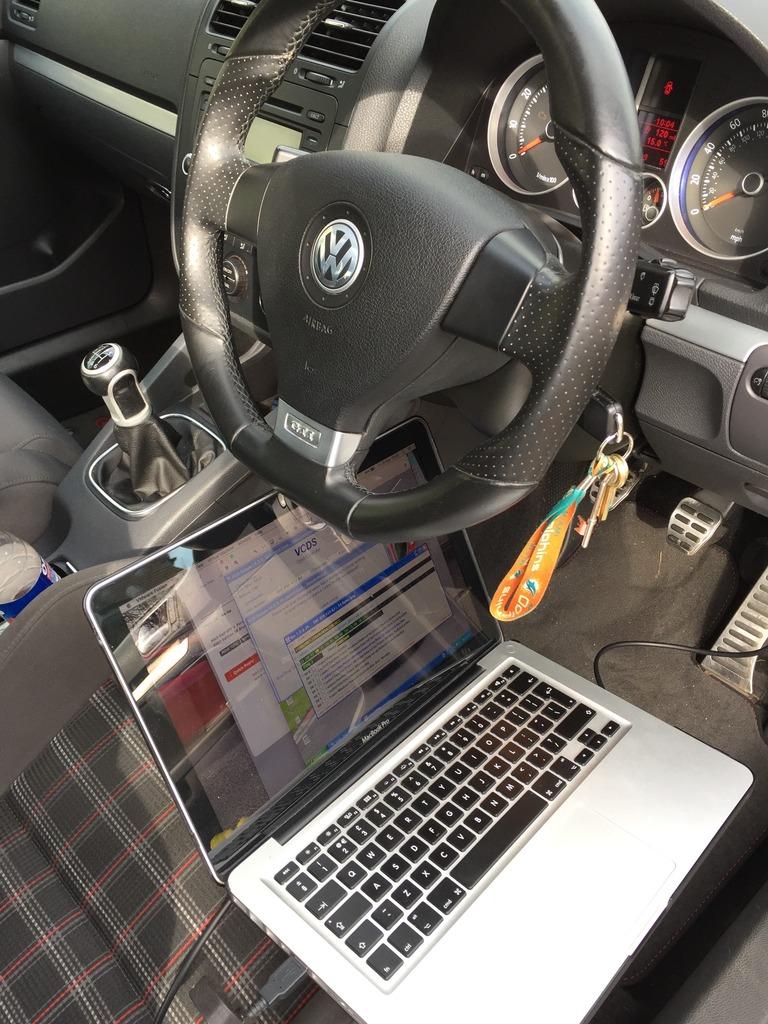

Quick scan of the car
Removing the cowling
Mirror used to help locate screws
Airbag off
Wheel off
Control module out
New stalk fitted
And finally fitted with everything back in place
I have also had the following coded;
Auto lock at 10mph
Boot pop via button on key
Remove passenger seatbelt chime (used to go off if you ever put something on it)
Service reminder reset
A massive thanks go out to @Tfsi_Mike for all the help today, even if it took us a bit longer with the bonnet :signLOL: Really nice guy and with a stunning car too :smiley: Really grateful for the help!

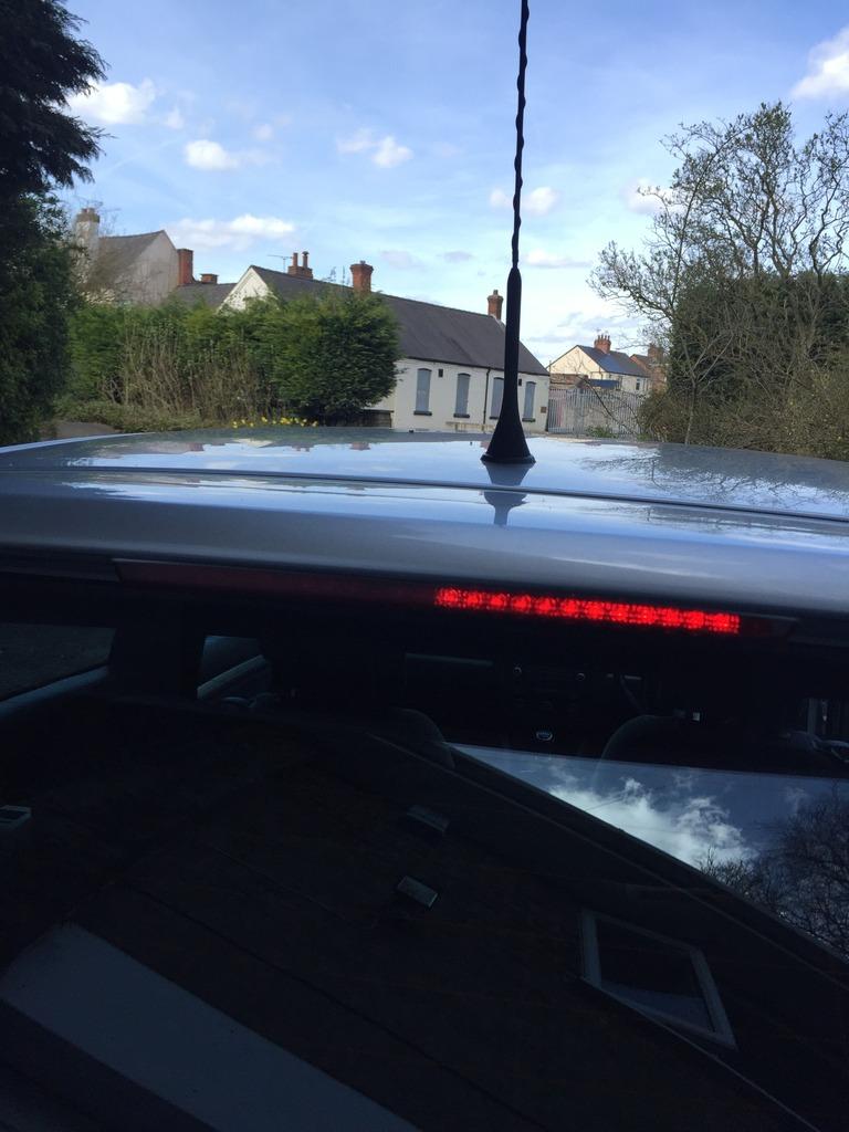

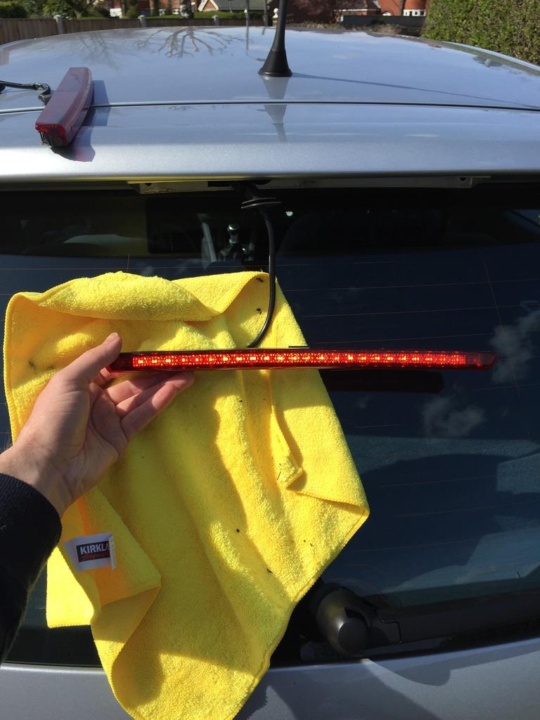

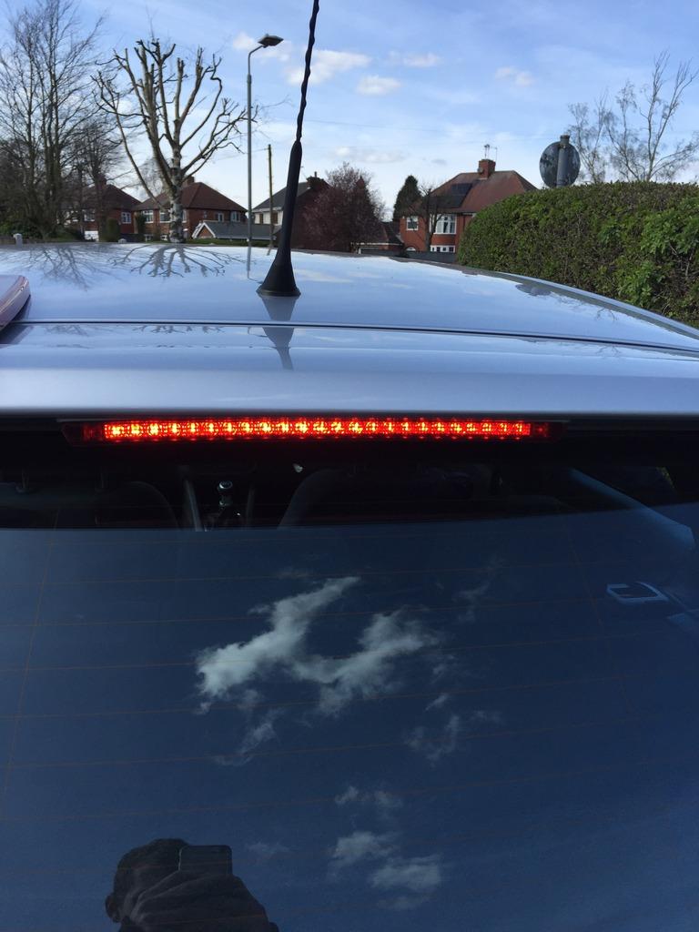

fair play. A lot of people don't tackle this job for fear that they'll crack the spoiler!
Offline r5gtt
  • -Given: 342
  • -Receive: 334
  • Posts: 5586
« Reply #10287 on: April 04, 2017, 11:25:21 am »
looks like you got the complete brake light out without breaking it into pieces?. Well done  :happy2:
Offline JamieKirk95
  • Posts: 120
« Reply #10288 on: April 04, 2017, 04:44:14 pm »
[/quote]
Thank you, yeah I was surprised to be fair, we drilled one hole and then a screwdriver in the hole and popped it out! Took 20 minutes or so so could have been a lot worse! Theres some more pictures on my project thread :happy2:
Offline JamieKirk95
  • Posts: 120
« Reply #10289 on: April 04, 2017, 07:47:12 pm »
Noworries thanks, I knew it could be done without snapping the poop out of it and more over can be done without breaking or drilling it too as I've got one from a gti used and undamaged sitting at home waiting biding it's time  :signLOL:
Cheers will check tour thread out  :grin:
[/quote]
Sorry mate I think you missed the bit about me using a drill :scared: Either way it's a doable job if you ever need it doing :happy2:
