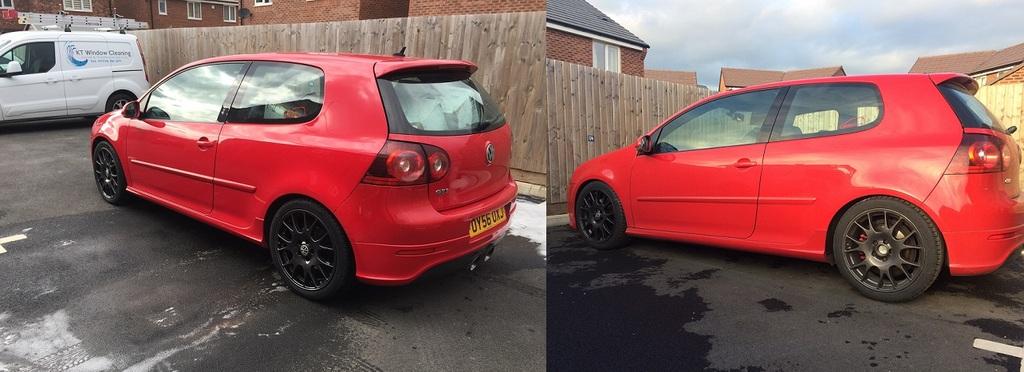

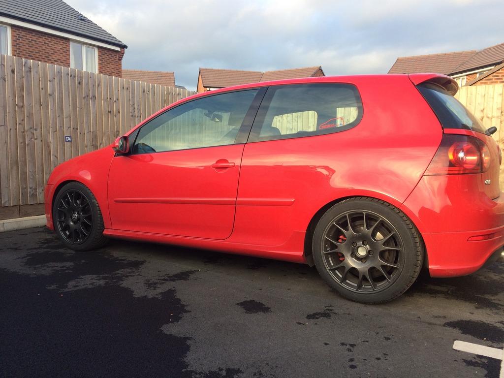

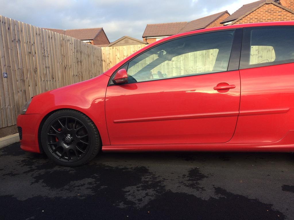

DSG service and H&R springs finally fitted

Lights also changed  :driver:
nice drop  :smiley:

Cheers mate,
yes the last few weeks have been busy with skyline ED30 rear lights back on, new genuine pescaras with Rainsport 3's and finally my H&R springs  :happy2:
Now need a rest me thinks for a while  :grin:

@irish_ram you've done well mate  :happy2:
looks nice too.
