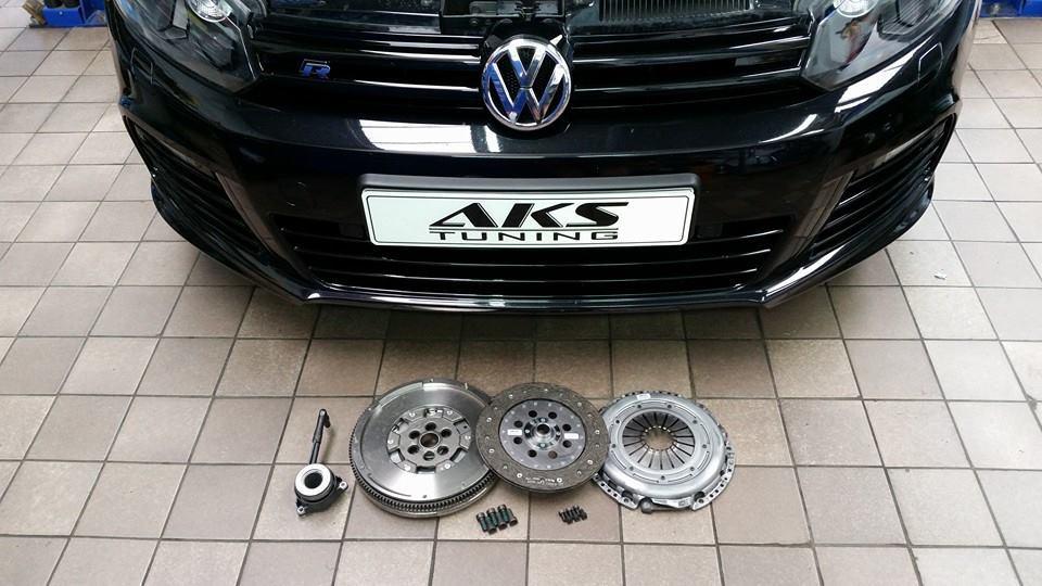

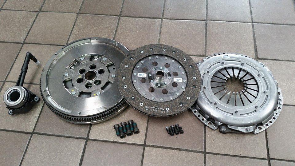

Took the car down to Alex's last week to get the clutch changed as the standard one was slipping now it has been mapped. All sorted within a day, dropped off Friday afternoon and picked up Saturday afternoon. Went for a Helix Organic one as although its not a daily driver, I still wanted a reasonable pedal feel and should handle the power ok. Have been running it in over the last few days and so far so good, pretty much used to it now. Can feel the difference a new flywheel makes too even though the old one was still within VW spec.
Few pics from AKS facebook:
Next of the agenda is brakes, not sure whether to go TTRS or 8 pots? Want to get a few track days and a ring trip in later on in the year and wondering if 8 pots will have too much front bias without upgrading the rears as well. And if they will clear 18" wheels?

Joms6r how's the clutch I'm going to stage 2+ soon and I want a helix clutch any good ?
Modded Golf gti CDL engine TTE420 turbo
Rtech 440bhp 429ftlb
Offline joms6r
  • Posts: 110
  • My Ride: Golf 6R
Re: My Mk6 Golf R!
« Reply #52 on: June 25, 2015, 04:57:10 pm »
I'm still running it in at the min so taking it fairly easy. The pedal is firmer that standard but still usable, I drive a transit daily so doesn't really bother me and pretty much used to it now already. The engagement of the clutch does feel a lot better and less sloppy than the old one, I'm guessing the new flywheel is helping that a lot. Would recommend it so far  :happy2:

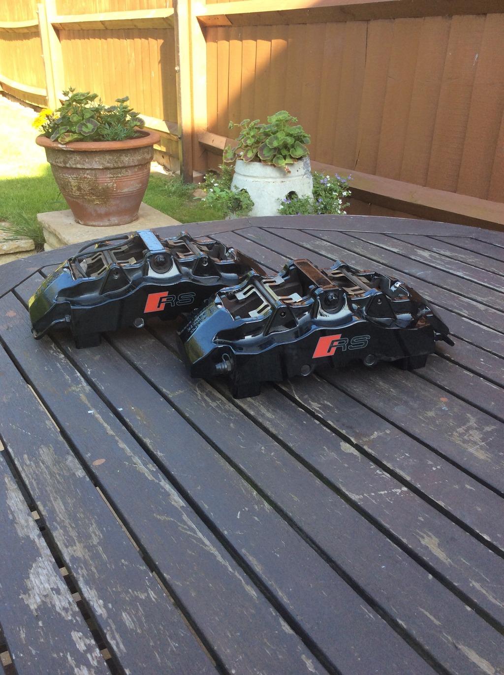

Now onto the next stage of mods, brakes. Was initially going to go a set of TTRS calipers as i'm sure these would be more than up to the job, however came across a set of 8 pots at a decent price. Always deepdown wanted a set of 8 pots even though I knew they were complete overkill and will probably need an uprated master cylinder I snapped them up. So just need to complete the puzzle now and pick some DaveB 362mm disc's and brackets up from Alex, as well as possibly a colour change for the calipers. Thanks to Hurdy for the info, will also probably upgrade the rear disc's as well to help the brake balance.
Brake p0rn  :laugh:

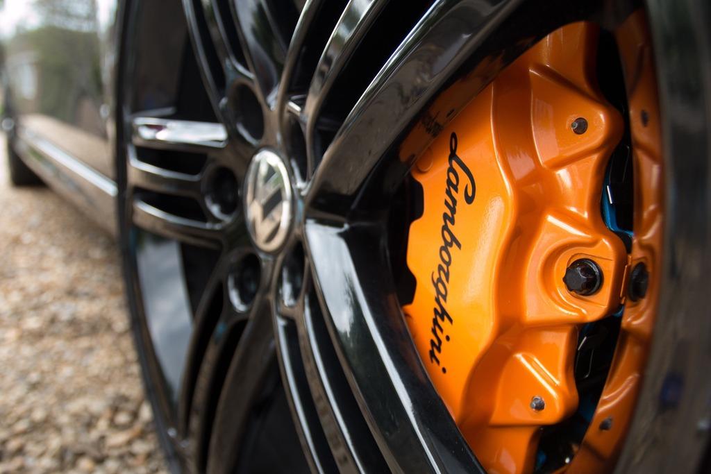

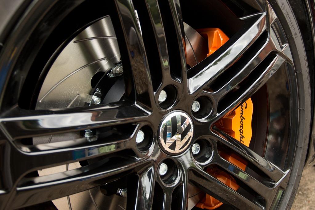

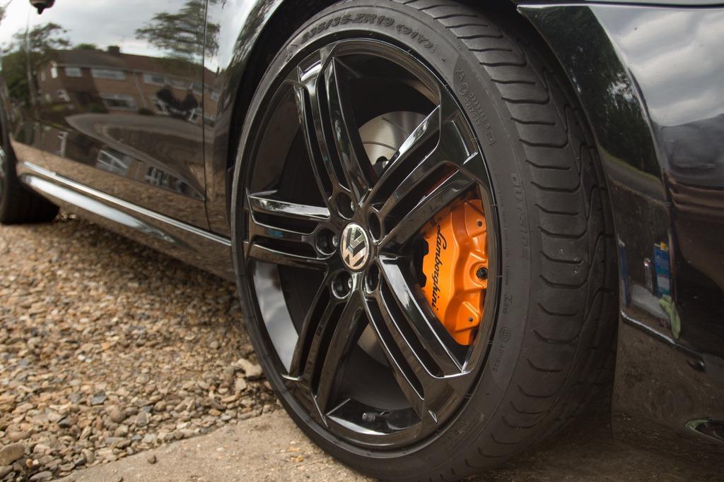

Thought it's about time to update this now the brakes are on:
Full spec as follows:
Lamborghini/RS4/R8 8 pot Brembo calipers painted in Arancio Borealis.
AKS supplied DaveB kit with 362mm floating AP discs, custom lines and carriers.
Pagid RS4-2 blue pads
H&R hubsentric spacer on standard 19" wheel
Initially hoped I could get away with a 5mm spacer but had an emergency trip to Alex's mid job to swap for an 8mm one as it was just too tight.
Was planning to upgrade to a TTRS master cylinder but I'll see how it goes with the standard one after they've fully bedded in, doesn't feel to bad at the min. Still using the standard rear setup too but was speaking to @hurdy at inters about using stock calipers with bigger discs.
Loving them already, can't wait to start pushing them once the pads and discs have fully bedded in  :jumping:

They look menacing!  :happy2:
Love how good the orange caliper goes in contrast with the wheels.
